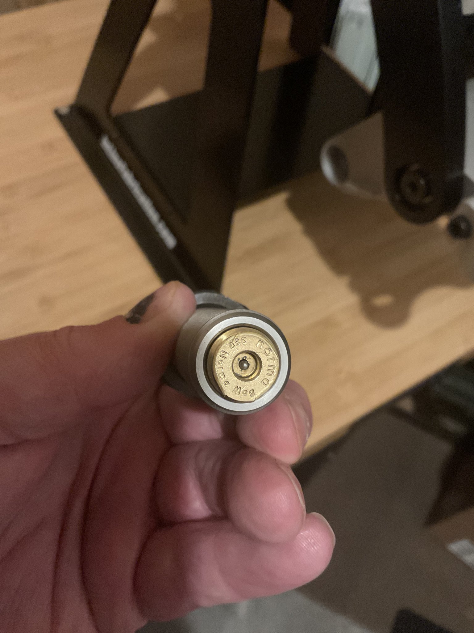

Ok. So I am literally on my 10th case of my reloading career. I have some once fired 338 Norma Mag brass from Norma. I had previously deprimed and cleaned the brass. I started out by spraying the cases with lube and started full length sizing. On the 10th case, I ran the brass into the sizing die, but when I tried to extract, the case holder ripped the cartridge rim completely off. So, the rimless cartridge is stuck in the die. I am hoping this isn’t a common occurrence. Any help on what I should do to get the case out?

Thanks all. Just the rim. I must have went with too little lube subconsciously in honor of tax day.
By the way, RCBS die.

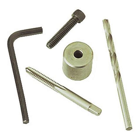

I’d get the rcbs stuck case remover shown above. Easy to use and something you should have on hand anyways. Easy enough to make but only $20 if you choose to buy

Can anyone comment on the difference between the RCBS Stuck Case Remover (https://www.midwayusa.com/product/1011809648?pid=504741) and the Stuck Case Remover 2 (https://www.midwayusa.com/product/1011923380?pid=605425).
Thinking it'll be good insurance if this happens.
The 2 has the hex nut to help get the decapping guts out of the die and then you hammer the empty brass out with the rod.
The normal has you tap and thread the case head itself and use the bolt to torque the case out of the die.
Two different products to push the case out or to pull it out.
Is it fair to say they solve two different problems, for example #1 does not work if you rip off the base of the case? #2 is only $8 it seems owning both is easy.
They solve the same problem, just from opposite ends of the case.
