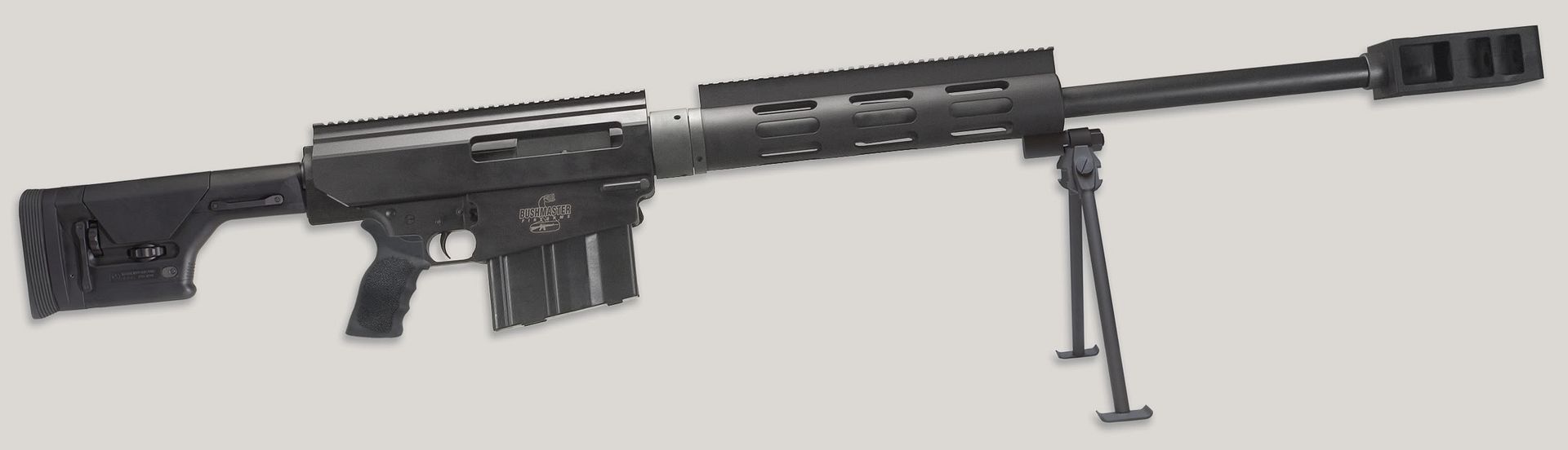

Hello!
I am new here and i have a ton of questions. I hope that none of you mind going over the basics.
First off, the rifle:
It is a Bushmaster BA 50.
I am looking for optics that will get me out to 2500 yards and anywhere in between. I will be using this rifle for long range target/competition shooting. Most importantly, i will be using this rifle to compete with a good friend of mine who owns a .375 SnipeTac.
