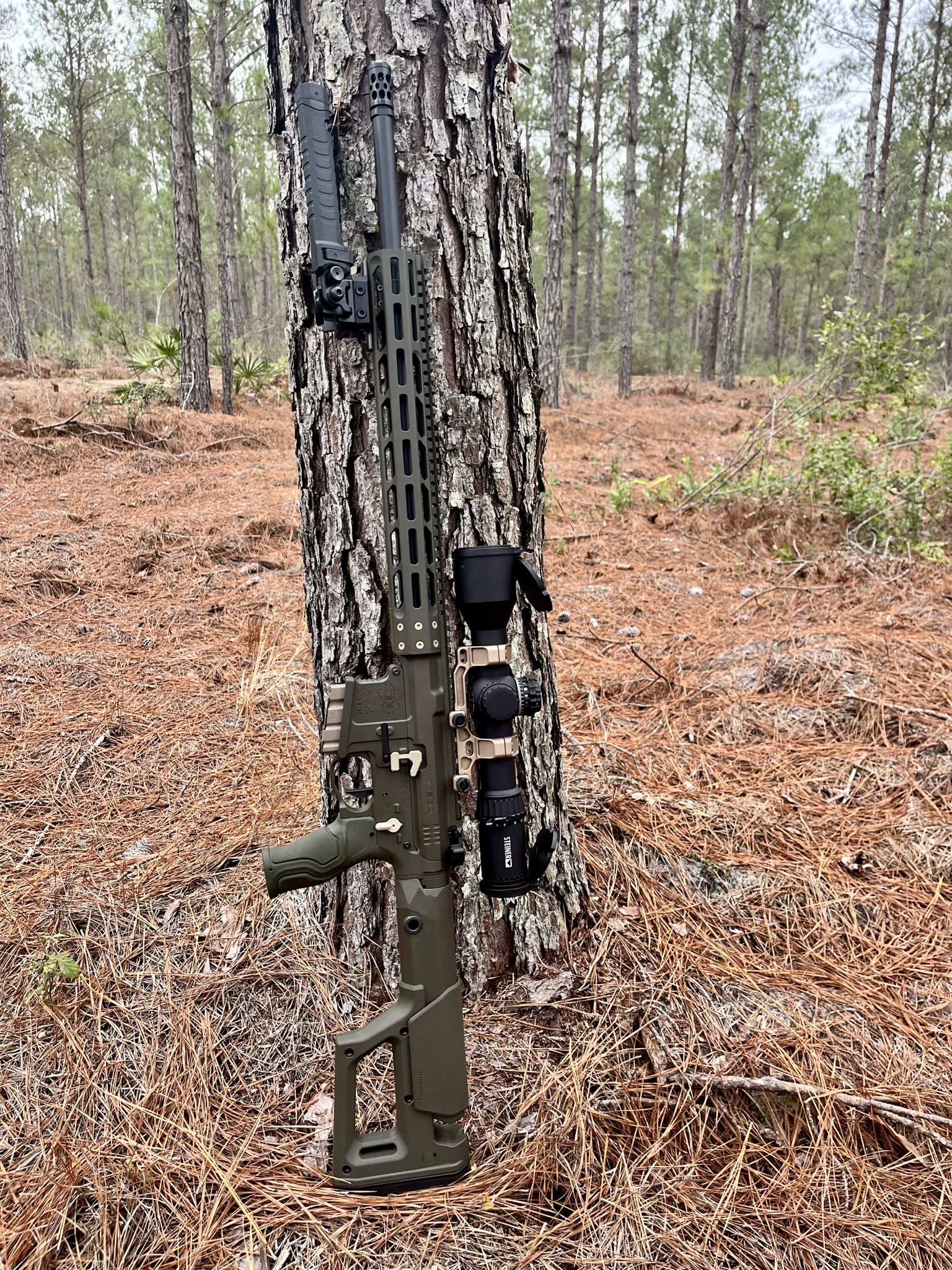

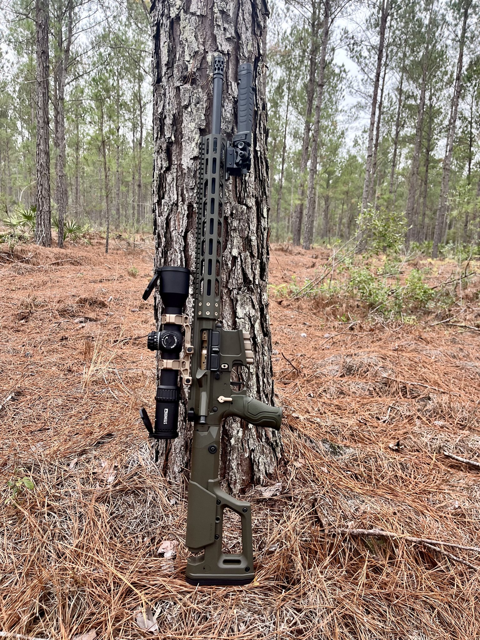

Upper is a little bit of a Frankenbuild since I changed parts one at a time. It’s a LH Stag with their standard LH bolt, white oak recce 16” barrel, PRI did the SPR riser and handguard, seekins adjustable gas, Dead Air flash hider under the Sandman.
Consistent 3/4 moa groups are doable, with a lot of focus. The AR is just so much more squirrelly in my hands and the trigger (despite being the best available 2 stage geisselle) is such a step back from the Triggertech in my bolt guns. I have to really focus on follow through and returning the gun fully to the exact same position before firing the next shot.
When I just blast away as I am known to do, groups open up to 1.25 MOA or so. Still good to pound a mini IPSC at 400 and a 10” gong at 600.
I do think you could wring out a little more with better load development (I just seated SMKs at mag length and ran a 3 or 4 charge ladder) and a Lilja or CLE barrel. Big diminishing returns on ARs and I’m delighted with the accuracy I get.

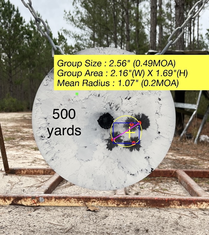

I have a 16” Douglas barrel cut by CLE on a spr build that is extremely accurate as well. You will not be disappointed with a Douglas barrel’s accuracy.
This group is with quality 77smk loads of course.
