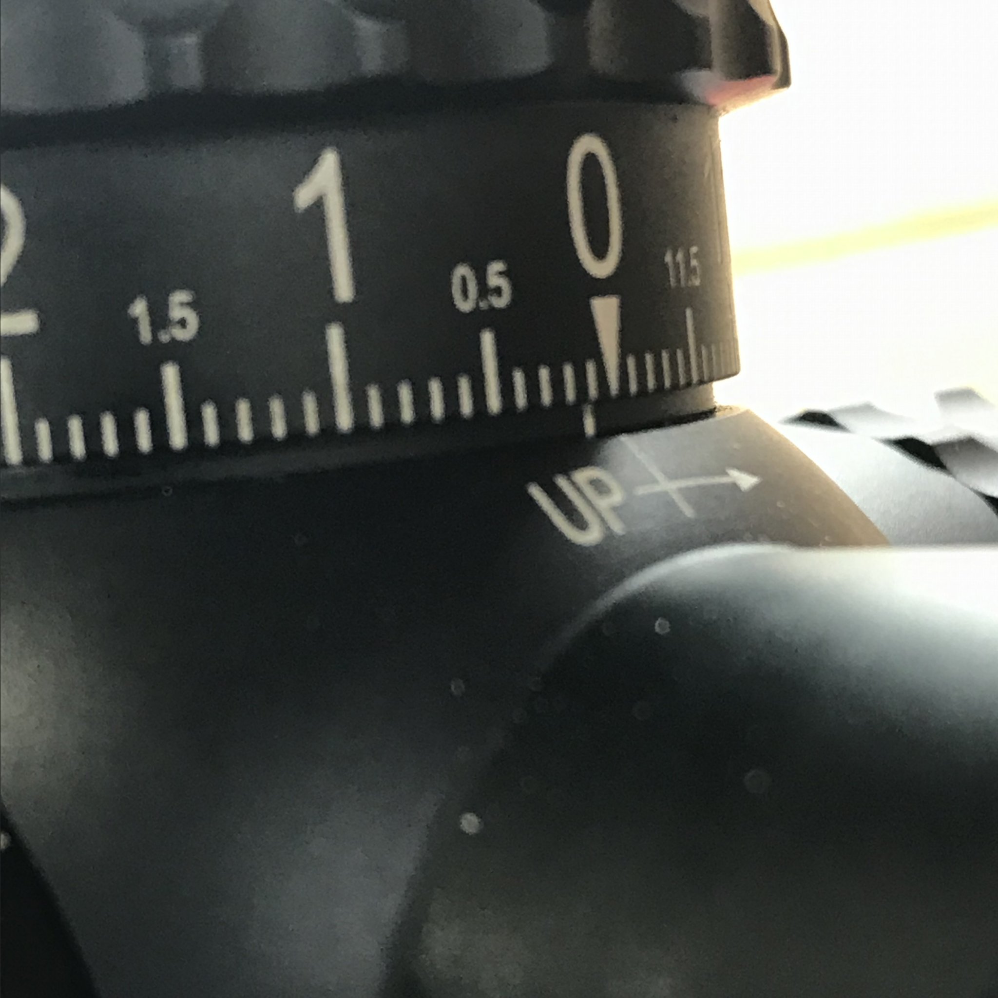

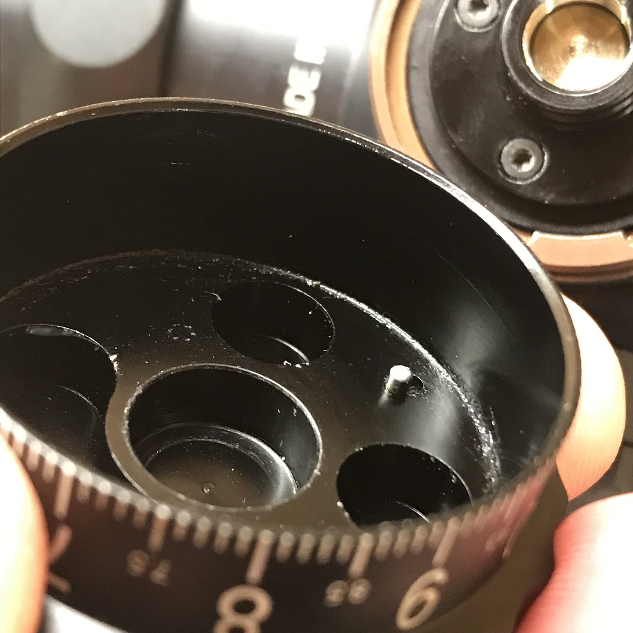

I went to reset zero on my ATACR F1 4-16x42 and decided for whatever reason to look at the manual. Instead of simply resetting the turret (which I had done in the past), it has me removing the turret and setting the clamp wheel (similar to other Nightforce scopes) as well as dialing 2 mils below zero multiple times. I've posted pictures below but basically I stopped at step 2. Turret stops and locks on "0" as it should and allows me to dial 2 mils below zero as well. All mechanisms allowing me to do this are in the locking turret and scope body.
I do not see the need for the clamp wheel at all. I understand other NF scopes use the clamp wheel as the zero stop but it seems completely redundant with the locking turret. For those more familiar with this scope, am I missing something here? I could probably use the clamp wheel as a second zero stop but don't see the point. Am I missing something by not doing steps 3-7? FWIW, I only did steps 1-2 the first time I set zero and have been using it this way for the last year. Basically I pass function test and test in step 8 while skipping 3-7.

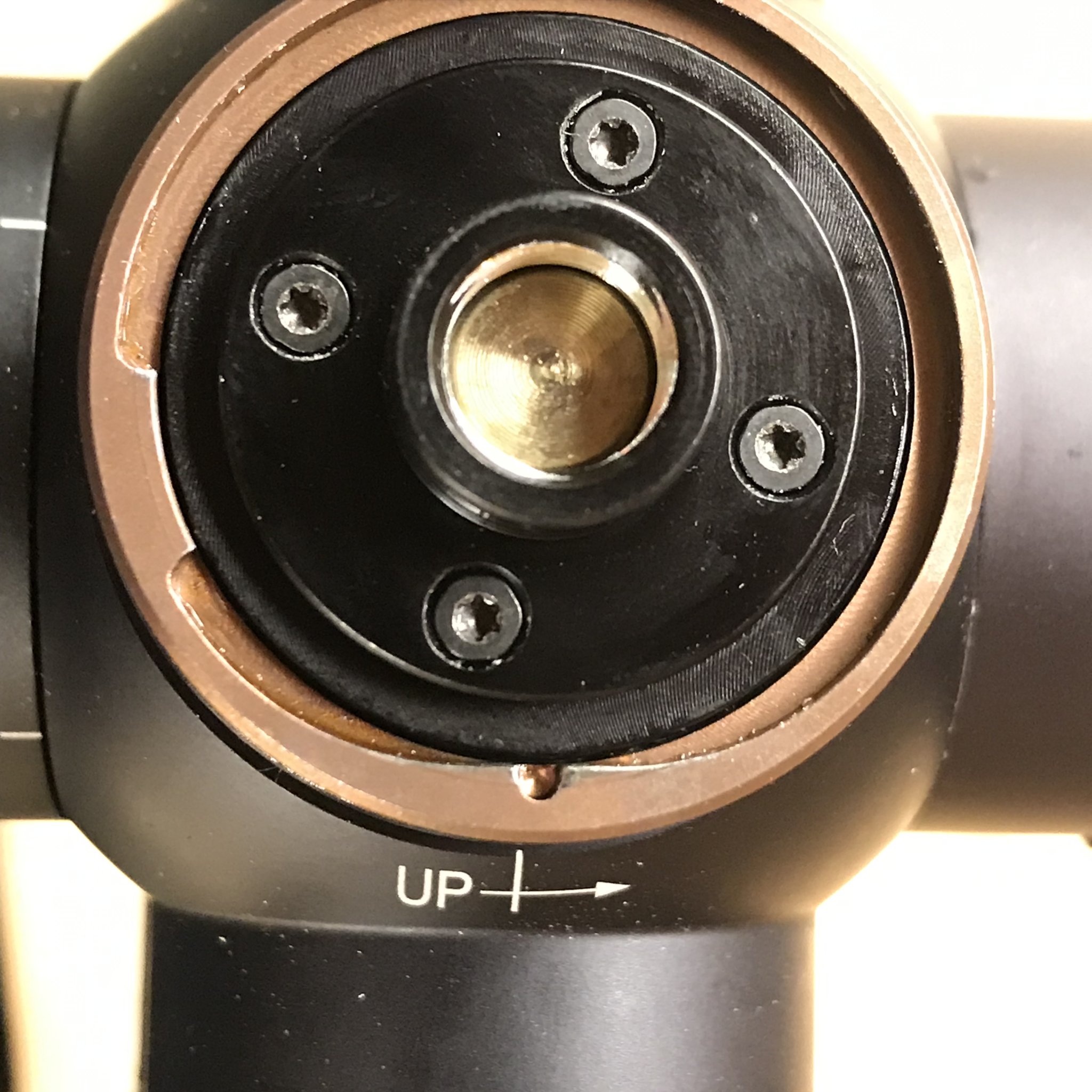

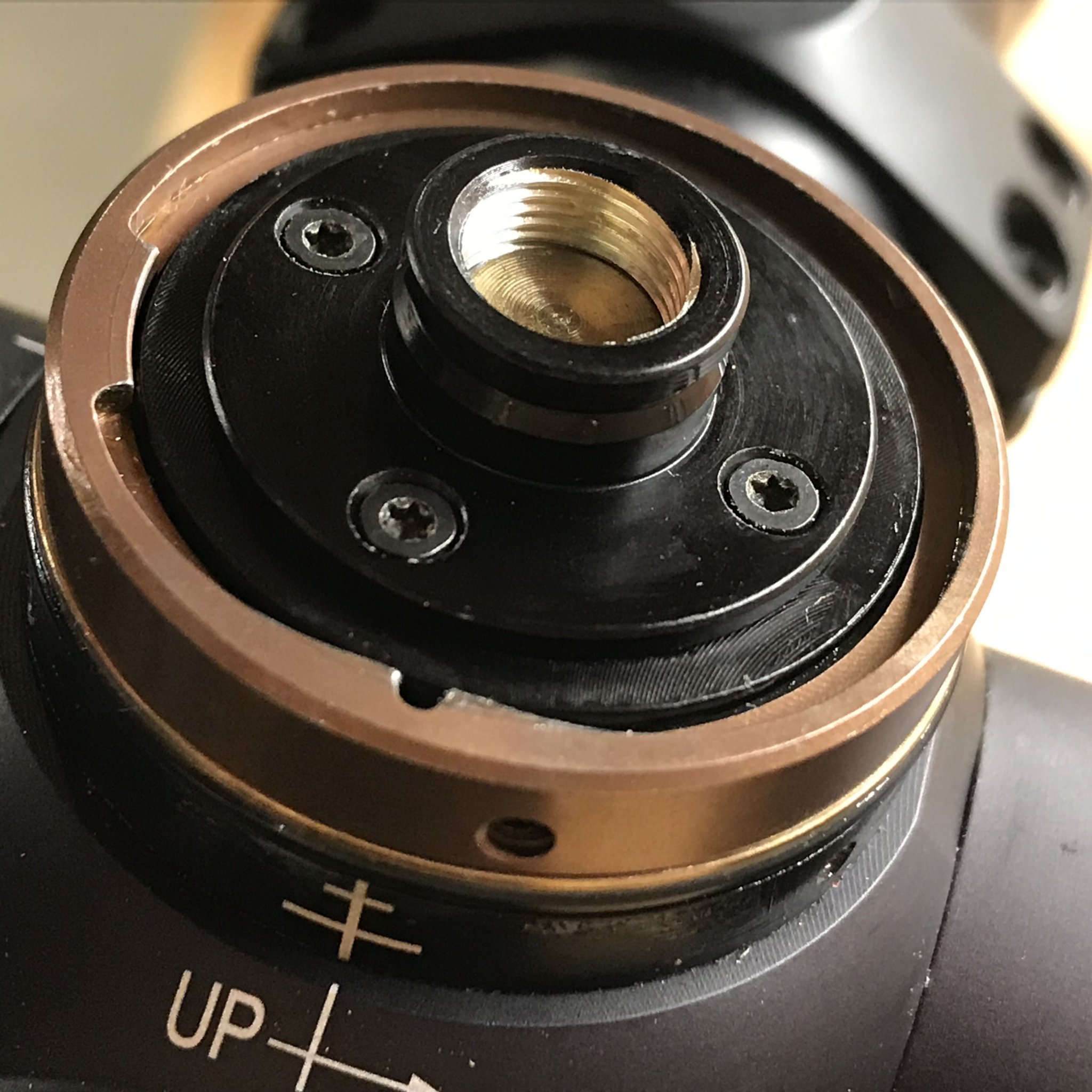

If you don’t lower that black clamp, you may have issues with the lock not locking properly bc the turret is sitting too high up for the locking pin to fully seat in the locking slot. I have this issue with my tikka using a 20 moa base right now.
Spinning the turret back to zero, the turret resistance would get heavier at .7 mil. You see that’s about where the locking slot starts to form on the turret body. And when the turret was “locked” it could still be turned out of the locked position with little extra force because the pin wasn’t sitting all the way down into the locking slot.
