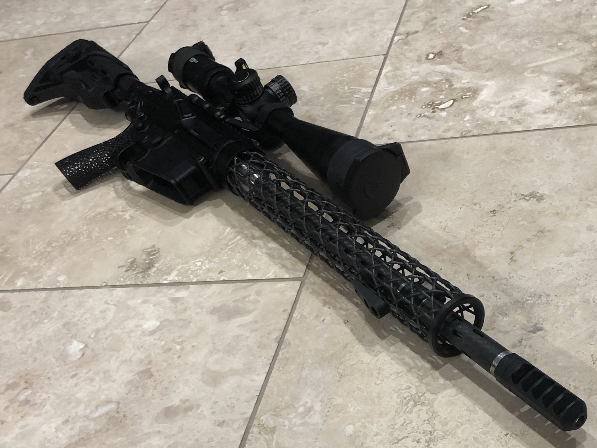

I have built a Light weight (mostly carbon fiber) Lr308 or ar 10 that is 6.6 lbs. and if possible I'd like to keep it light. I will use it mostly for hunting but it will also be my gateway into target shooting and later competitive shooting. I’m coming from a 5-25 pst gen2 which was just ok but what I really didn’t like was I really missed my lower magnification. So I’ve decided on either the NF 2.5-20 (I’m banking on a sfp announcement Monday at SHOT SHOW), Zeiss v8 2.8-20, the swaro 3.5-28 and the s&b 3-20 or exos 3-21. I really don’t want a 3-18. I understand the short comings with this Erector type setup that usually only money fixes and that no scope is perfect. However I like being able to quickly acquire a target in the field as well as being able to reach out and touch it. Now I know everything has better glass than the NF but that isn’t the concern, my concern are things like durability (if crap happens like it falls off the tailgate while I’m setting up will the scope still be ok.) , repeatable (will the scope hold it’s zero after spending a day on a 4
Wheeler on a washboard road), eyebox (How easy is it to get on target), field of view, and reticle that doesn’t disappear in the trees without illumination and customer service . I also prefer sfp as I hunt in the timber and would prefer to dial long distance anyway. A few questions of money is no option which of those are you choosing and is twice the price for what I am doing worth it ? Is the Eyebox really that bad on the NF?
