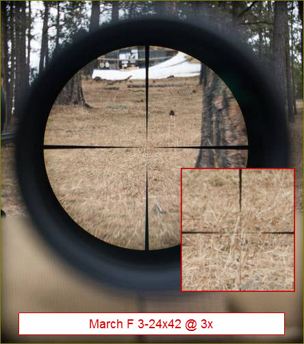

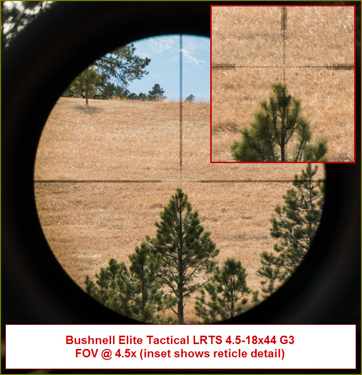

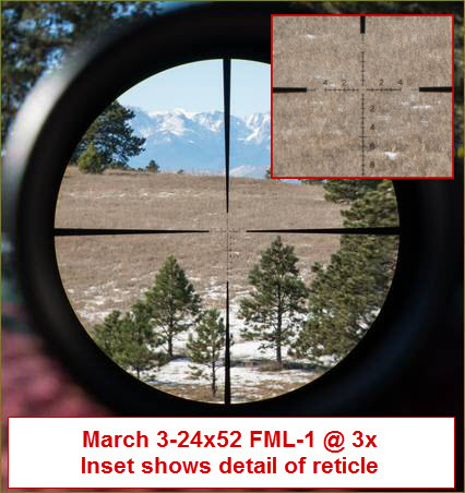

Do you guys with the Bushys like the ret on the lowest power? Is it useable? I am currently looking for. 2nd focal plain hunting scope. I bought a march for the size but it was awful in low light and the ret just got too small for me.

I don't personally mind the size of it at 4.5x during the day. If you have any plan to shoot it on 4.5x i suggest getting it illuminated so it's not a worry in low light

I've had the March 3-24x42 in MOA and the March 3-24x52 in Mil and liked the MOA reticle a bit better for it's thickness at the top end (above 18x) but the FML-1 reticle was better at the bottom end (below 6x), it is a trade off between whether you want better low mag performance or high mag in regard to thickness. Here's a comparison of the different reticles at their lowest magnification:
