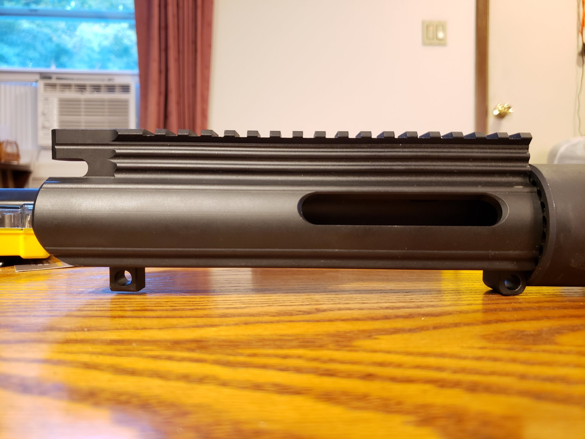

Was your LR308 a slick side with the 1/2" thick tongue-extra tall rail like in this pic? If it is, do you have any pics of it with the quad-rail handguard on it? I know it's an old post but I am trying to track down a monolithic handguard for my slick side upper and would like to see a pic of one with the quad rail.
