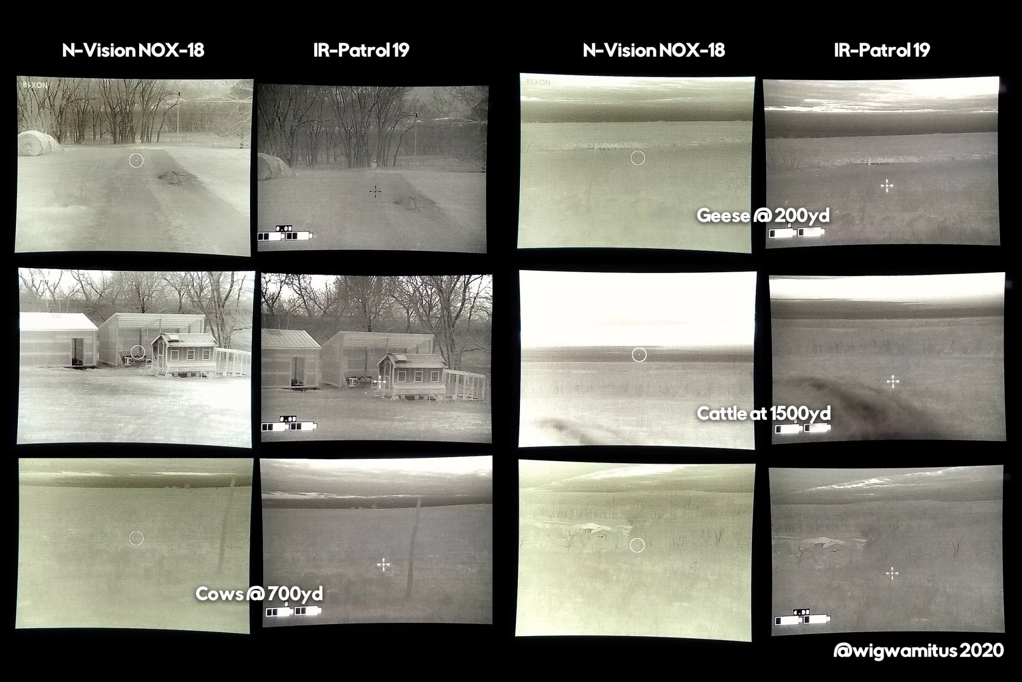

First setup in driveway to repeat some of last night's shots. And for those of you who are not aware, by clicking on the pics you can see them larger.
Nox
Patrol
Nox
Patrol
So, first, I still think the Nox brightness needs to come down a notch, but I was asked to not adjust the Nox settings for tonight, so I didn't.
I do think the Nox shows more detail, check the underside of the roof of the woodshed. Last night the Patrol had more detail there, but tonight the Nox did. But the Nox is more washed out, due to brightness being too high.
Then I packed up and headed across turtlecreek bridge and up signal hill to the top. I have a really crappy bale up there beside the one tree up there ... and if I stand between them, the critters don't detect me ... so for seeing a long way, its useful.
Nox
Cows at about 700yds
Patrol
I'd say the Nox wins here. Both of them detect, but the Nox sees them better
Nox
Snow geese in pond at 200yds
Patrol
Hum, I'd say the Patrol wins this one. Both detect, but the Patrol sees them better
Nox
Patrol
Probably the most important one, the Nox wins here ... the cattle at 1500-1600yds in the NE pasture. The Patrol barely detects ... you might not see them, but I know what to look for so I see them. Now the Nox is more washed out, due to too much brightness, but the Nox clearly detects these cattle better at about a mile.
Nox
Some of our buildings down the hill ...
Patrol
Pretty even.
Summary/results:
Well, night two. I think the pattern is starting to emerge than the Nox is detecting a tiny bit better. But, I'd say it is still too early for any definitive conclusion. More testing ! I've been nuc-ing them both twice before taking any pics. I could go for 5 nucs in 5mins as I normally do.
And I could try adjusting the focus more for both from shot to shot. And I think the Nox brightness needs to come down a notch. If conditions tomorrow are the same or worse, I might also try dialing the contrast up one notch on both. That will make things a little grainer, but should mitigate some of the washout of the terrain. Life is full of trade-offs.
If there are other spotting type testing people want to see, let me know.

I cropped in and threw your images on a grid, in case it's a little easier for folks to zoom in and see them side by side. Hope that was OK -
Thanks for that JW.
Wig, if you zoom in to fill the frame before taking pics, I think it would help being able to see detail a lot on this end.
I also agree that getting both of them to the best image quality possible is best, so if that means adjusting brightness or other settings beforehand, then that's what I'd do. You don't want to compare 1st string to 3rd string so to speak. You want the best of each going head to head.
Take all of this with a grain of salt. Just my two little pieces of copper. Regardless, thanks for doing this. I'm very interested in a nox. Actually thinking about the 35mm though tbh.

... Very interesting. It seems that GoPro and iPhone show quite different pictures. Even the hue is noticeably different and iPhone seems to considerably washout low contrast details ...
I'm most impressed with the way Jay can quickly and accurately refocus the Nox. No way I can do that. Not even close. It takes both hands to move the focus on mine one hand holding the Nox and one hand barely able to move the focus ring !!! Must be olde man hands :D :D :D
