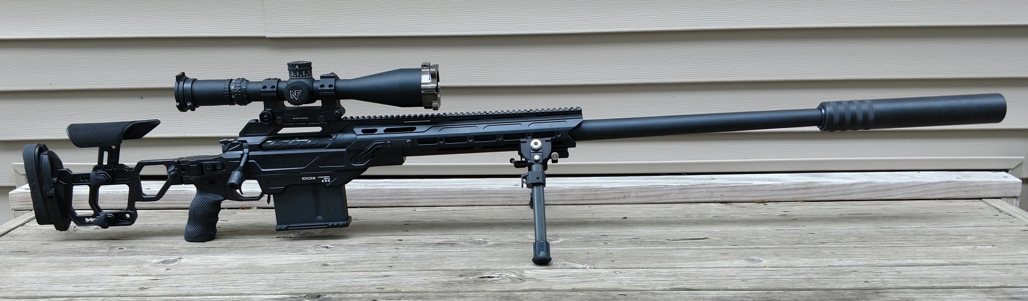

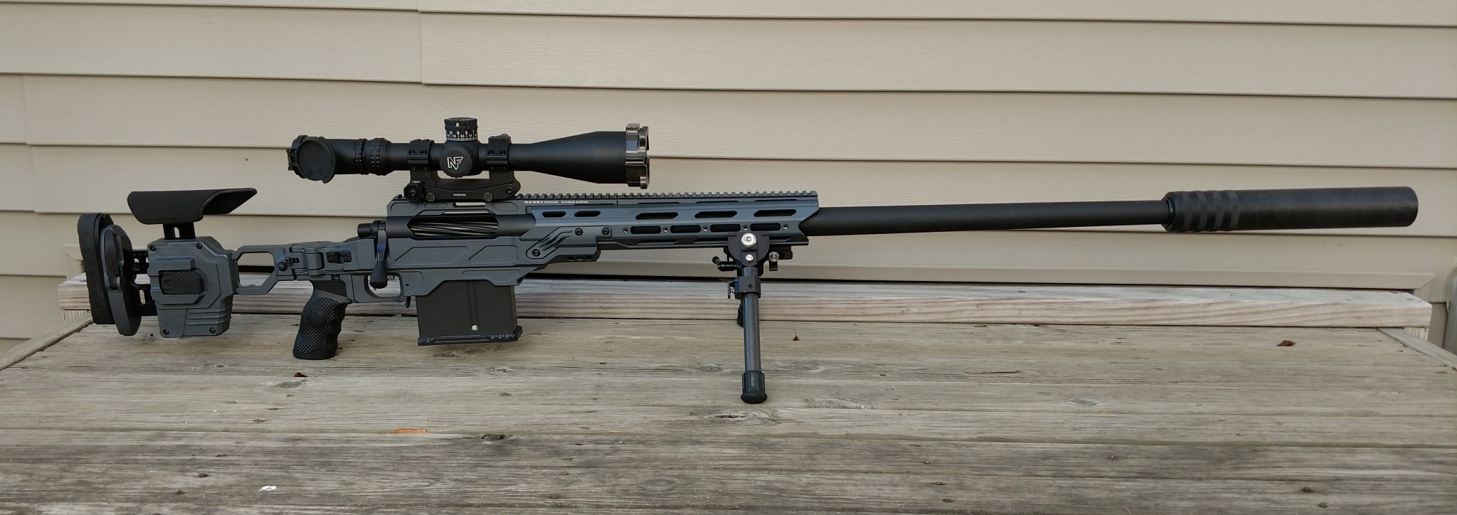

I've got two of them set up on 60 moa mounts and they both have 100 yard zeros. I have just over 35 mils of elevation adjustment set up this way.
I've got two of them set up on 60 moa mounts and they both have 100 yard zeros. I have just over 35 mils of elevation adjustment set up this way.View attachment 7137302
Will this be ok having it in the bottom or top 5% of elevation travel? I found a 9 mil that should get me my elevation without holding over.
I thought I read that on the forum to stay out of the top and bottom 5%. I might be wrong though.
Thanks
I haven't noticed any issues. I just finished shooting 150 rounds of 5 shot groups at 100 yards while fire forming my new brass.
