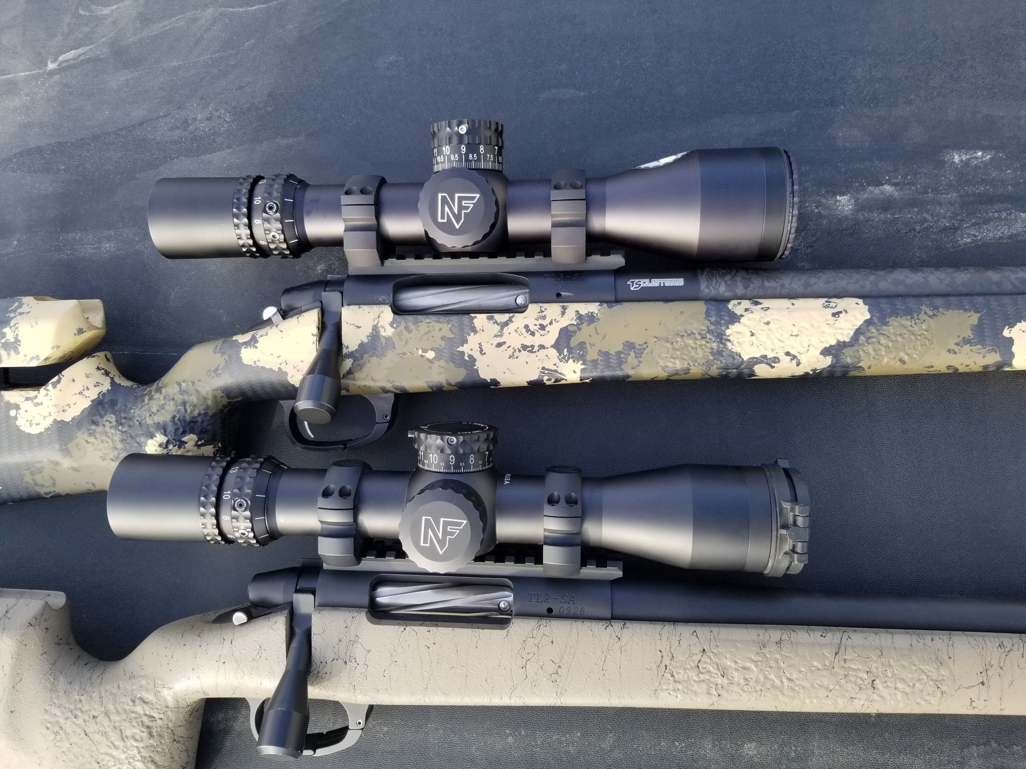

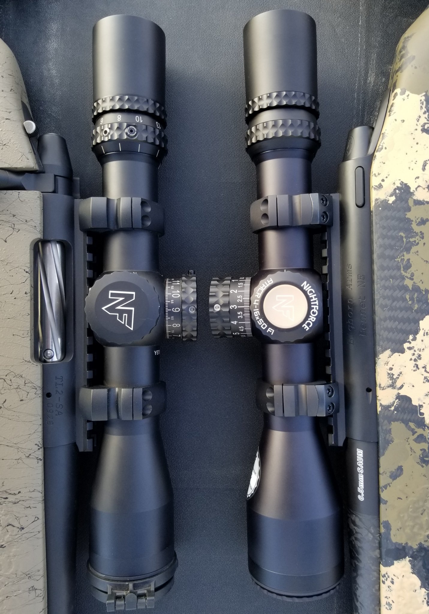

The x42 has low profile, locking turrets with pre-set stop of 2 full MILS under travel. So turret will "lock" on your set zero "0" and hard stop 2 MILS under zero as well. To get the turret to spin from "0" you need to depress the locking button.
The x50 has the standard ATACR target turret (taller, not as wide). Does not have zero "lock" but the turret can be setup to stop on zero or any number you choose below zero.
A few pics. Again, you are really splitting hairs but for me the 42x was and is a better package with the same performance as the 50x.

I like my 4-16x42 quite a bit, but sometimes I do wish I had the extra magnification. If cost wasn't a concern, I'd go with the 4-20, if it is, the 4-16 is a great scope. The one thing to keep in mind is the reticle thickness. I believe the 4-16 mil-r is .05, while most other reticles are .04. if you plan on spending a lot of time in between 4-10x, the extra thickness might be a benefit if you can live with the mil-r... Seems like most people hate it, but I don't think it's bad, especially for hunting.
