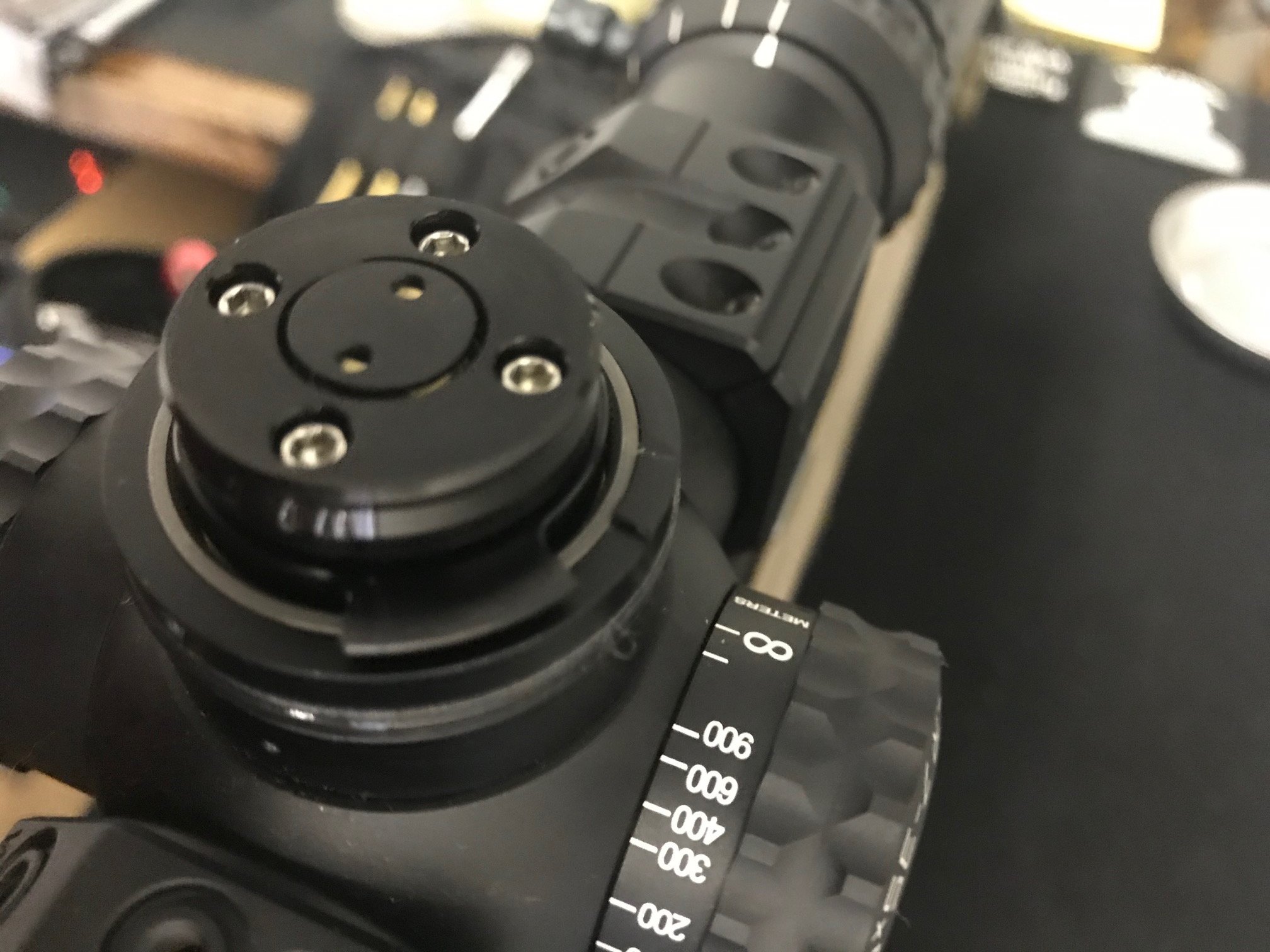

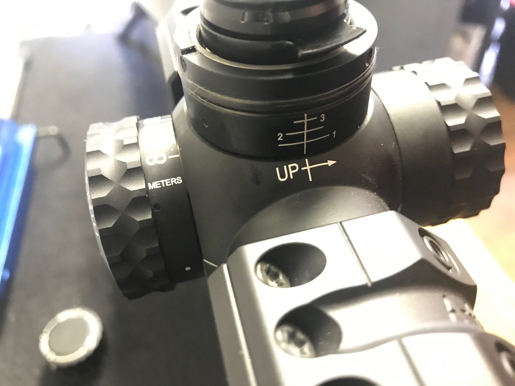

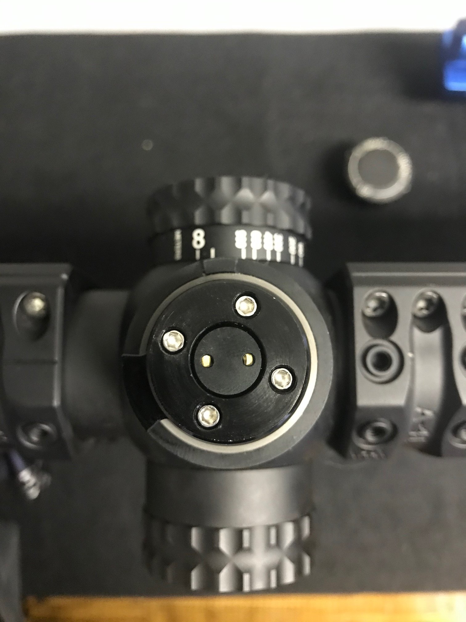

I've seen this problem posted in threads here before, but, no one has listed a solution other than sending their scope in to Nightforce. Checking to see if anyone has had any success solving this issue so I can avoid paying $100 to ship a 4 month old scope.
Model: Nightforce ATACR 7-35x54 F1 Mil XT
Problem: The ZeroStop clutch mechanism will only rotate about a 1/4 turn in either direction before it meets serious resistance. In the instructional video on Youtube, the Nightforce rep. is able to freely spin the upper clutch assembly down until it makes contact with the bottom clutch assembly.
Steps I have taken:
1. Removed the elevation turret cap by loosening the 2 screws 1-2 turns then gently pulling the cap up
2. Loosened the 4 screws on top of the ZeroStop clutch assembly 1-2 turns, being careful not to remove them completely
3. ZeroStop upper clutch assembly is not contacting lower clutch assembly and will only turn 1/4 turn in either direction
4. I have raised and lowered the elevation turret to ensure that I wasn't "bottoming" out on either end - I am not
Photo 1: top view of the upper clutch assembly turned as far as possible counter-clockwise
Photo 2: side view of photo 1 showing the space left between upper and lower assemblies
Photo 3: side view of upper clutch assembly turned as far as possible clockwise - showing space between upper and lower clutch assemblies
I'm fearful of forcing the clutch assembly and possibly breaking something - making an already bad situation worse. Any advice on how to remedy this issue is greatly appreciated.

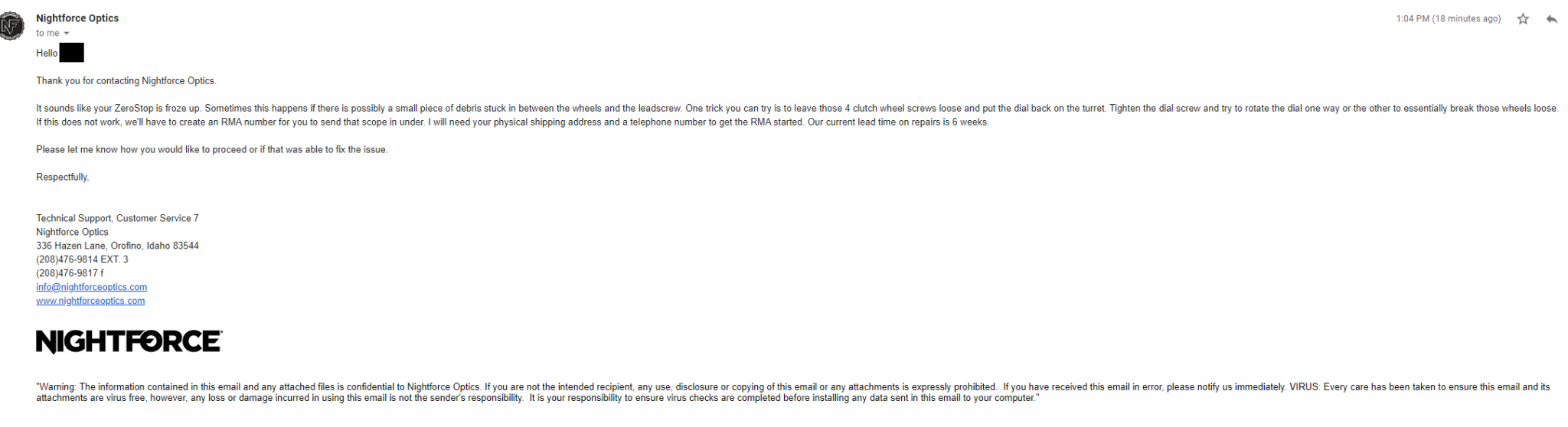

I'd email NF. They were very responsive with the questions I've had.
Done. Unfortunately I think the response is going to be send it in. Will post back when I have a reply.

any pics of the turret as you have it? Just to check did you torque down the 4 screws on the clutch and the 2 on the turret cap (while holding the cap down)?
I just bought an ATACR 7-35 and the retail store offered to bore sight it for me. They then offered to set the XeroStop for me. They came back 45 minutes later to say it didn't work. THey assumed they were doing something wrong despite following the manual and Youtube videos. At home, I followed the manual's instructions - pretty straight forward. The stop didn't work and there aren't any discernible clicks. Does anyone have any thoughts on what is wrong?
My NX8 did the exact same thing as yours from the sound of it right out the box. I ended up having to send it into Nightforce (on my dime). They quoted me 6 weeks to fix it, which honestly is fairly ridiculous for a brand new, very expensive optic. It seems they've been having this issue quite a bit lately for some reason. This happened last week just FYI. It would seem their QC isn't very good these days.
I can get some pics and post them in a bit. Yes, I torqued down the four set screws in the cross pattern as described in the manual as well as the two on the turret.

SUCCESS! The question about posting some pics caused me to think differently about the problem! Because I am a newbie I assume everyone else is more knowledgeable than I am. The retailer assured me with great confidence there was something wrong with the scope becasue he had been unsuccessful. I compounded the error by not have the dust cap compressed fully. Asking for the photo made me see that mistake. I just went back through the steps, compressed the turret cap completely and it works! The ZeroStop works and all the little clicks are there! My thanks to you folks for helping me through this problem!!! Now I am going to send NF another e-mail apologizing for being ignorant.
Reactions: TangoSierra916
THANK YOU!!!
While I was fumbling around trying to figure out what was wrong with my very expensive scope I also sent NF customer service an e-mail and left a telephone message for them. After I figured out the problem with the scope was operator error (with the help of this group) I was too embarrased to call NF back and let them know. Their customer service department called me back and left me a message saying they were sorry I was having a problem and they wanted to help me. I sucked it up and called them back and left another message admitting to my ignorance and thanking them for their time. The NF customer service called me back again and I was able to answer their call. The lady was very understanding and patient with me as I explained I was a nubile gunner and the problems I described with the scope were due to my ignorance. She was very professional and understanding. She could have been filled with ridicule and mockery as I deserved it. She thanked me for my purchase and for letting them know my "issue" was resolved. I still have issues but the scope is fine. When I buy another scope it will be another NF for sure.
