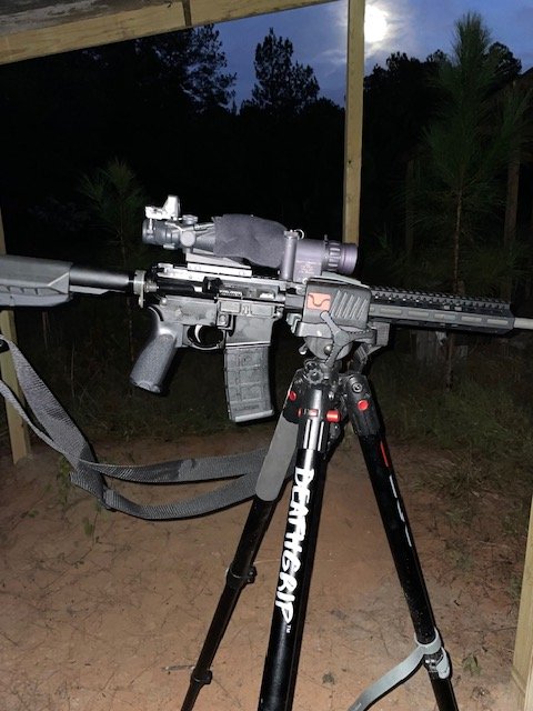

UNS SR is around the same price range, fits nicely on most carbines and doesn't completely ruin the balance of the rifle.
Our range only goes to 420 yards and I need to do some mowing around the last target there, but I was banging steels at 100, 200 and 300 yards the other night with my UNS SR and ACOG
