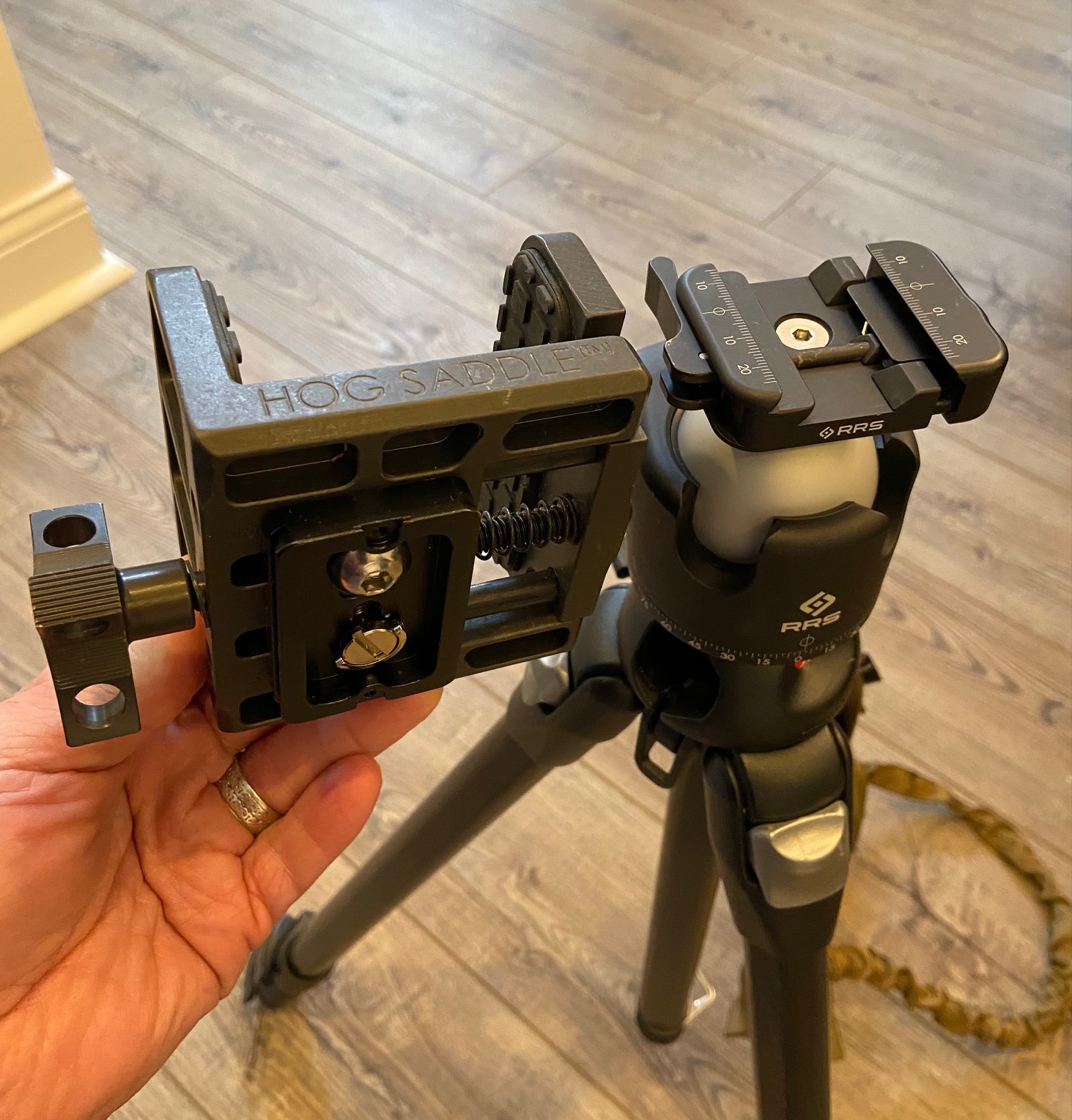

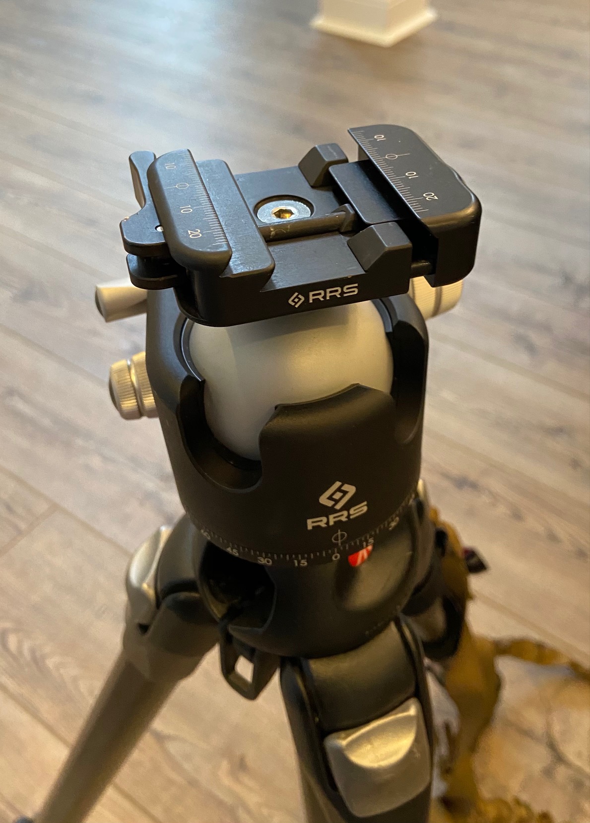

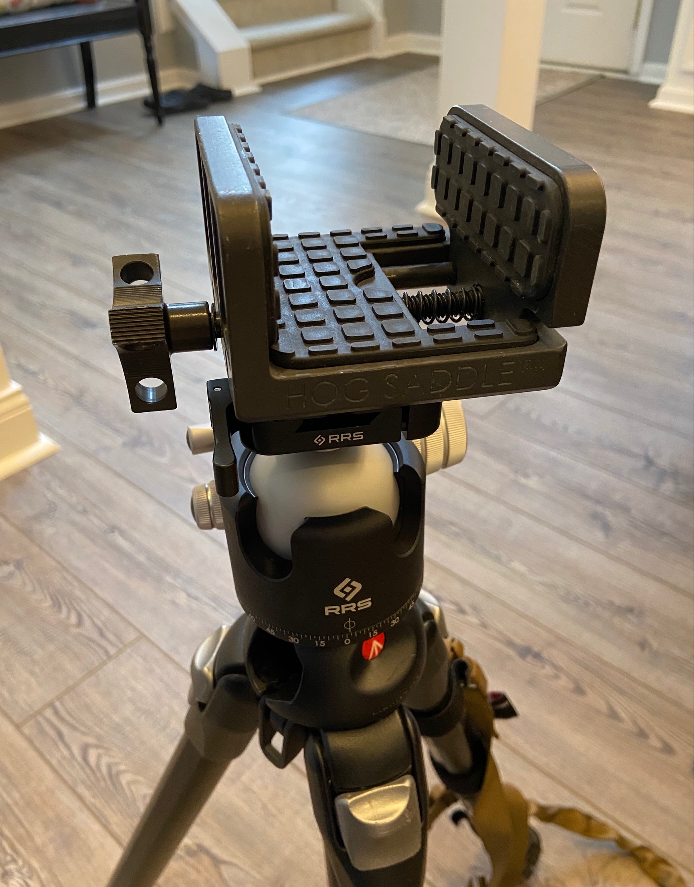

    If you want the most "versatile setup":
    Take whatever head that you want, and put a RRS SC-LR Clamp on it. That QD Lever Clamp can grab BOTH a PIC Rail & Swiss Arca Rail. That gives you the versatility to grab a typical AR Pic Rail and a Precision Rifle Arca Rail.
    Then take a Hog Saddle (which ever model works for you), and put a Swiss Arca rail section on the bottom of it. You can then quickly & easily grab/mount the Hog Saddle with the SC-LR clamp on the tripod.
    If you carry/use that setup, then you can grab/mount 95% of the rifles out there. Downside, it is NOT a cheap setup!
