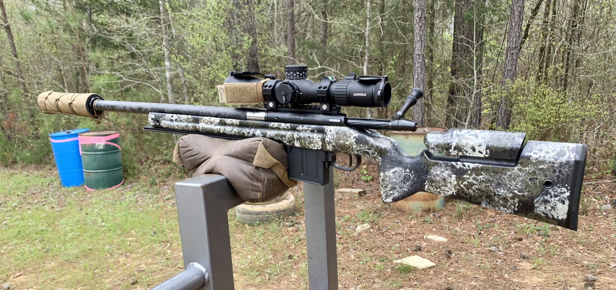

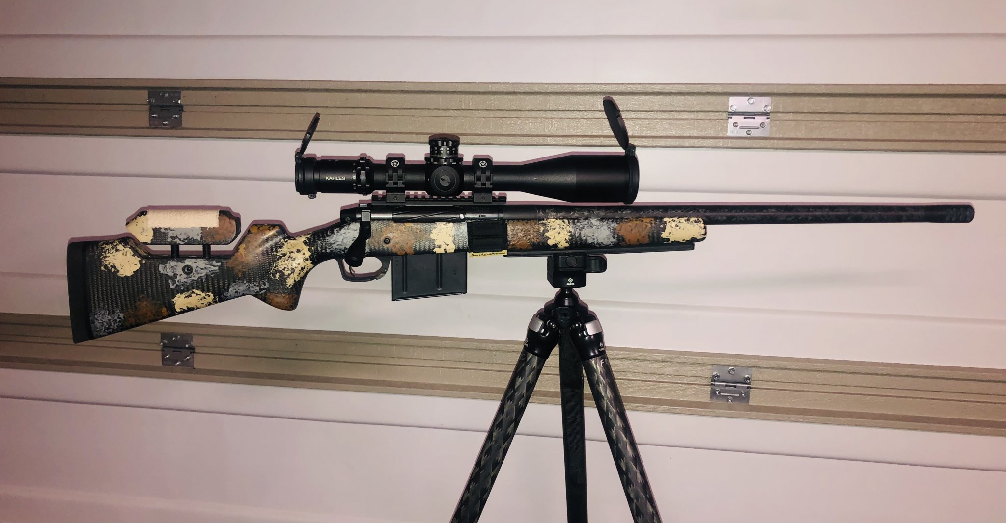

Like this one
I’ve been thinking of selling it
Shoots factory Hornady ammo really well.
I’ve never done a load development for it
I was shooting 143 ELDX at 2675
That was with a Deadair sandman S
I recently sold the scope to fund my PRS habit
As shown weighed 11lbs - that’s with scope and Sandman-S

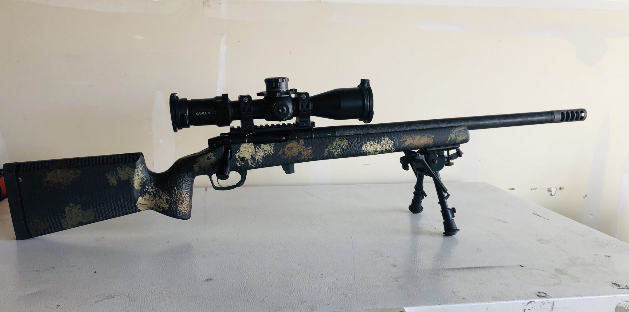

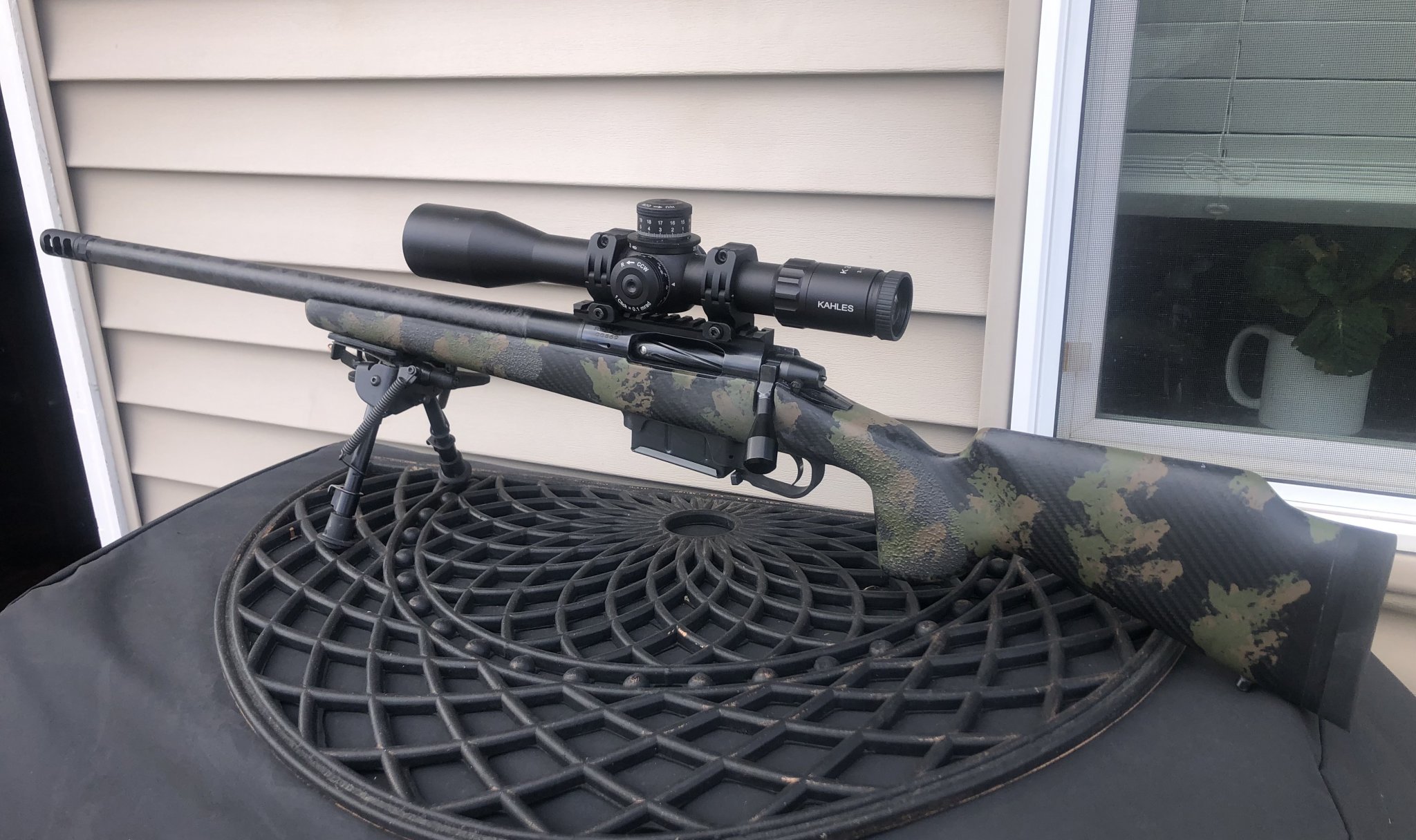

My whole package is a Proof 20" CF, ARC Nucleus, ARC rail, Manners CS-2 w/ mini-chassis and a 4" rail section up front, TT Special 2-stage. Goes like 7.5 lbs. All up with optic, Atlas CAL, Dead Air Nomad, magazine it's 11.75 lbs. It carries really nicely, in my opinion. With all that stuff on it, the balance point is right at the front of the mag well. The reason being the CS-2 is very butt heavy with its adjustment mechanism. The balance is definitely rearward without the can and the bipod on it - you may or may not like that feel.
I had (have) a 22" 6.5 CM - the difference (vs. 20") isn't worth worrying about if you're weight conscious. If I were optimizing performance (instead of rapid length of pull adjustment so that my son can share the gun with me), I'd transition from my CS-2 (2.75 lbs or so) to the T2 (same ergo package) modded to use the CS-2 cheek riser (or maybe just a spacer and a cheek wallet). The LRH is obviously an even lighter, more fully featured option. Keep your optic to 30 ounces or so (I've run 24, 29, and 30 ounces on this and the weights are for the 29-ounce setup).

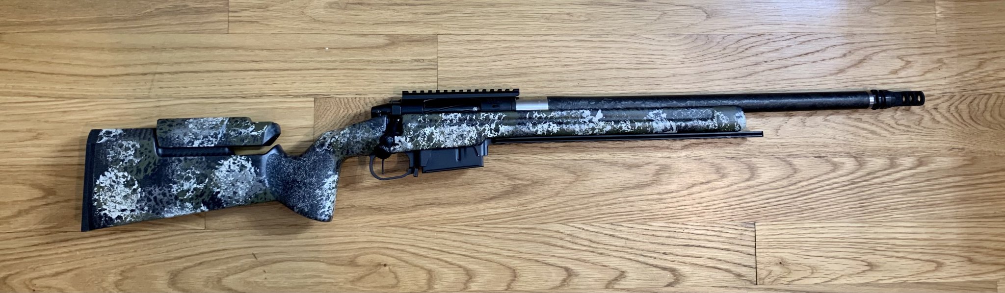

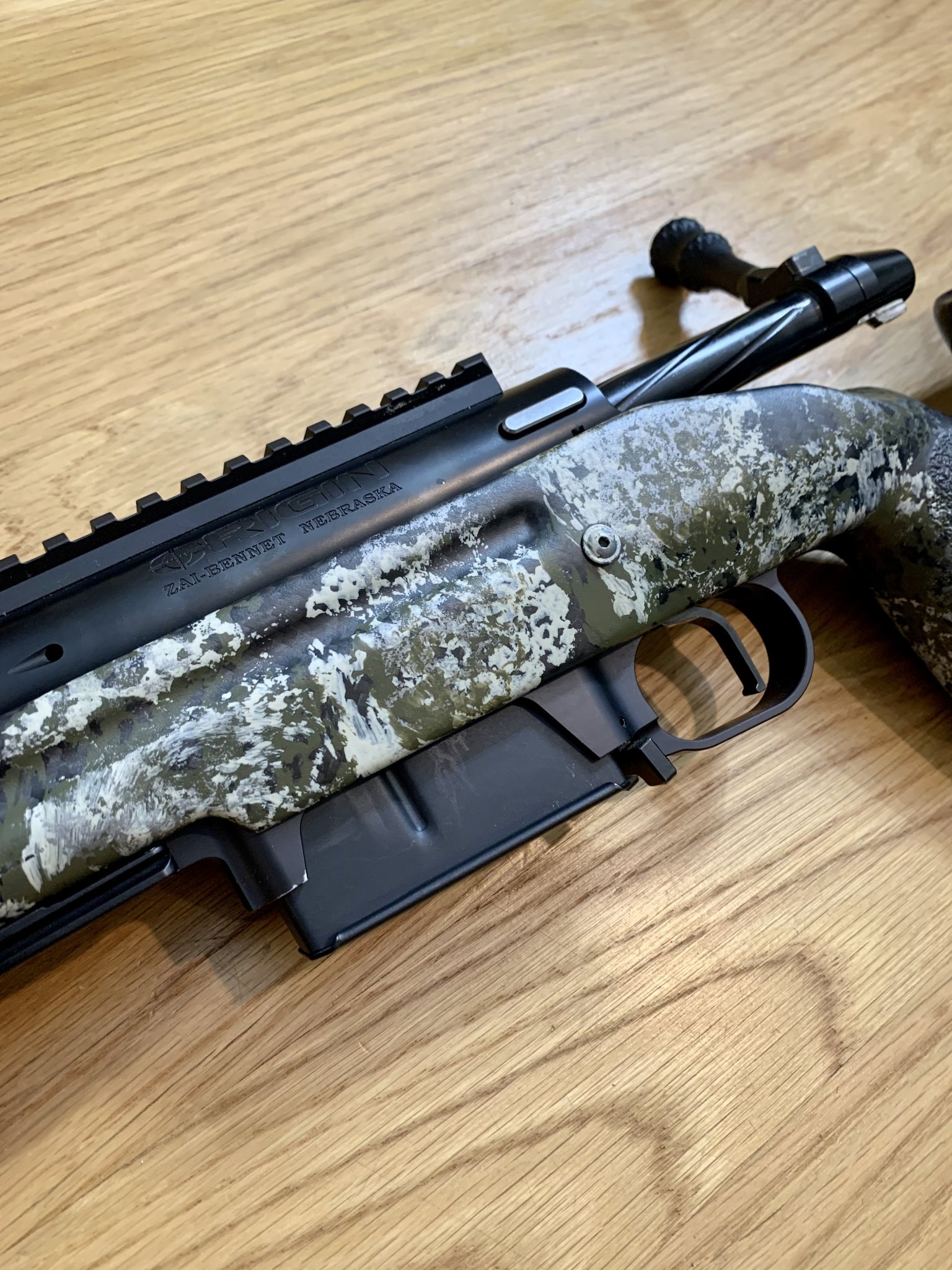

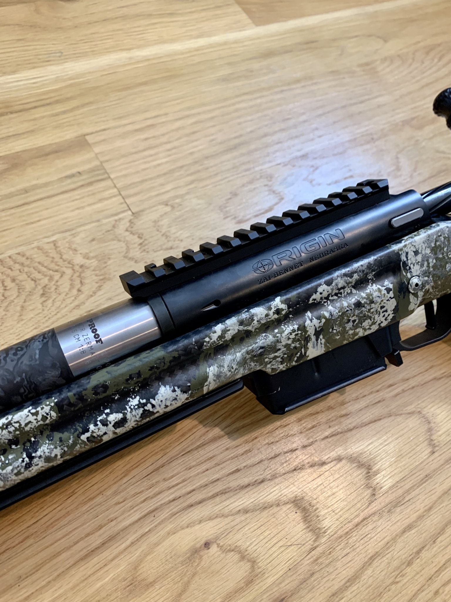

Stock : Manners TA, Manners Pro Hunter, Manners LRH, Mesa Precision Adjustable Altitude. Just sold the EH1 on my 308 for the Pro Hunter.
Action : Bighorn Origin
Barrel : Proof CF Sendero Prefit
Trigger : TT Special or Diamond
Rings : I know you don’t want rings but the ARC M-Brace rings are fire. Run them on all My guns
Brake : SRS TiPro line
Bipods : Atlas Cal
That basically sums up all my rifles. 6.5PRC comes in at 9lbs, 308 at around 10lbs with optics. 7RM is closer to 12lbs with optic.
