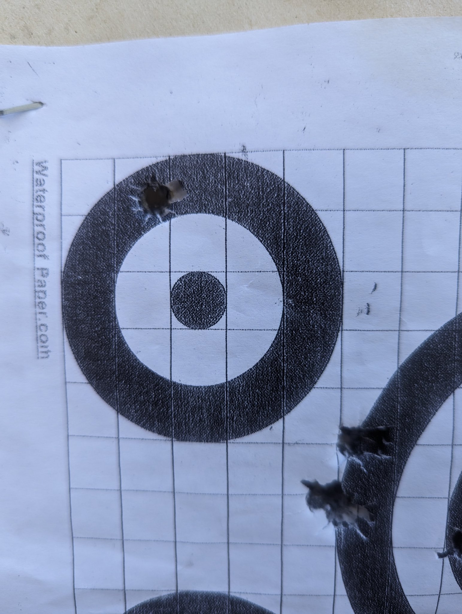

    42.2 IMR 4064 175 SMK
    I've been messing with seating depth lately. This was 2.806, for some reason my 1st shot is always separate from my groups but my groups are always like this. They measure 3.22 if you include the flyer. .67" if you don't. 100yds
