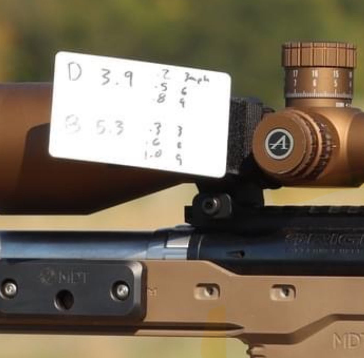

Here you can see how i have each target, D&B, with the elevation. And then in the columns I have the wind hold for a 3,6&9 mile per hour wind hold for both targets.
Nothing about yardage, those are known and calculated for. Just dial the right numbers for the right target letter.
