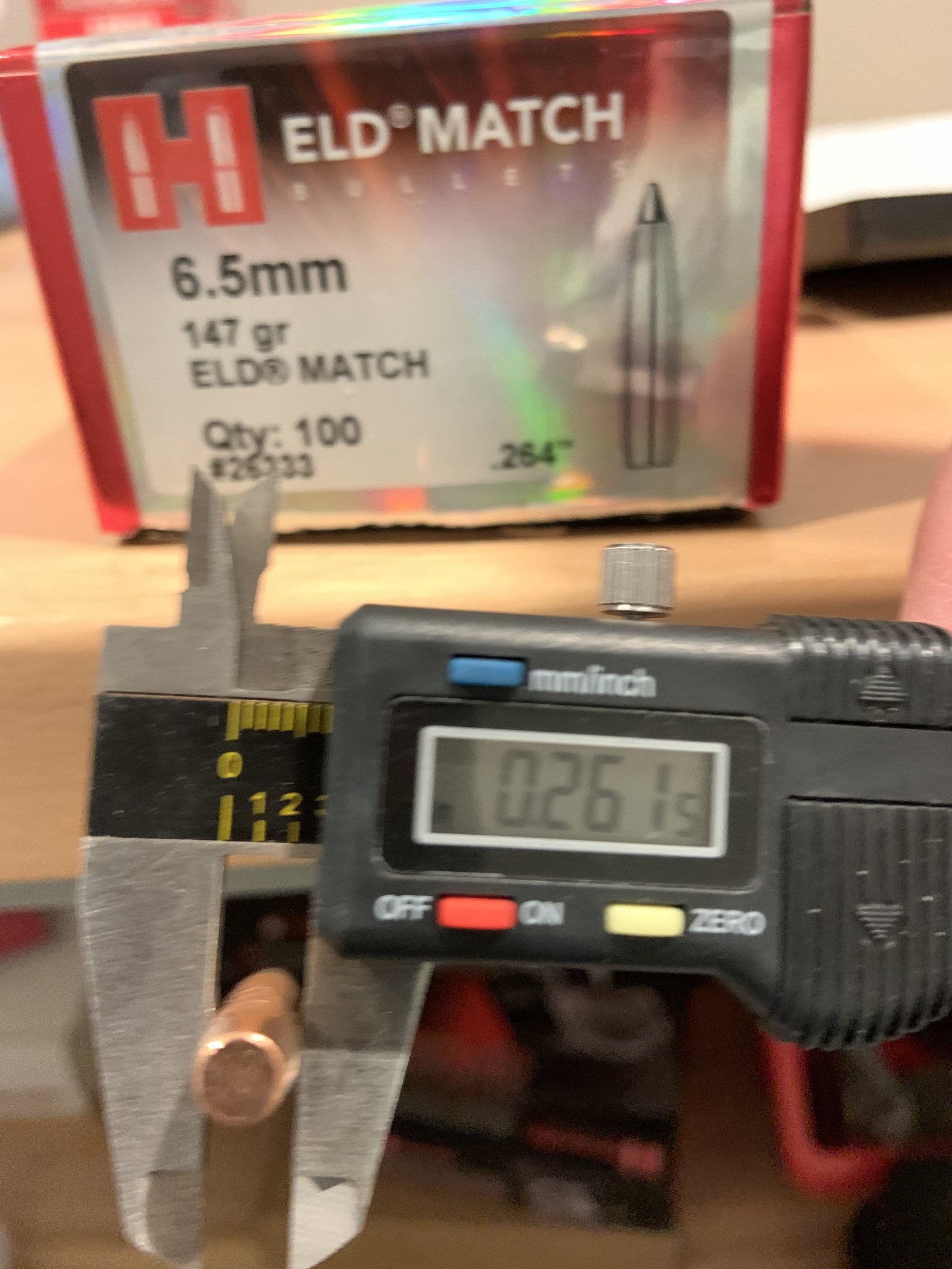

why do my 147 eld's say .264 ,and when I measure them With my clipper, they measure .262.Is this correct?

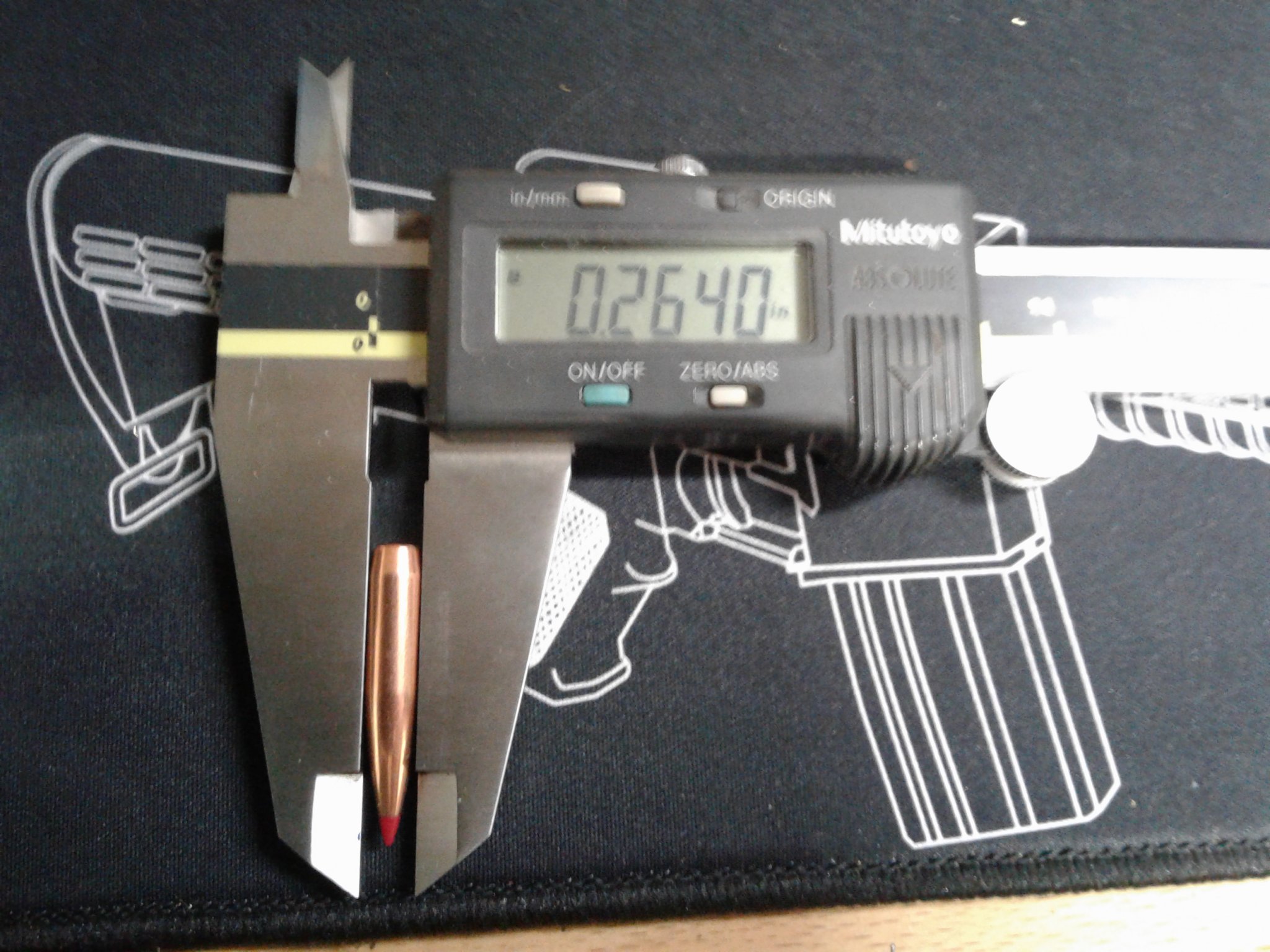

No. I measured 140 gr ELD for 6.5 CM where the box said .264" diameter and the diameter was exactly that when I measured it. Well... the calipers bounced a little between .2635 and .2640 but you know... my digital calipers are technically rated to be accurate to within .001"
.262" is incorrect. Maybe you measured it wrong / need to calibrate your device?

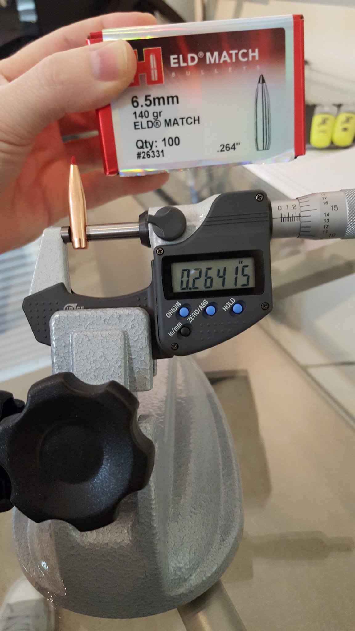

I actually just remeasured it with a more finely tuned device and got .26415

The digital calipers are just some RCBS brand I got at Cabelas. The more precise measurement was from a Mitutoyo 293-340-30 digital micrometer.

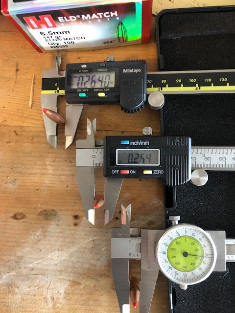

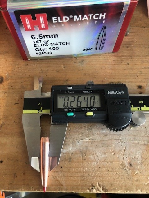

Take a look

Not standing up for Harbor Freight's "quality", but unless you got a bad pair (possible), I doubt that's it. Do you know how to zero your calipers ? There is a clamping set screw somewhere around the circumference of the bezel/dial.
You make sure the jaws are clean, you close them all the way, you loosen the set screw and turn the bezel so that the indicator hand is pointing directly at zero. Then, you tighten down the set screw, making sure to not disturb your new zero and you're done.
wow...and it says 0.000 when the calipers are fully closed? if they do, I would suggest double checking with a secondary measuring device first if available. If not you van get a gauge block off amazon for like $30 to check your calipers for accuracy. The only other thing I can think of is that those aren't 6.5 mm bullets as the box suggests but doubt that's the case.

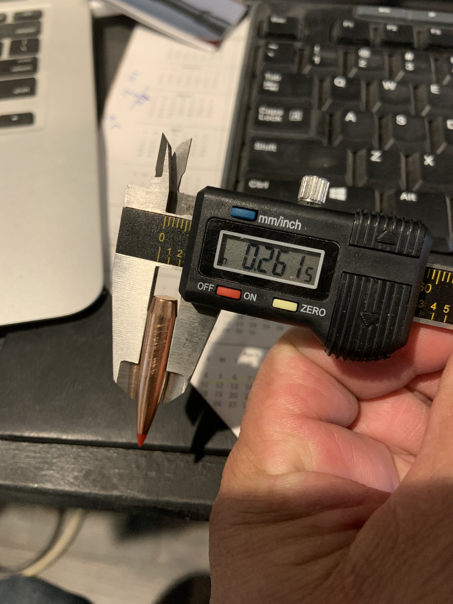

Still in the same boat ,will need to order better calipers ,just to make sure .
Close the jaws of your caliper and hold them up to a light source.
Look for runout on the jaws or are they perfectly flat and parrallel to each other.
