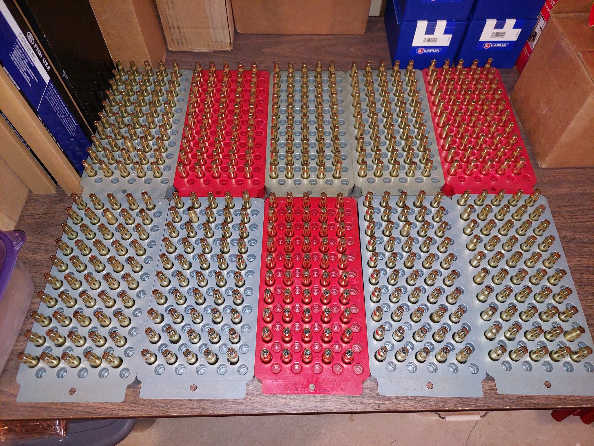

One thing I like personally to do that I don't see mentioned........after charging the powder into a rack of shells, I always take a flashlight and peek into each one to be sure I didn't miss any. Only takes a minute and it relieves the squib worries.
Anyone reloading should be doing this. Always line them up and take a look in, over/under easy enough to tell. If you manually drop pistol rounds it's even more important to visually check. 500 checked!
