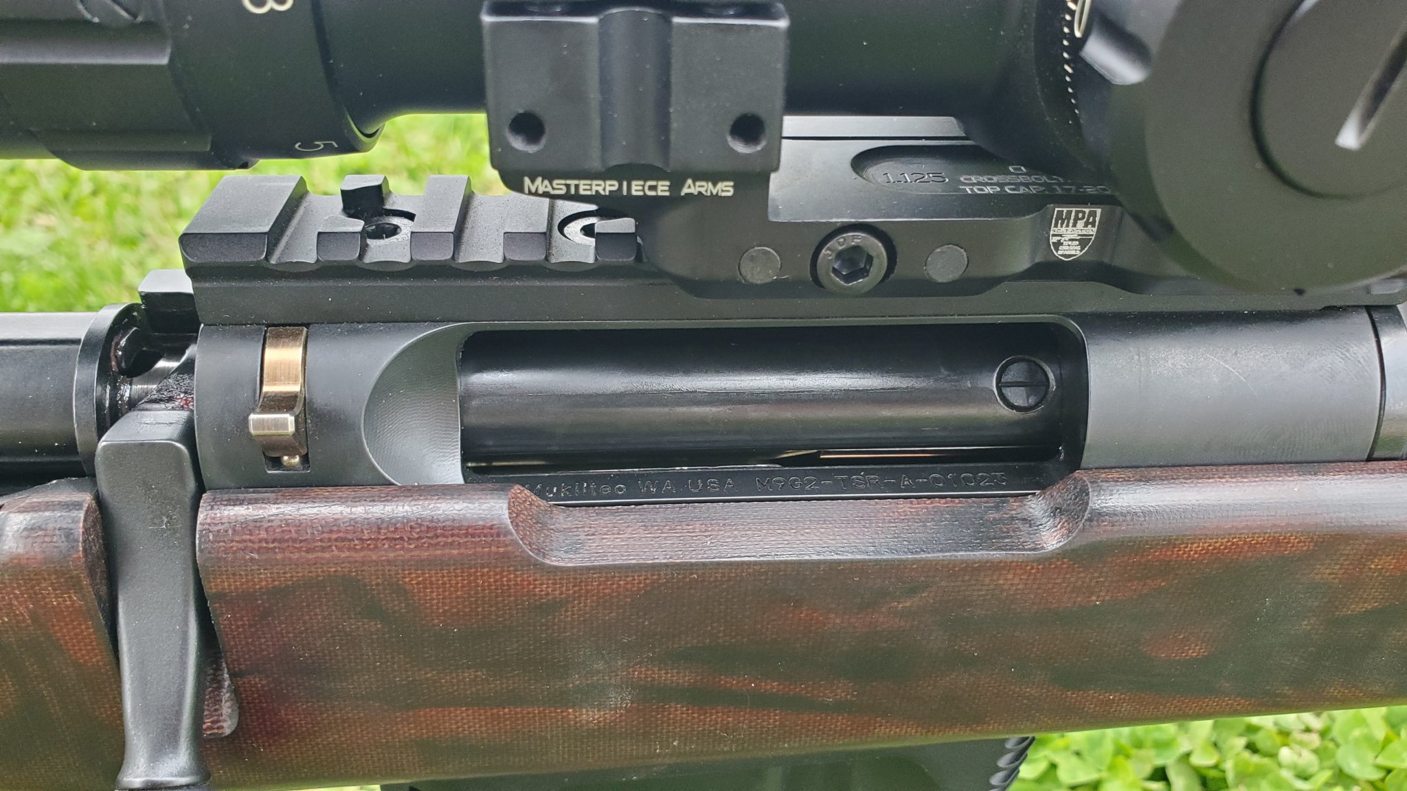

Here's a nuke in a foundation impact inlet. It functions but I will be opening up the ejection port cut.

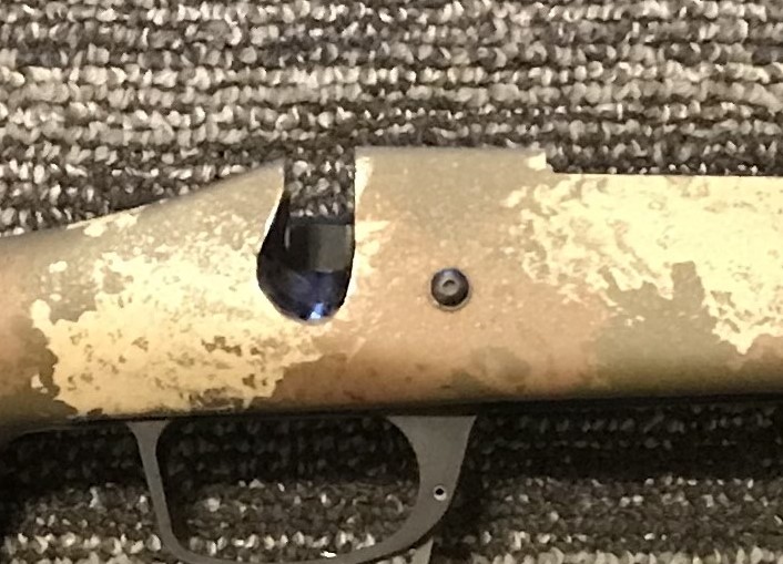

Yup will drop right in to the mini chassis as it will use any 700 action or clone. As mentioned the bolt handle might have some rub but a couple minutes with a dremel will give it the room it needs. I have done it on a few Manners with mini chassis. Below is one.
Fiberglass grinds very fast. I would use handfile(1/2 rd,flat, and possibly a rat tail file). Dremels can get away and cut extremely fast.
Yeah, I mean it works and if it goes perfectly it's fine. They can grab onto something and spin off, though, never had that happen with a file. A poor craftsman blames the tool, but also a poor craftsman uses the wrong tool.
