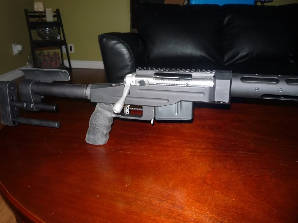

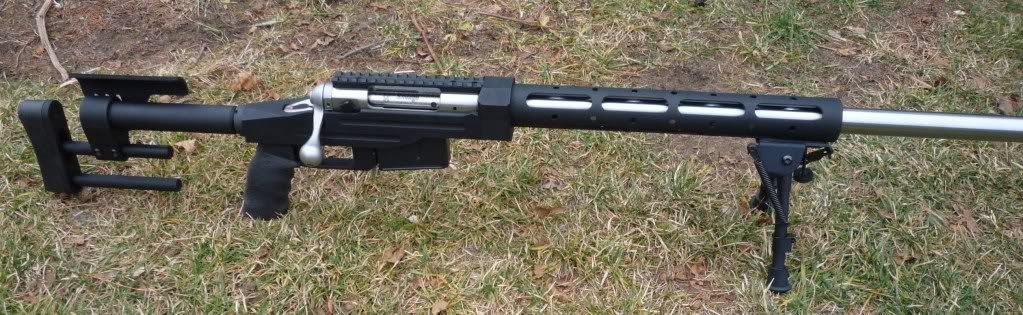

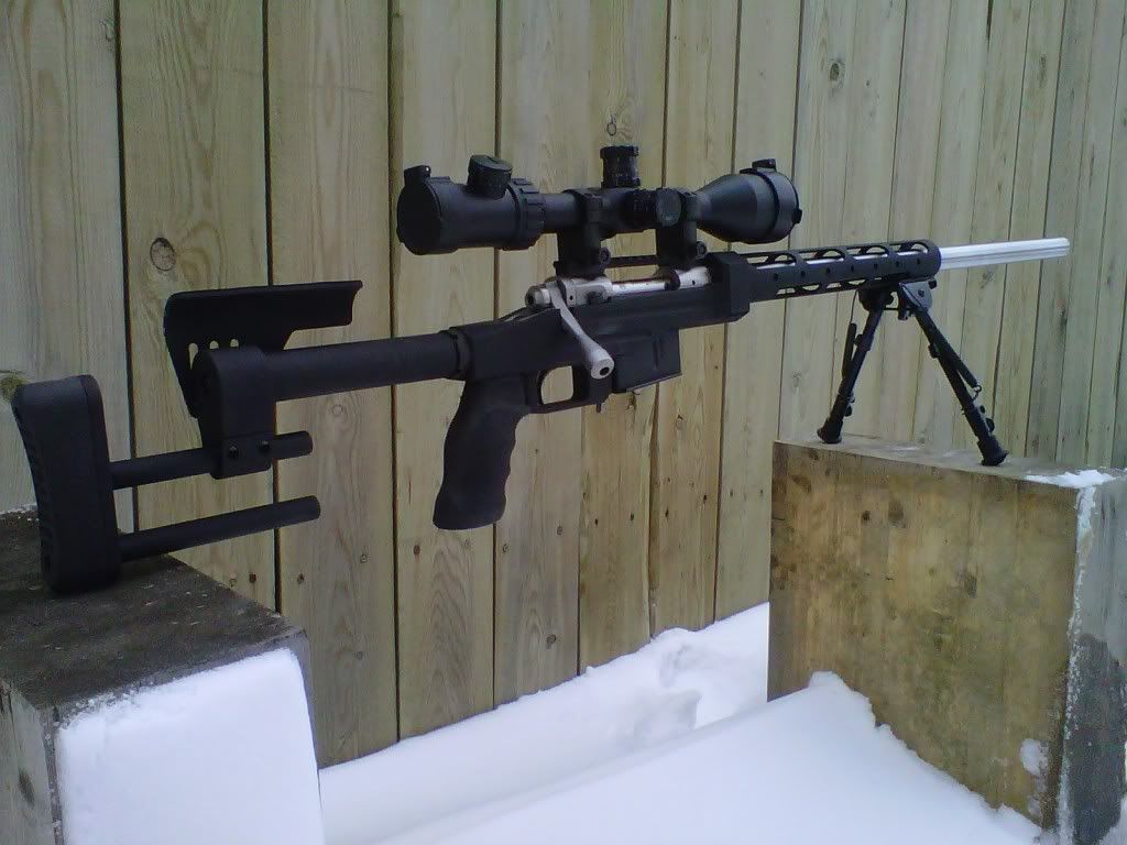

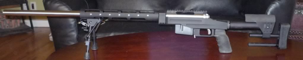

Hi guys, new to the forum, been a lurker/reader for a while. Here is a build I am putting together, let me know what you think...
Savage stainless steel bolt action blue printed
McGowen Barrel Match .308 1-10 Twist SS
XLR industries stock with AICS mag
Bolt lift kit, over sized tactical knob
Heavy recoil lug
And a few build photos.
And a jump to present...
Let me know what you think!

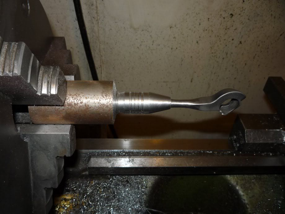

<div class="ubbcode-block"><div class="ubbcode-header">Originally Posted By: bear_blade</div><div class="ubbcode-body">Decided to switch to this bolt knob. This is a better style for me...

I had origionally planned a total flat black set up. My builder talked me into letting him set it up in stainless and black, didn't think I would like it but it's growing on me. When I get it in person, I might go with a OD or black coating, we'll see, for now this is keeping a smile on my face!

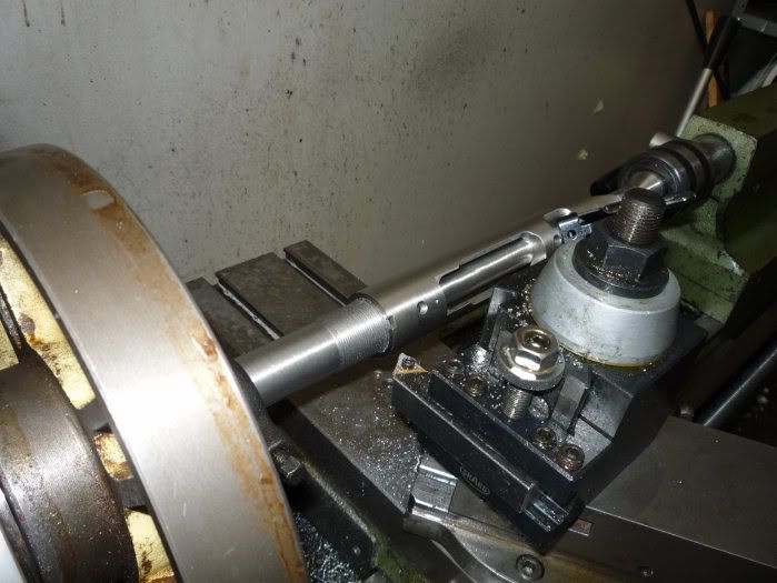

Re: Noobies new build
If I get the pics you mean, 1 is the machining of a potential bolt knob, 4 and 5 are of a thrust bearing kit that goes inside the bolt to make the opening and closeing of the bolt smoother. No metal on metal grinding/rubbing feeling. Also for what its worth, a little quieter. It goes in the ass end of the bolt, near the handle. A small spacer needs to be machined, and is totally reversable. Takes about 2 minuts to remove.

Bear Blade,
Have you been on the savageshooter forum? The best idea i've seen thus far is the 38special case with a polished set screw/bearing...and a bearing mounted in the BAS screw. I would think the combination of these would provide the least amount of surface area thats in contact with one another. I have also used flitz to polish everything inside of the bolt body. This actually seems to help slightly. Keep us posted]

OK, rifle arrived safe and sound, and WOW! Nice work! Fit and finish is amazing! I ave yet to get to the range, that is to follow. Have some .308 Lapua brass on the way, should be here tomorrow.
As for the bolt lift kit, the answer is yes, there is a big difference! I took the new rifle to the local shop, and compared the lift side by side with a 10FCP, and a BAK, chambering and ejecting snap caps, and empty brass, the bearings make this action slick as snot! No comparrison. My rifle has a fairly tight head spacing, and even still, there is only smooth action, mind you there is still tension, and effort to open close, but it is very smooth, buttery smooth.
