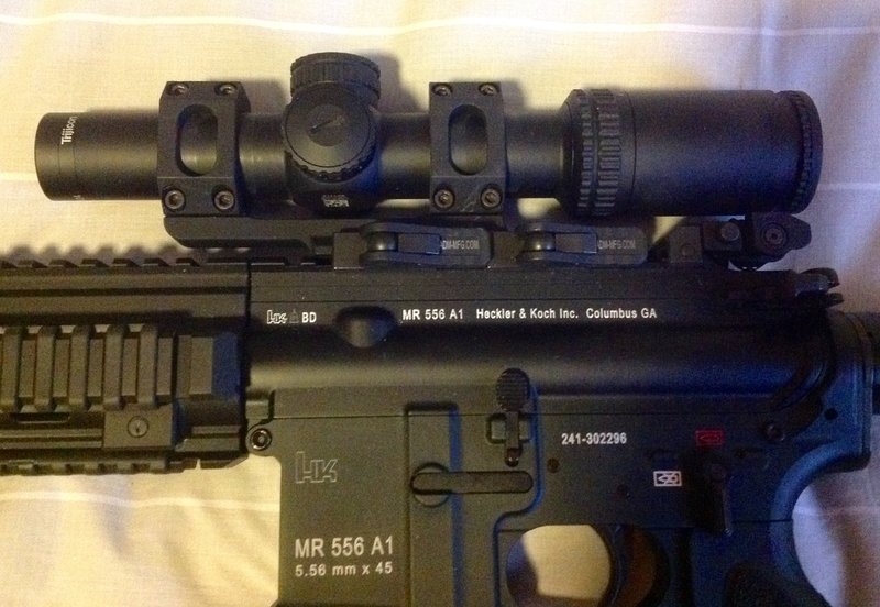

This scope I will like to use on one of my AR15 HK mr556a1 or LMT CQB piston 556 , for Self-defense combat and ??? ( or just fun to shooting )

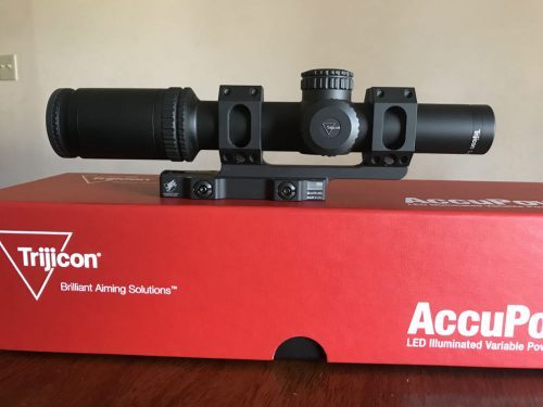

Finally got the Trijicon AccuPower 1-4 X 24 with American Defense QD mount
