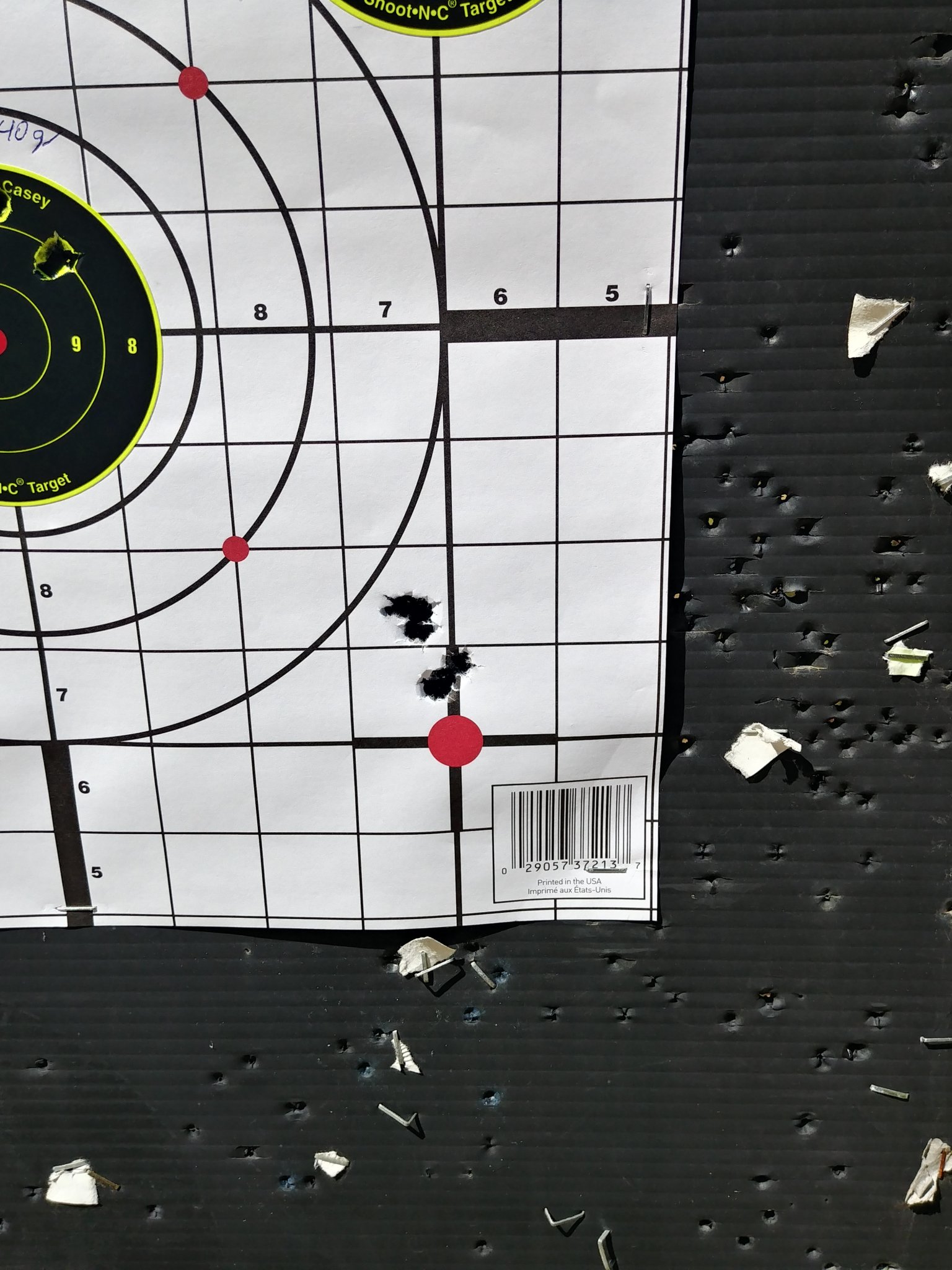

Mine likes it. 2x 3 shot strings at 100 yrds.
