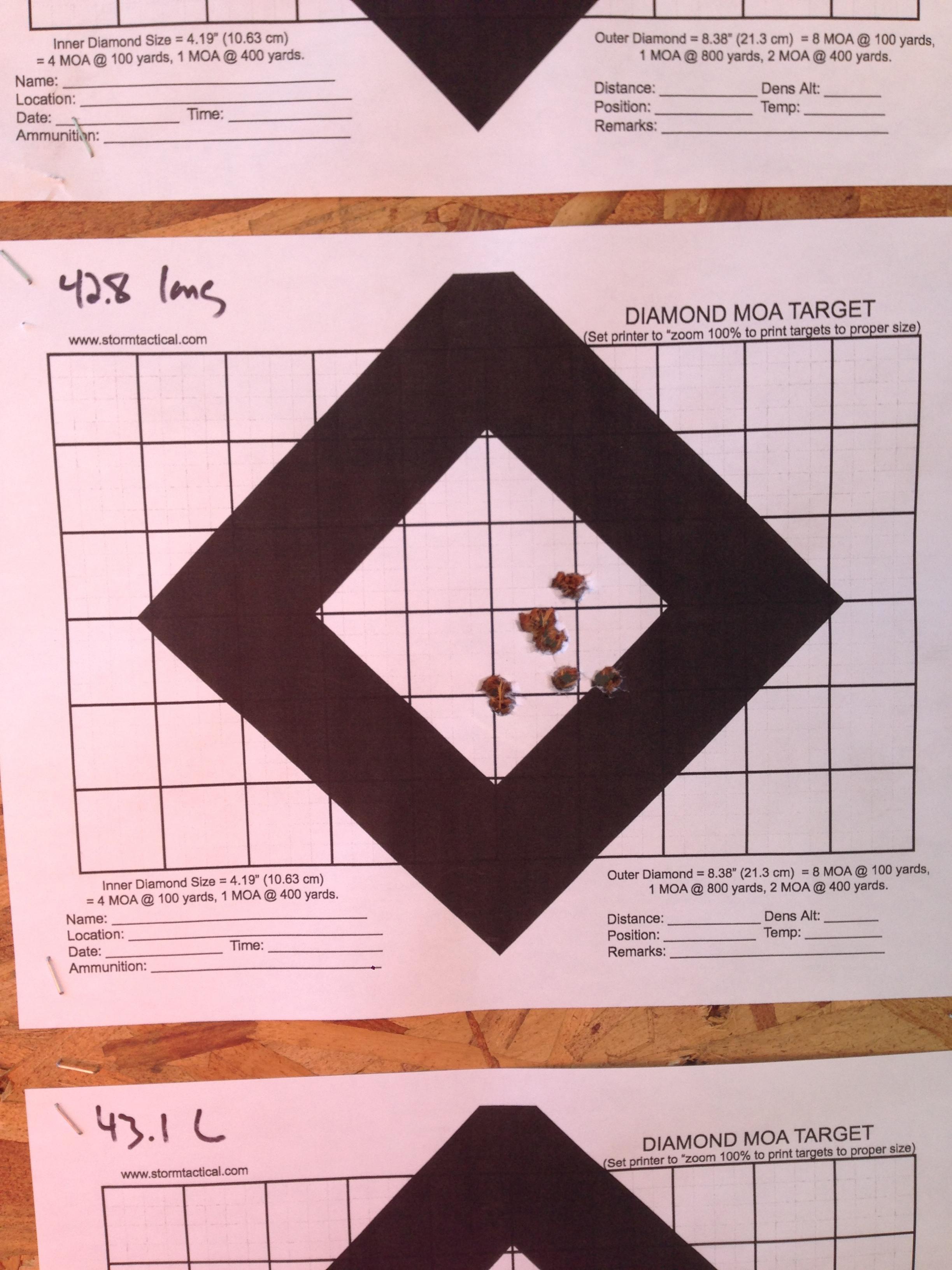

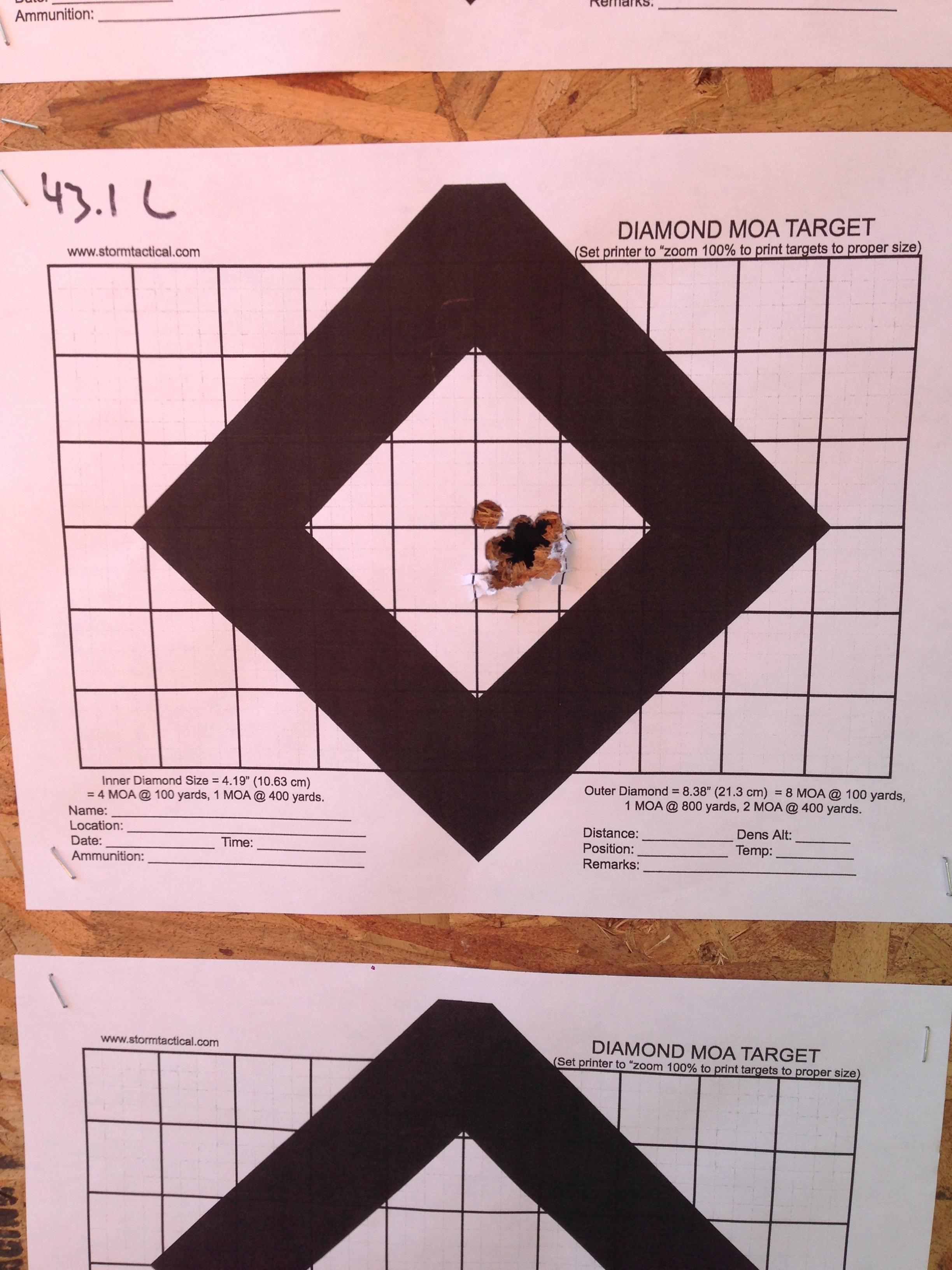

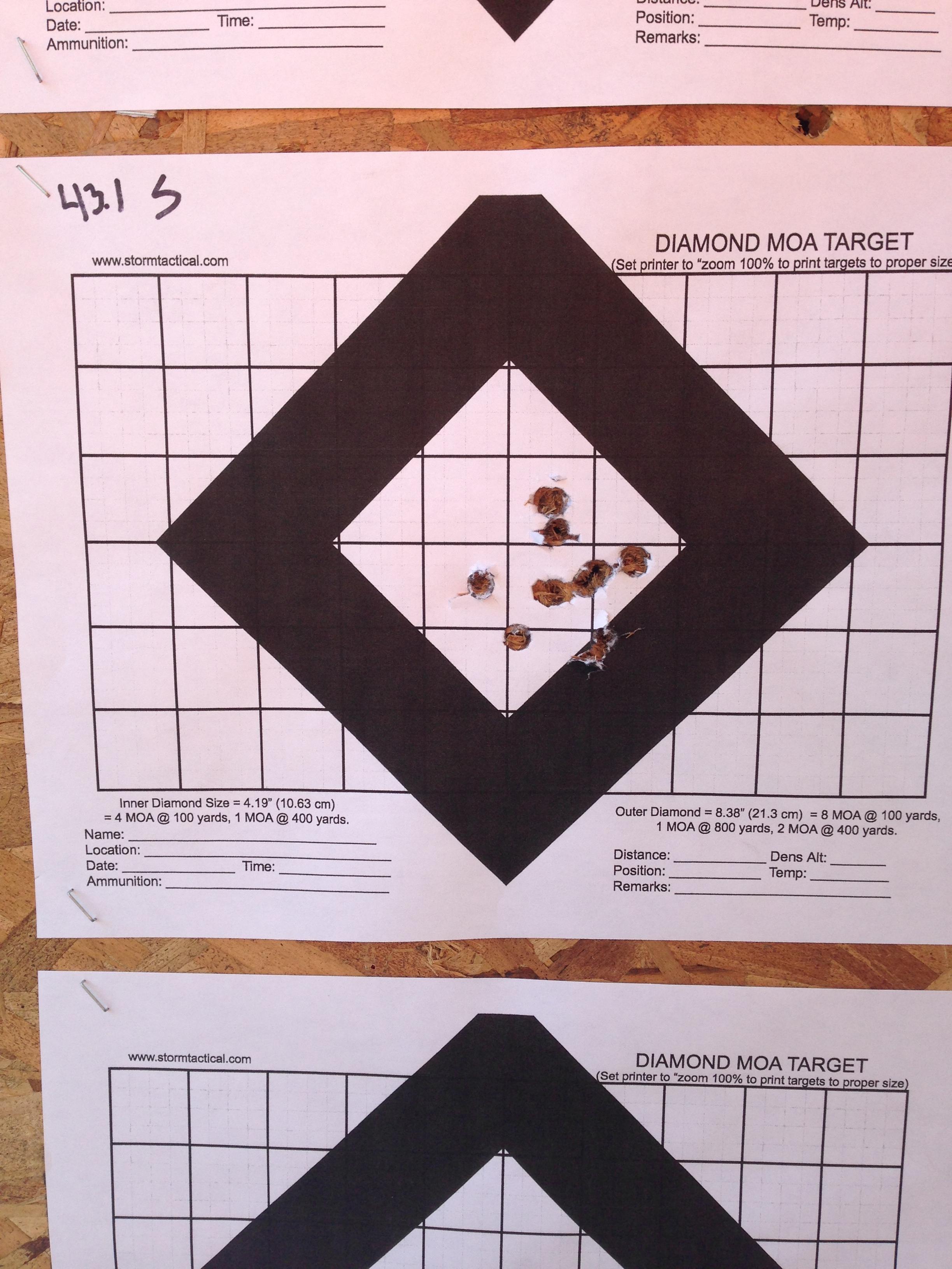

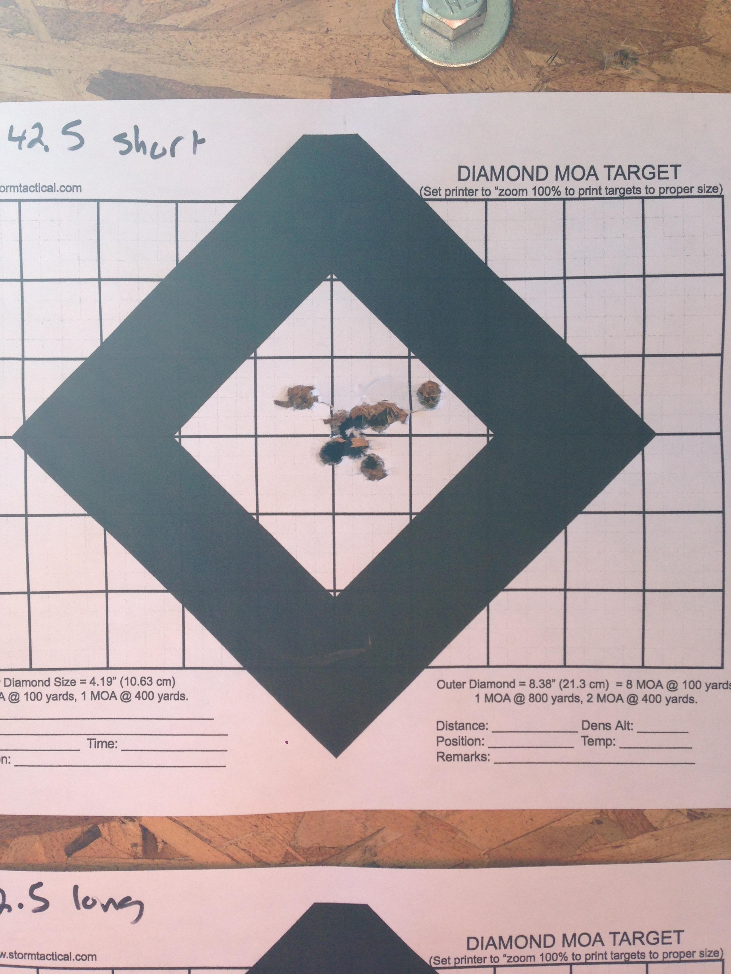

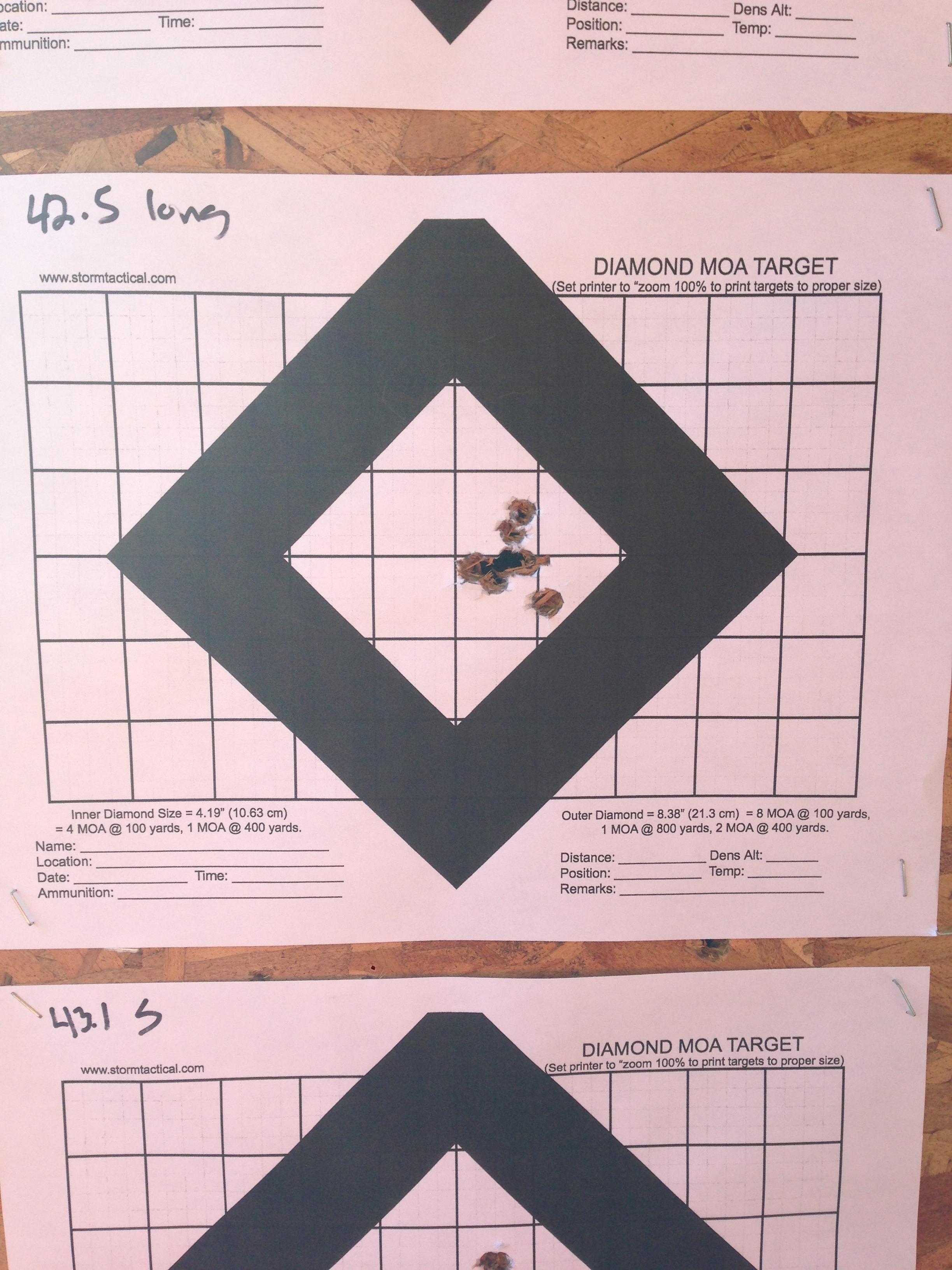

LC 11 brass once fired - trimmed to 2.005, swaged on Dillon 600, chamfer and deburred.
Tula .7.62 Nato primer
175 SMK machine pulldown
A)Shot 6 series of shots
B)42.5 g, 42.8 g, 43.1 g.....10 rounds loaded to 2.215 and 10 rounds loaded to 2.285 so 60 rounds total.
C) Wanted to test jam vs. jump
D) Chamber OAL is 2.300 so I loaded .015 off the lands and 2.215 because that is the reading I got measuring bullet ogive to cartridge base from FGMM which is 2.800 COAL
E) Almost each group had 2 primers that did not ignite so I am blaming the reloader (myself) and that is why even though I loaded 10 rounds for each string the results may not show 10 shots fired.
65 degrees, 3000 ft altitude, 3 mph wind, bipod, no bag, 1:10 twist Bartelin Med Palma 26" with AAC 7.62 SDN Suppressor, 100 yards
43.1 grains loaded to 2.285 was the best out of all of them. 43.1 grains loaded to 2.215 was shitty. The target with 43.1 grains had all 10 rounds through that hole that can be covered by a quarter. Of course if you want to get really technical then my statement is false because of the flyer in the upper left but 9 out of 10 ain't bad. What's weird is I shot 10 rounds loaded with 42.5 grains @ 2.215 last weekend and the results were much better. What I noticed was that because some, and pretty much too many rounds were not igniting I was jerking the trigger back rather than applying an even amount of force because for some reason I thought maybe the pin would hit harder. All strings sucked ass today except for the very last.
Series 1 Shots: 9 42.5 S
Min 2634 Max 2673
Avg 2657 S-D 15
ES 39
Series Shot Speed
1 1 2634 ft/sec
1 2 2670 ft/sec
1 3 2639 ft/sec
1 4 2656 ft/sec
1 5 2673 ft/sec
1 6 2673 ft/sec
1 7 2644 ft/sec
1 8 2668 ft/sec
1 9 2662 ft/sec
Series 2 Shots: 8 42.5 L
Min 2624 Max 2648
Avg 2635 S-D 7
ES 24
Series Shot Speed
2 1 2627 ft/sec
2 2 2624 ft/sec
2 3 2635 ft/sec
2 4 2631 ft/sec
2 5 2641 ft/sec
2 6 2635 ft/sec
2 7 2648 ft/sec
2 8 2639 ft/sec

Series 4 Shots: 7 42.8 L
Min 2641 Max 2682
Avg 2666 S-D 15
ES 41
Series Shot Speed
4 1 2658 ft/sec
4 2 2652 ft/sec
4 3 2641 ft/sec
4 4 2672 ft/sec
4 5 2676 ft/sec
4 6 2682 ft/sec
4 7 2682 ft/sec
Series 5 Shots: 9 43.1 S
Min 2699 Max 2745
Avg 2721 S-D 13
ES 46
Series Shot Speed
5 1 2745 ft/sec
5 2 2727 ft/sec
5 3 2730 ft/sec
5 4 2718 ft/sec
5 5 2721 ft/sec
5 6 2699 ft/sec
5 7 2729 ft/sec
5 8 2714 ft/sec
5 9 2710 ft/sec
Series 6 Shots: 9 43.1 L
Min 2676 Max 2721
Avg 2700 S-D 13
ES 45
Series Shot Speed
6 1 2710 ft/sec
6 2 2707 ft/sec
6 3 2676 ft/sec
6 4 2701 ft/sec
6 5 2689 ft/sec
6 6 2710 ft/sec
6 7 2691 ft/sec
6 8 2721 ft/sec
6 9 2698 ft/sec
Max load listed is 43.3 gains and there were zero pressure signs so I am going to try 43.3 loaded short and long.
