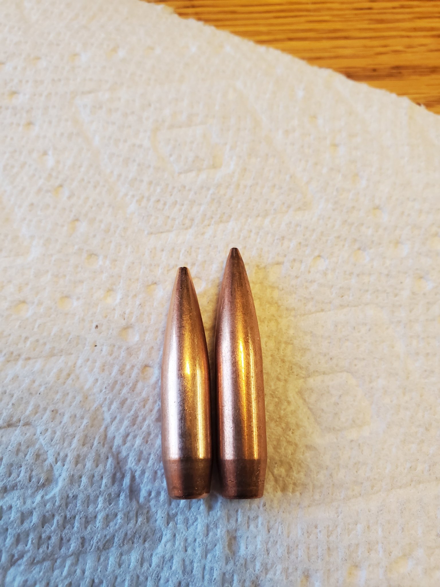

Anyone launch any of the Norma 338 250gr gtx pills? I bought a bunch of them from Raven rocks for cheap.
I'm curious if anyone has worked up a G7 or what results you've seen from seating depth.
I'll include a pic of one next to a 300smk that's been pointed.
Thanks in advance.
I just plug it into my AB app, if you launch it at 2900fps. It will reach subsonic around 1500 yards.
Reactions: hero's machine
Mine shows a 7fps advantage (1400) to the 300smk I'm shooting now (2805fps) vs 1393fps both at 1500. Both show super through 1900yds.

What a pleasant surprise. I loaded up 10 with h1000 and picked a couple of seating depths, one at mag length and one a bit closer. Both shot reasonably well. The longer shot very well. Speeds were 2950 spreads were tight and 100 and 300 accuracy were well south of moa.
Made me happy to have a bunch.
Reactions: Dave62677
I shot these today at 1350 and 1748. 1350 was exactly as predicted, 1750 impacted about .7m low. Repeatability was good.
Thinking about this after I got home. I had 100% predicted hits to 1350 then jumped to the mile. I'm doubtful the bc changed that much from 1350 to 1750. I'm betting there was some error on the rangefinder return. The repeating on the shot was too close to be from going trans....imo.
