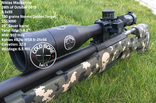

On this side of the pond, Norma GT is, as it allready has been mentioned, very popular and there are several reasons for that:
1: The seating depth is not critical, in fact they are very tolerant and still accurate.
2: Price is reasonable
3: They are allways in stock.
In my .260 Rem are they loaded to 2900 fps and are going steady to 1200 meters and this particular load, are a duplicate of the Norma Fält Elite 6,5x55, just without the nasty coating from the Diamond line projectile.
Here are an example of how it can perform in a cold bore shot:
Reactions: FishDr

@Bemoni - I’ve not shot it to a mile but believe this load in my 260 it would do it fine. I have shot it well past 1200 meters and it was excellent.
