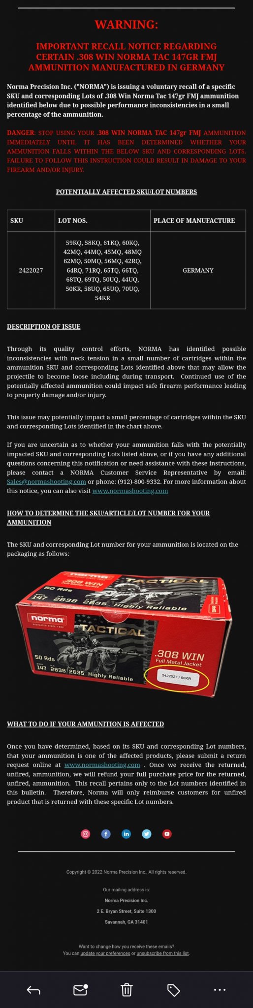

Did anyone else get an email from Norma about certain lots of 147 grain 308 ammo being recalled? I haven't seen it discussed anywhere yet, so I will attach a screenshot.
I have at leat 500 rounds from one of the recall lots, so I will be able to let everyone know how well they actually handle the process.

I received the notice as well. I’m sitting on half a case. In one 20rd magazine I had 3 bullets fall out of the case after manually clearing a chambered cartridge. Load mag, chamber cartridge, run charging handle - case, powder and projectile fly out of ejection port.

I have 2 boxes I ordered to try in my different .308 gas guns. I also picked up several boxes of their 69gr & 77gr .223 to try in my 3gun rifles. In the first box of 20 69gr rounds I have had 2 bullets drop back into the case upon chambering. I plan to contact them on Monday. The 77gr stuff turned in SD of 7fps on the 10 rounds I fired. I don’t have a ton of experience chronographing ammo, but that is a really small SD in my limited experience.

That seems to be the big shame of it. Tons of reviews saying Norma 308 fmj is super accurate for a way lower price than anything as accurate. I wonder what exactly happened to screw things up? I think the 150 gr fmj were made in Sweden but this 147 gr are marked made in Germany.
