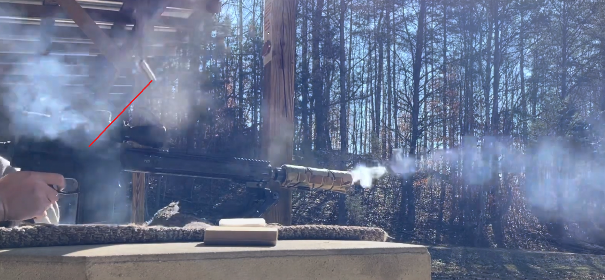

Normal gas while shooting suppressed?
Jmccracken1214
  • Dec 10, 2018
    2,339
    1,078
    Thomasville, NC
    I adjusted the gas block 1 click at a time until it locked back on last round, then moved it 1 more click.
    I didn’t really notice it too bad while shooting, but in the video, seems to be rather gassy.
    This is my first can, so just making sure all is normal.

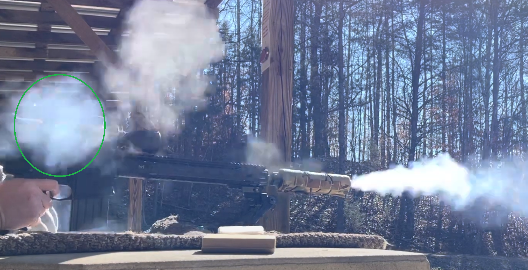

    Normal - First one green circle highlights the vast majority of gas coming out of your BCG vent holes.

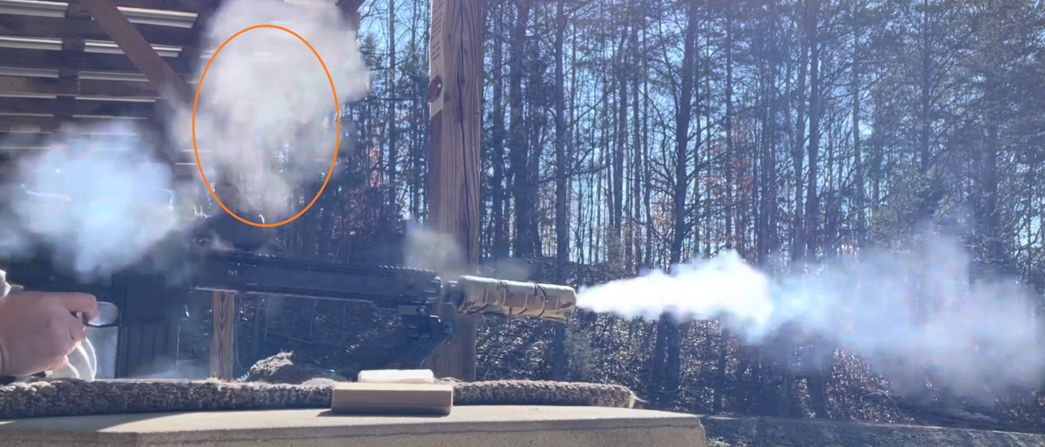

    Normal - Orange circle highlights gas coming out of your upper receiver clover leaf where the gas tube goes through. The gas key/gas tube doesn't create an air tight seal.

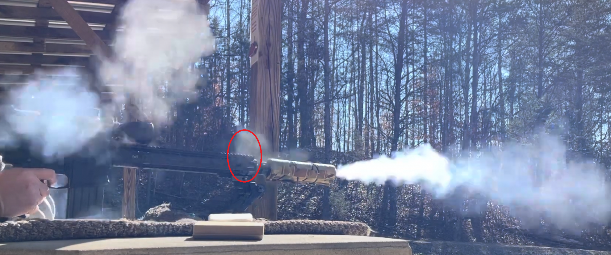

    Normal - Red circle, you'll see this especially with new builds and the carbon/fouling hasn't had a chance to create a tighter seal around your gas block and gas block journal on your barrel. This gas volume slowly reduces the more rounds that get fired. It could take anywhere from 50-200rds depending on how "dirty" your ammo is. During this time, remember to readjust gas block settings as you'll see your ejection pattern start shifting forward even when the rifle is cold. If you run a bleed off gas block, the red circle will have more gas shooting out from this area.

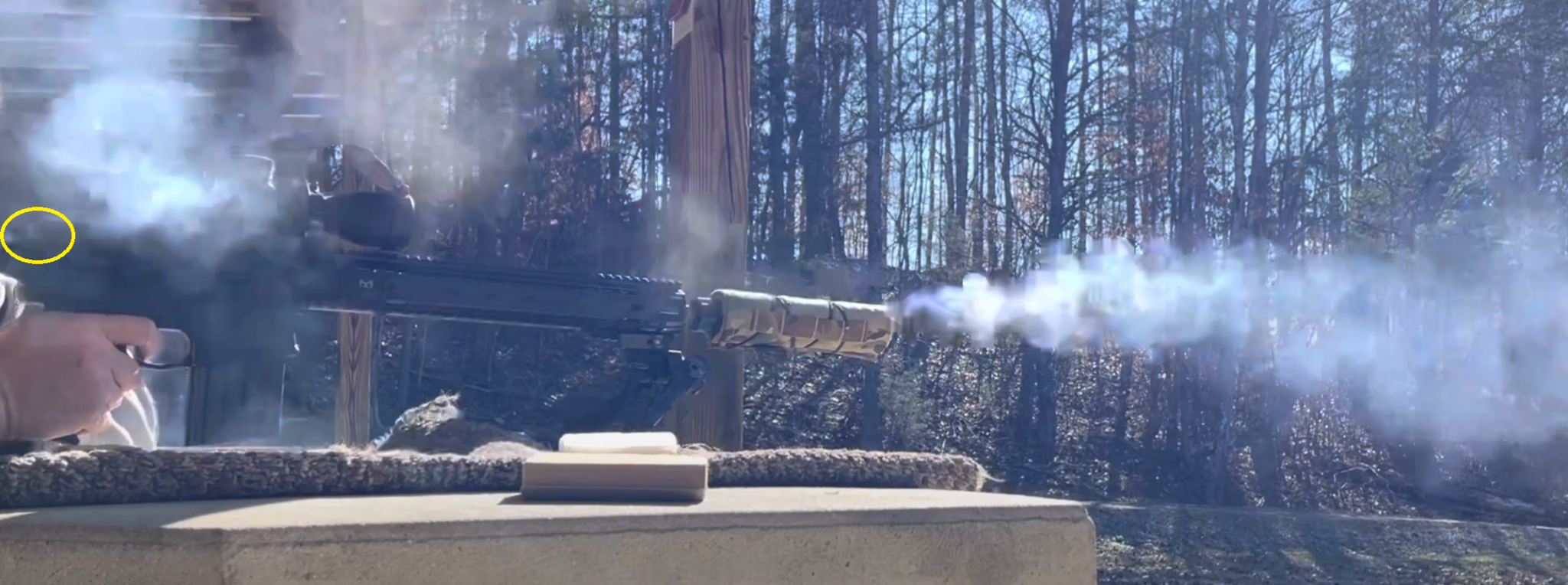

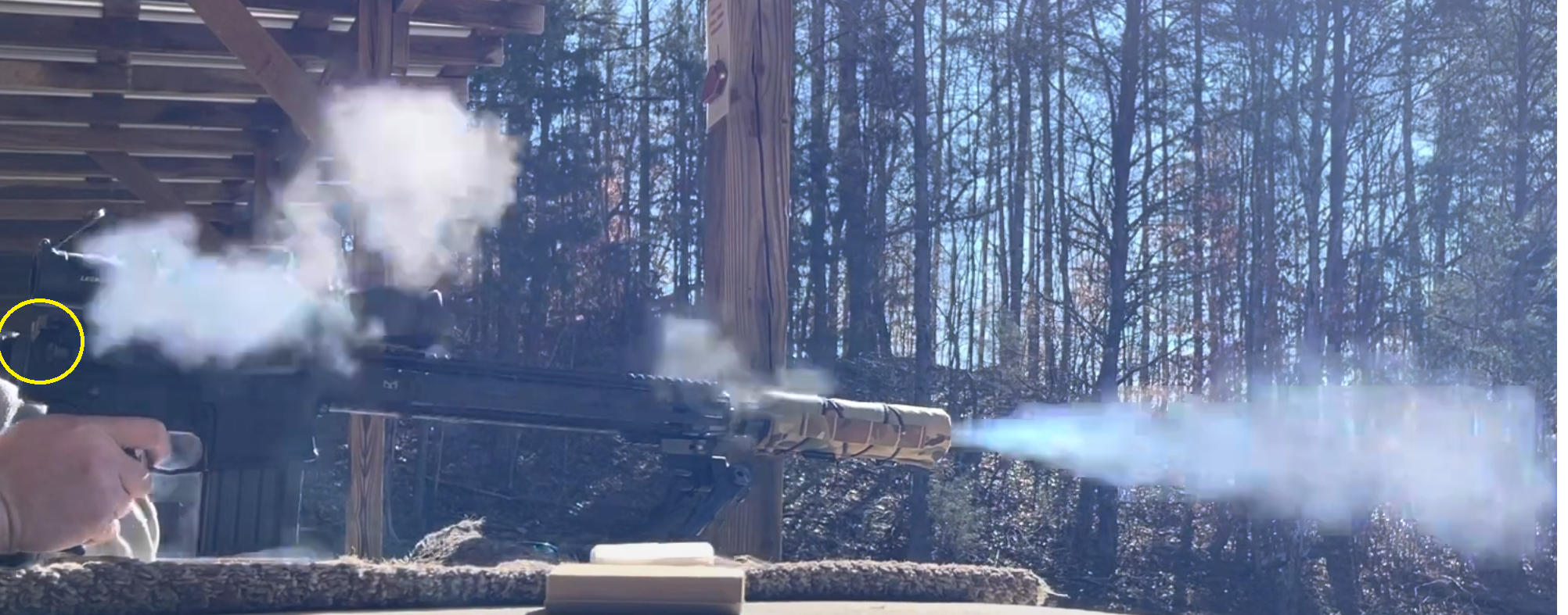

    Ejection pattern - This could be camera angle, however, it appears to me your ejection pattern is starting to shift forward closer to 2 o'clock as everything starts to seal up. Reduce AGB by a click or 2. You are likely over gassed rather than optimally gassed.
    Final - Yellow circle - note how initial exhaust of gas is not at charging handle and into your eye. Most gas escaping out the ejection port. Residual gas coming through the charging handle as the BCG travels farther rearward also normal.
