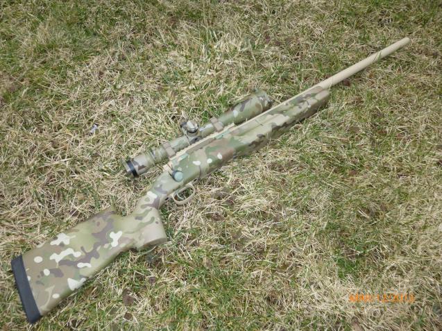

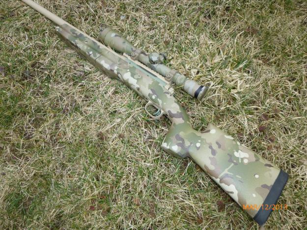

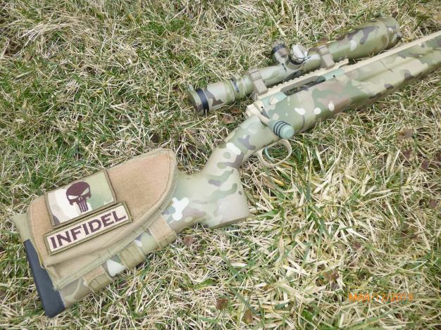

Just finished remaking my Savage Model 10 in 308 into a 243.
Got test loads made up with the Nosler Custom Comp 105's for the range

Here is my little beauty now.
Stock was done by Jim @ South Mountain Aqua Grahics. Great guy to deal with.
Have several more projects that will be dipped by him for sure.

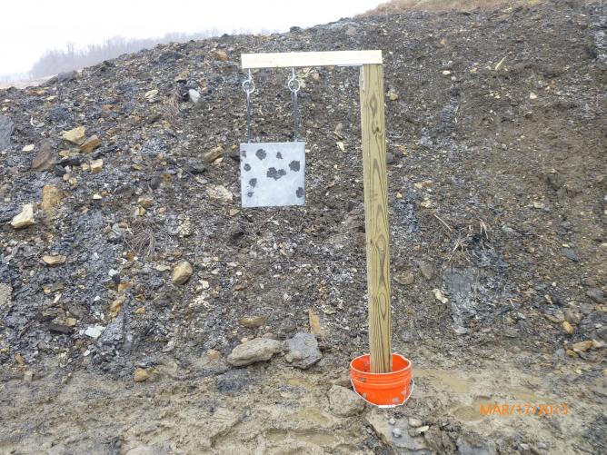

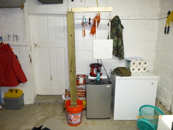

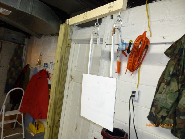

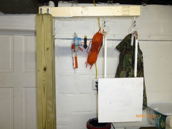

Just finished building a target swinger for shooting at 1k on Sunday.
Plate is 12"x12" with to 1/2" bent sq bars weld to the plate.

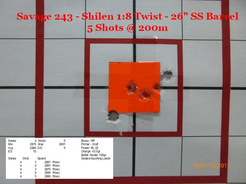

Just got home from the range and now have my first 50 rounds down
the new Shilen Barrel.

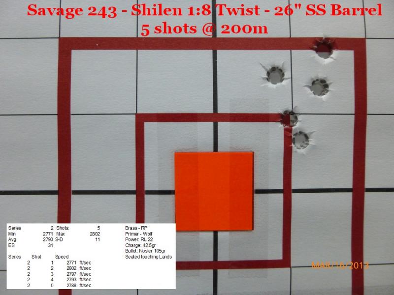

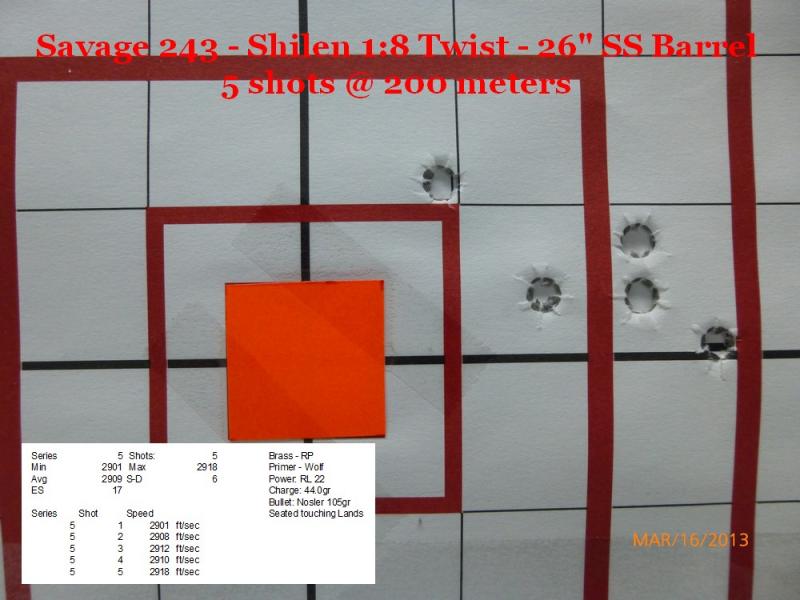

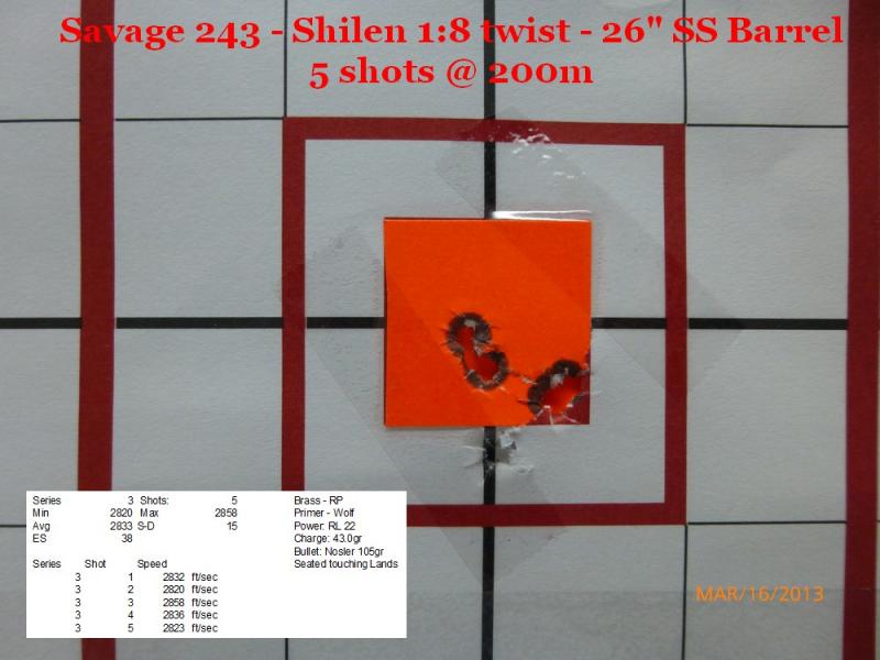

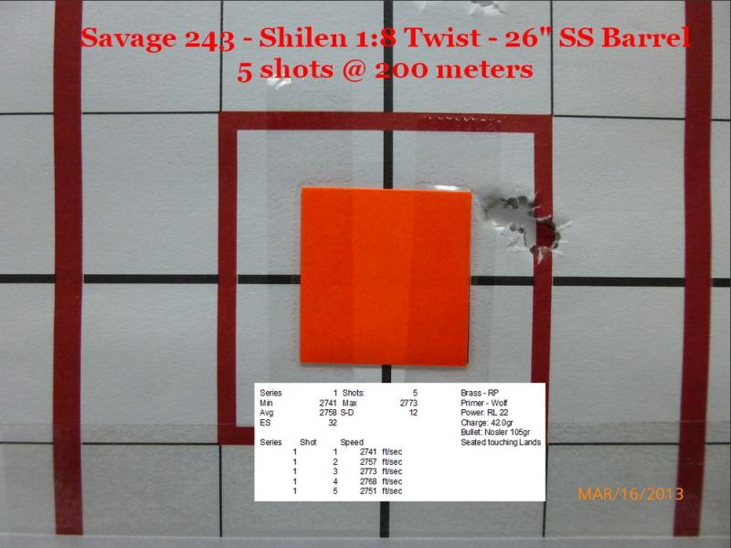

Below are my target results at 200meters. I tyipically do 10rnd targets but
with it being 36 degrees out I only did 5 rounds on targets with the Magnetospeed
Chrono on the gun to get the velocitys, and another target without it on the gun
to see if there was a change in POI. Well as you would think, yes there was
a change in POI.
The 43.0gr looks like the winner as I intend to go 1k with this rifle I want more
velocity. The 42.0gr load shot excellent but at 2758fps I am not happy. When it
warms up into the 70-80's this will all change anyway.
Here are the targets below.
42grRL22_zpsa690e979.jpg 425grRL22_zpsc8d0608e.jpg 43grRL22_zps4c738f63.jpg 435grRL22_zpsc97a58a4.jpg 44grRL22_zpse697c6ea.jpg
Gonna load up 50 more to shoot at 1K. Will post the results tomorrow on that.
Terry

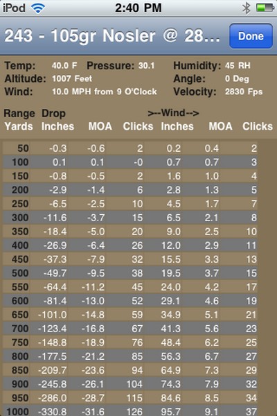

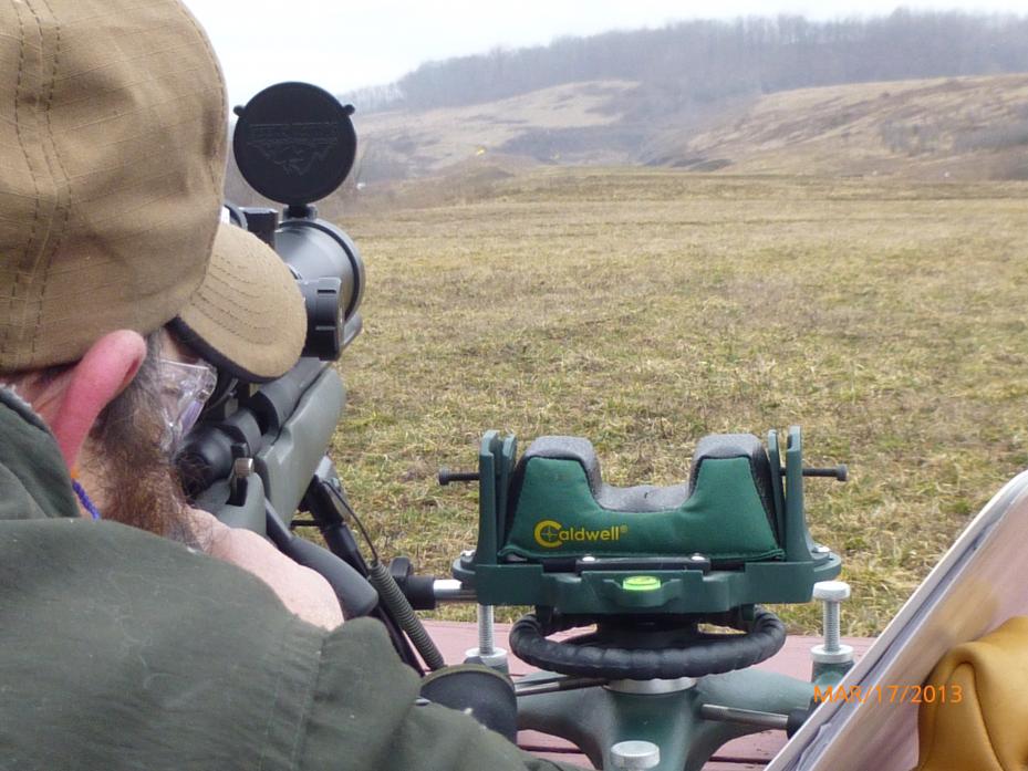

Just got back from the 1K range trip and got to put some rounds on paper at 1000 with the
new 243. Load was RP brass, Wolf LR primers, 43.0gr RL22, with the Nosler 105 Custom Competitions.
Chrono at 2830FPS. Below is the dope card from bullet flight and it checked out to 1000yds.
Dialed 31.5moa on the rifle and fired a 10rnd string a 1000yds with the results shown below.
Here is the steel target swinger I made up and was placed at 800yds.
Pretty happy with the rifle (new barrel) and load. May have shot a better group but with a light snow
going on while shooting it made it difficult at times to get a clear sight picture.
Terry

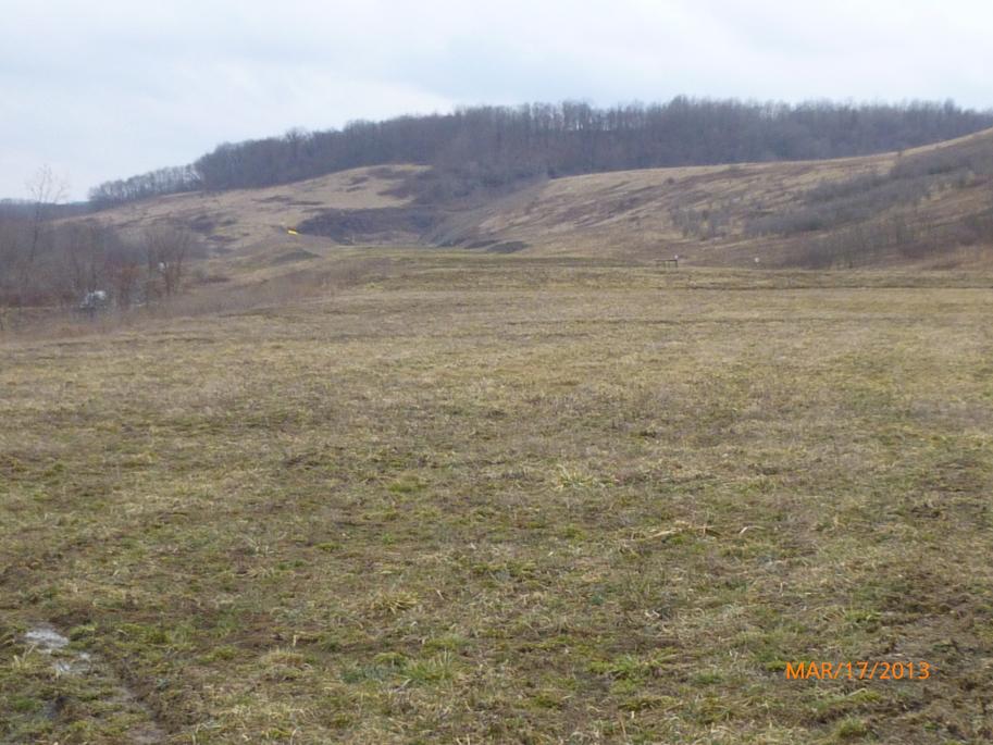

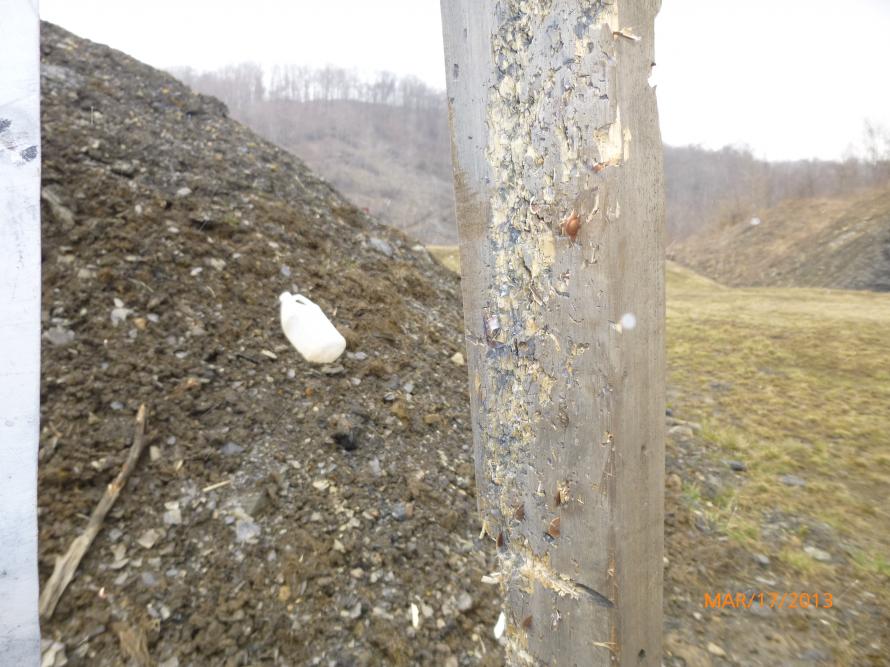

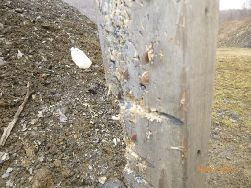

Picts looking down range from the 1000yd line. Also, some pict of the bullet splash
off the plate we had set at 950yds. The 2x4 in the picts was new when we started.
Terry

Nice grouping, hope they work that well in my 6 Creed! I dont see any snow, we got enough the trails are still open, thats unheard of in mid March. Damn snow!!
Yep, Fn Snow. It was like a light mist of really fine shit. Almost made it look hazy when you was shooting at 1K.
Ready for warmer weather and better shooting conditions.
Terry
