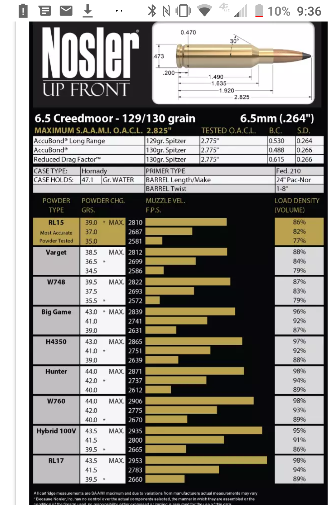

    Gonna use the charge data from my Norma GT 130g pills. I might drop the charge 0.4 grains and work up in 0.2g increments to my current load for safety reasons. Remember folks, only YOU can prevent forest fires.
    COAL is negotiable because the ogive is different and the Nosler load data says their test loads were at 2.775" base to tip. Prime ammo, for reference is also 2.77" base to tip. Per Nosler's info and Prime's info, the BC's, both G7 and G1, are a c-hair better in favor of Nosler. We shall see.

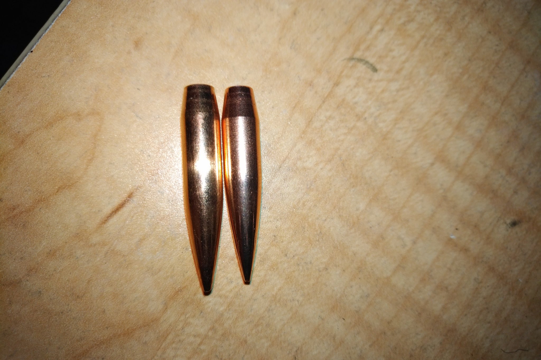

    Nosler meplat on left, Norma GT on the right:
    Nosler RDF 130 right, Norma GT 130 left. Looks like the bearing surface of the Norma is longer.
    Below, Nosler RDF on the right, Norma GT on left. The bearing surface on the Norma is much greater. Thinking aloud: Perhaps with the internal ballistics difference on bearing surface area with the barrel, could that explain why @308pirate would need to push these to 2900+ (120g bullet speed) to get them to group?
    My gears are turning....

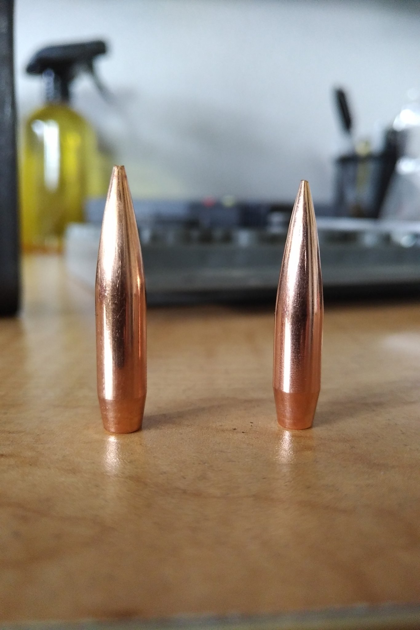

    Sierra 130 TMK left, Nosler Right.... Similar difference in bearing surface difference (Sierra longer bearing surface) ...

    Nosler's data states RE 15 was the "most accurate" powder tested and this goes along with my covfefe brain:
