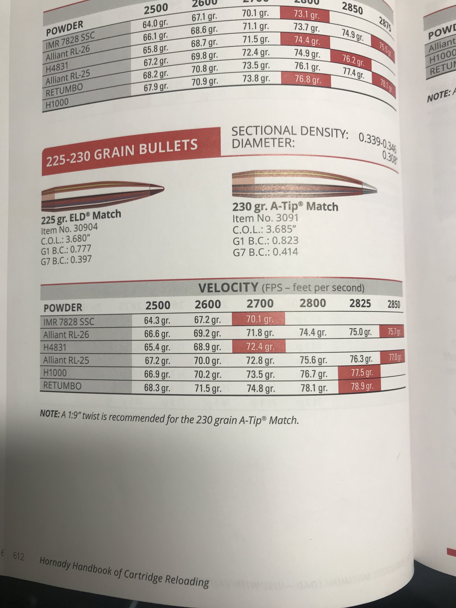

Light as in 1-2g below max would be fine, I usually start 1g below the max charge listed in the reloading manual published by the manufacturer of the bullets im using based on the powder im using.

Ammo is going to be new hornady brass 230 bergers CCI magnum primers and 83gn of ramshot lrt to start. Quick loads says this should be 50kpsi.

And where are you getting the number “60” from? Typical PRC charges across popular powders like H1000 are in the high sixties to low-mid 70s for the PRC with 200-230g bullets, for example (i have no idea what bullets he’s planning on running, just picked that weight range randomly)

He should load 1g below max in current published loading manuals. (Which normally say 10-15% to start). For people….
Thanks for your insight.
The number 60. Was 3/4 of max charge BTW. And still gonna be well over 2400 FPS to get it out of the barrel more than safely….

I was going to start at 75gn. I was advised not to because of flash over.
I have been wildcatting and fireforming for 20 years. I promise loading 3/4 or in this case about 17 grains below max are more than adequate.
60-65 grains is more than safe. And much less than 1g below max……For your test
