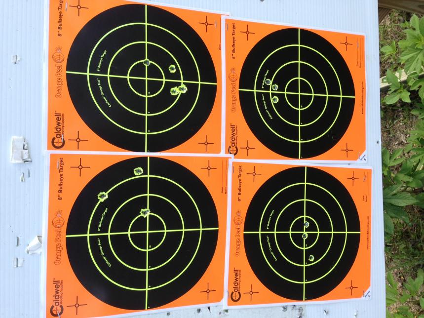

So my question for everyone is this: what can I do to get ~1.0" or smaller groups out of this rifle? The next potential steps in my mind are (1) having the rifle 'accurized' by a gunsmith, (2) replace the barrel with a non-sporting contour, (3) give up, sell the rifle, and start from scratch again with the scope / chassis on a new build.
I've attached two pics of typical groups. All shooting was done with a Caldwell front rest and a sand bag at the rear. I have spent a lot of time practicing good shooting form, dry-firing, etc, and I'd like to believe that I'm not the problem. When I have shot other guy's rifles at the range, I have usually done better than with my own rifle!
The wide-angle shoot-n-c pic is from ~1 month ago at 100 yards in light wind.
The second pic of four individual targets is at 200 yards in 12-15 mph wind. Bottom left group was used for scope / wind adjustment for a new load. The top right group was really nice, but unfortunately is the exception to the rule.

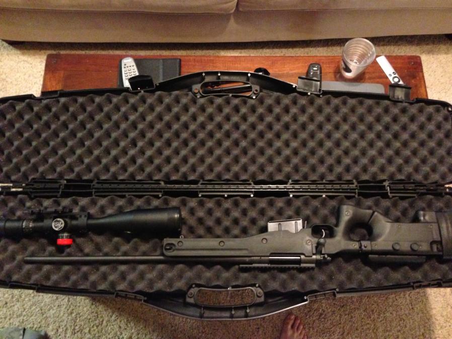

can you post a picture of your rifle? I didn't quite understand if you're using the AICS, NF scope, and Larue mounts?

Here's a pic of the rifle. It has the AICS 2.0 stock, NF scope with Larue 104 mounts.

Don't look at it as one thing over another thing. Shooting at 100 yard targets allows you to see hits and therefore plot shots, without the need for pit service. Plotting calls and shots permits error diagnosis, which accelerates marksmanship development.
Your grouping shows all shots are misplaced. It shows vertical dispersion in two groupings. This sort of error indicates a multitude of shooter errors/problems. You simply may not understand what's actually important to good shooting from what you believe is important.
The surprise is that you are hitting a target at LR. This means your error is mostly linier rather than angular. That's to say, your error is not likely to be associated with inconsistent perspective of aim, but rather, an unstable position creating inconsistent arc of movement and recoil resistance. Some of the possible causes for this sort of error are: varying head pressure on stock, varying butt to shoulder position, poor follow through, and too low a position.
