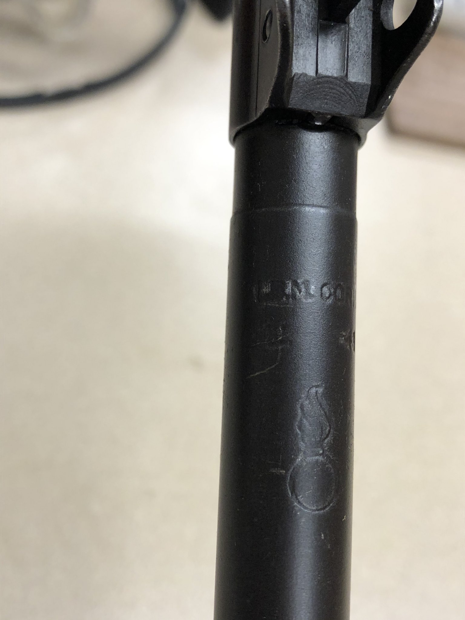

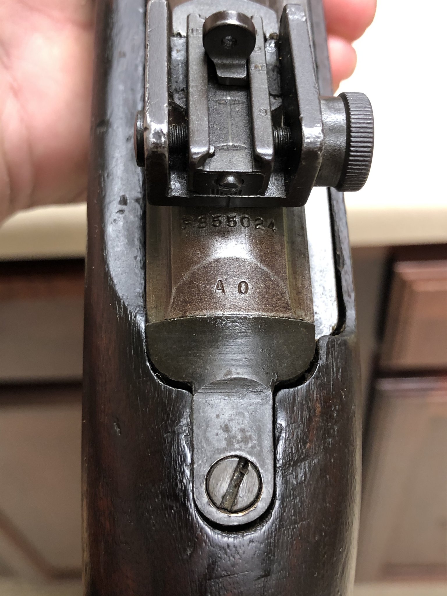

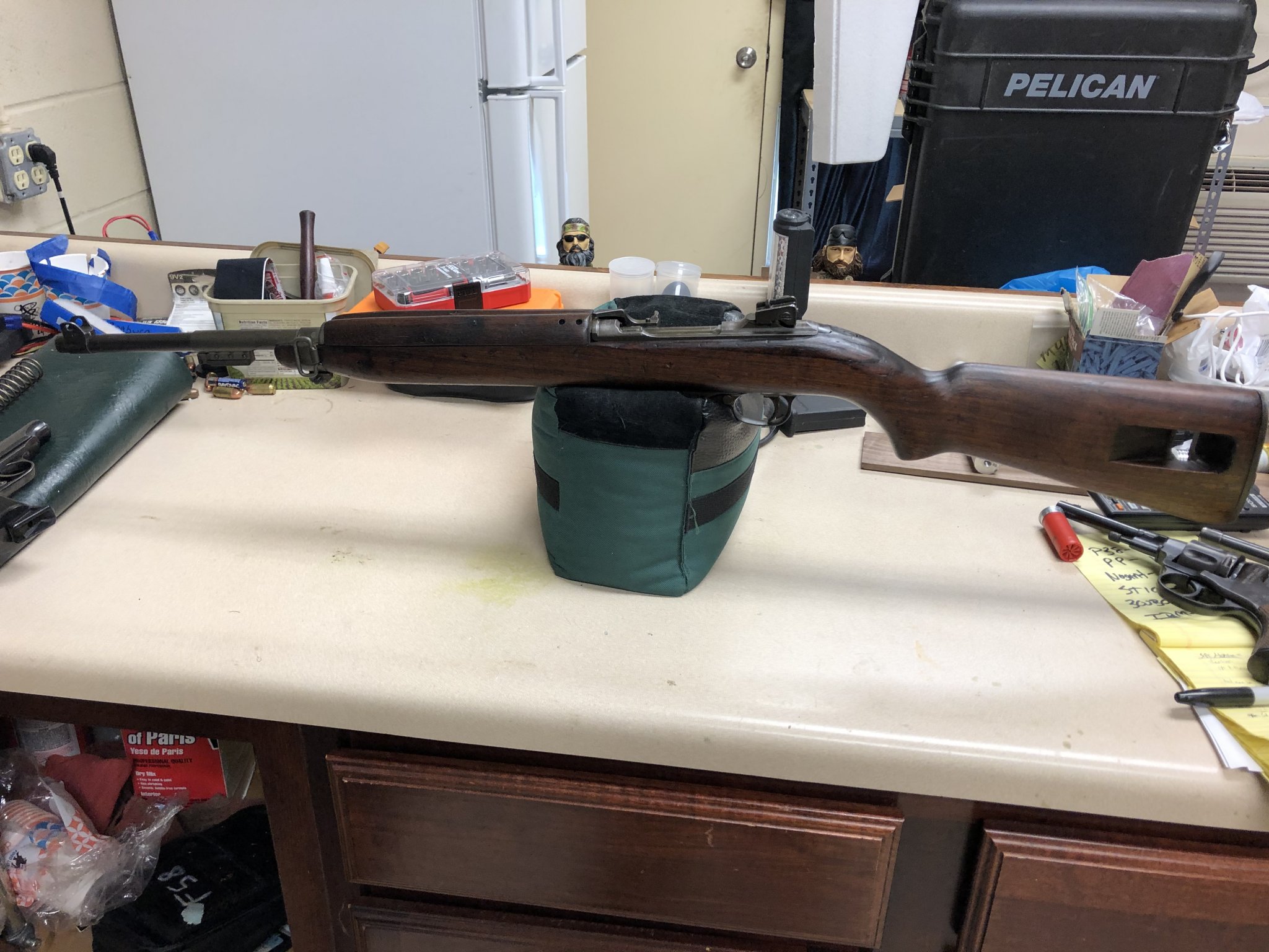

Torn in the middle on this gun. It is an M1 carbine that I have had for years. I have others so losing one would not clear my small gathering of them. It is an IBM/AO production gun. I know IBM only made about 350k carbines with about 50% of those receivers proofed AO. Fairly small number in the grand scheme of things when around 6 million carbines were built in total by all 10 contractors. I also know that AO fanatics love most anything marked AO. What would you do with this carbine, sell or keep.

@Greg Langelius * thanks for the process to refinish. I have done a few but not as in depth as that. I will keep in in mind for a shotgun I am working on though. This carbine however will not be restored. It is a CMP gun so will stay as it came from the rack in Anniston when I bought it 13 years ago.
