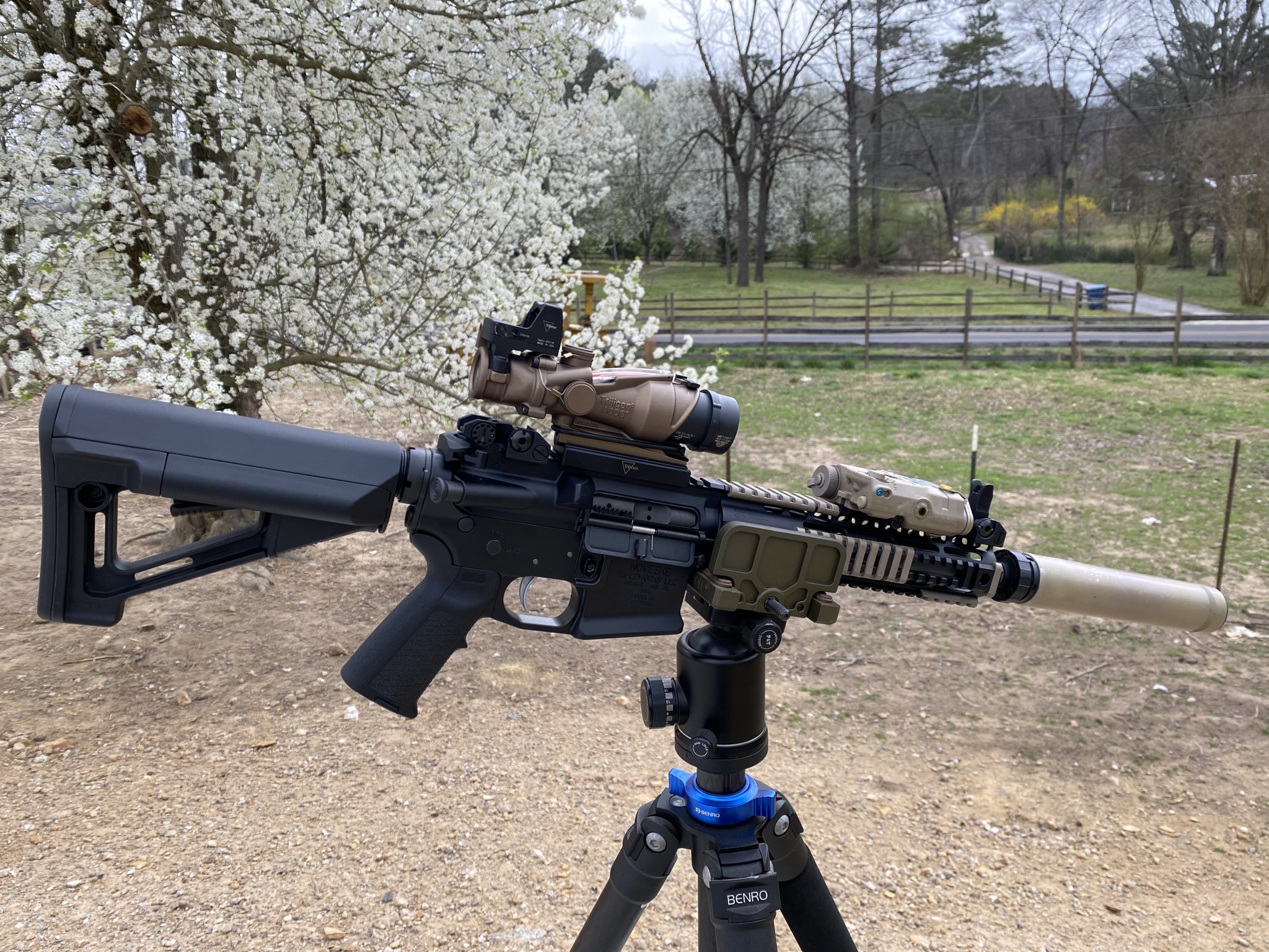

    Got this upper about 3 years ago from a fellow Hider. Popped it on my N4 lower and put a few rounds on it. It seems to run and cycle just fine with both subs and supers, BUT…
    It shreds brass bigtime. After a single mag, the chamber is filled with brass flakes unlike anything I’ve ever seen. Almost like you took a cheese grater to the casings.
    Whaddup?
