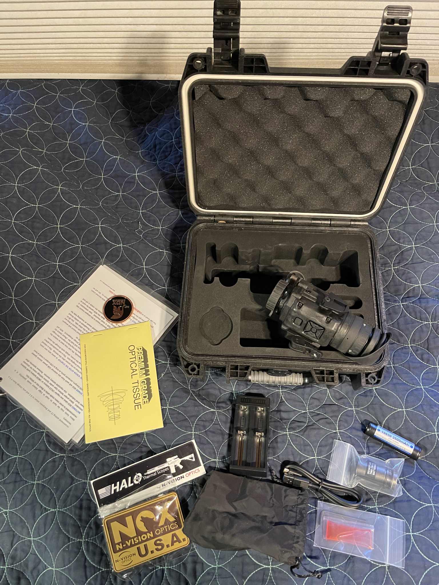

    Toys in the Box
    -Included....a challenge coin buddy! Thermals that don't come with a challenge coin aren't even on my radar anymore. Fuck those cheapskates with no challenge coin in there. To make sure everyone knows you have a challenge coin they might trade you , you have a patch you can wear on your Arcteryx Alpha Jacket.
    -Has a nifty 18650 adapter so you don't get to watch CR123's weep in agony as this thing drains them like a fucking vampire.
    I think my battery life with the 123 was 12 seconds or something. When I opened the battery compartment and smoke didn't pour out I was amazed. The rest of the package of CR123's literally sprouted legs and ran away like cockroaches. They took the package with them.
    Tip -use the USB-C and run an Anker brand battery. I stuff two of these fuckers in a helmet pouch as a counterweight and to have a spare in case anything eats shit. Which is every time. And if I have to, I can toss one as a flash bang grenade. Lithium batteries go up at the slightest provocation it seems.
    -Also has a package with an Allen key and some midget package of fucking terrible anal lube. There wasn't enough of it so it just seemed like everything ground to a halt after a few tosses. No biggie - I have CLP. @Bender - thanks for the pro-tip.
    -And, finally, instructions. I guess. Who reads the directions on something that cost $6200 and probably has about 10 ways you can break it if you don't read the instructions? Poors, that's who. @TheGerman

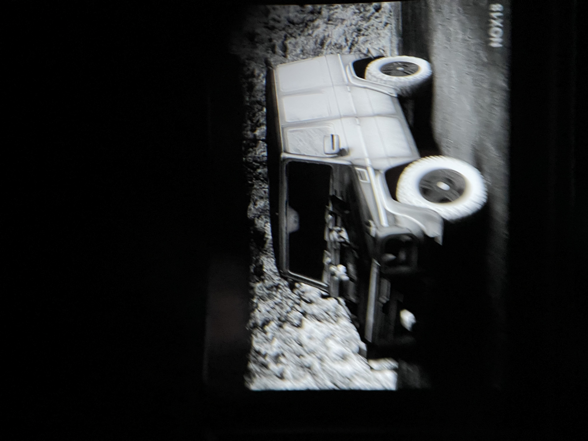

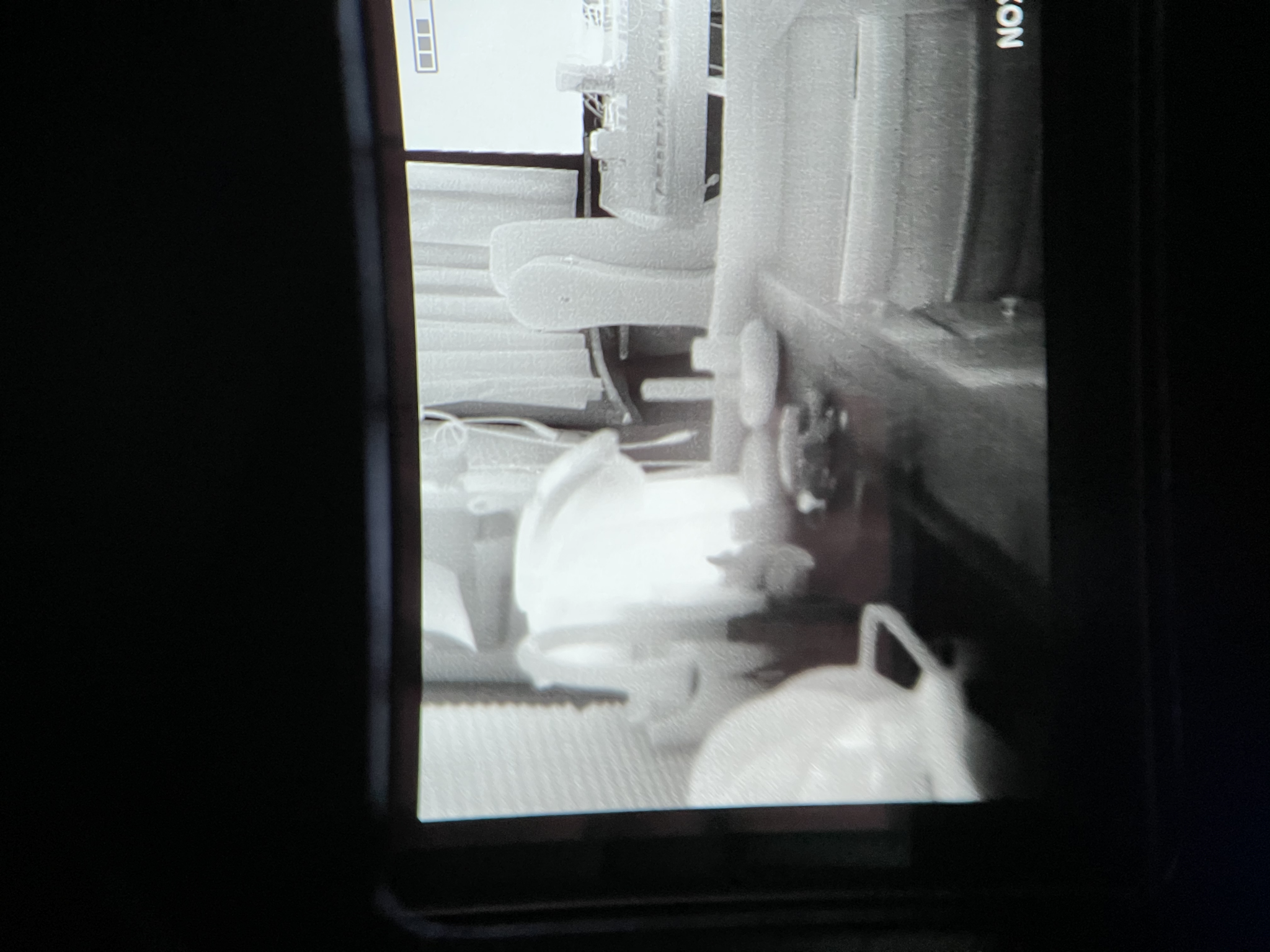

    Indoors

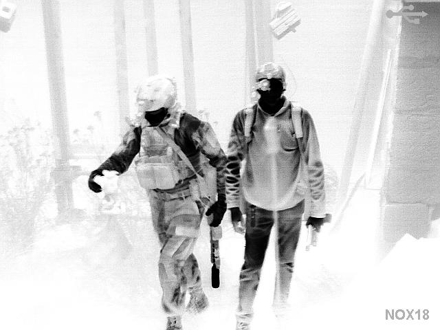

    Typical indoor performance, as expected from a 640 thermal. Perhaps the thing I would note is that the display appears larger than some thermals, like the MH25. See if you can spot the fleeing CR123.

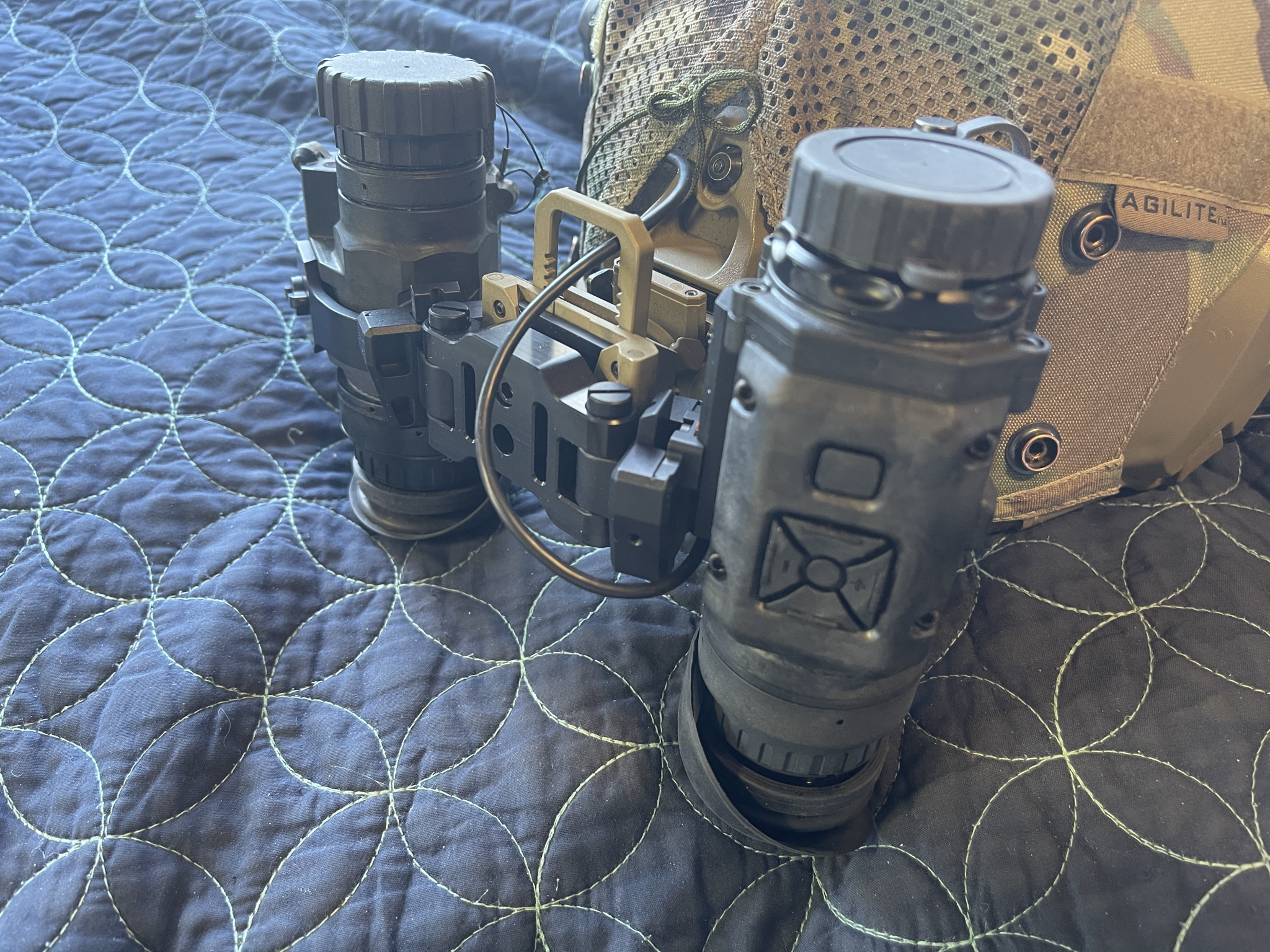

    Helmet Mounted
    Performance helmet mounted is typical. You have to remove the factory mount and flip it over in order to use it left eye. The weight loss is worth it. Same thing with tossing the battery everything and just using a USB-C pack.

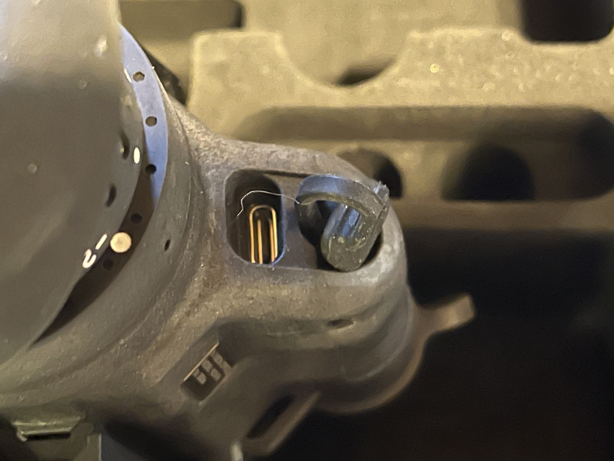

    Additionally, the USB-C connector is well thought out and will probably be VERY tough. I look forward to snapping the end off in the device for once instead of completely buttfucking my expensive thermal. Maybe this is what the lube was for?

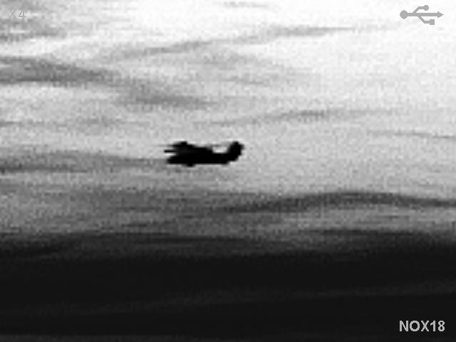

    Outdoors

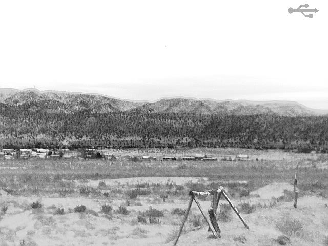

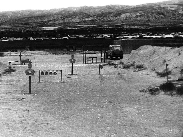

    Outdoors performance is pretty good. I expect to detect a man sized target at maybe 700m. These pictures suck. I took a sideways shot of @TheGerman s ride.

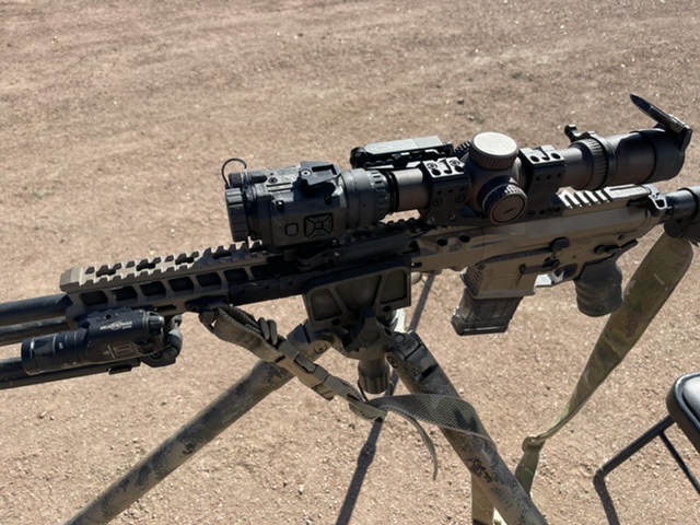

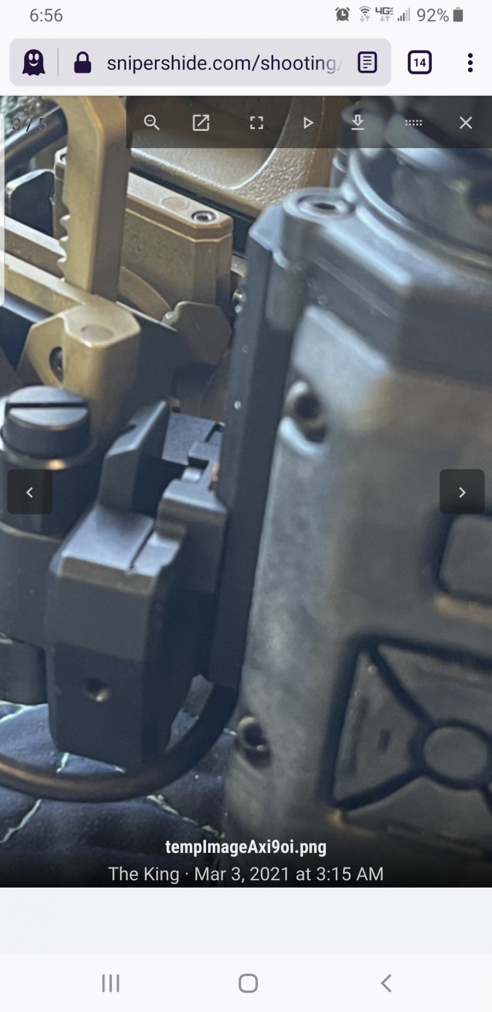

    Is that the factory mount or is it some other mount? I plan on buying a NOX 18 and really want to line up both ocular lenses on the 14 & 18. Curious of your thoughts on this? Am I over thinking it or does it really matter all that much?
    You take the shoe off of the first side of the NOX and move it to the other side. But you lose the factory ADM mount when you do it. So no popping it onto a rifle.
    Its more an OCD type thing than it is a practical issue. They don't exactly line up - but its 1/8th of an inch or so and you have way more aligning slop in the optical assemblies themselves when you have the right eye relief.
    To further the point, I have run other thermals like the FLIR Breach that were much more unforgiving ass end optics AND further out of alignment and it was fine.
    Where people really have issues is every brain is different regarding how it tolerates seeing two different things at the same time. I theorize that some folks have their eyes try to cross-focus themselves causing a headache.
    This can be dealt with some by closing one eye and opening the other really fast when you are setting up your rig - if one eye is out of focus turn your ocular until both units stay in focus. But that doesn't always work.
    I seem to get about 60pct of people that try it being fine and 40pct are about to fall over.
    I'm working on a test that people can try that might confirm my suspicions. Close one eye and start blinking the other one. Do this for both eyes. I suspect that if your other eye tries to keep opening (more than 1/4 of the time), you may have issues. If you can't close just one eyelid then thats even worse...
    Results still pending.

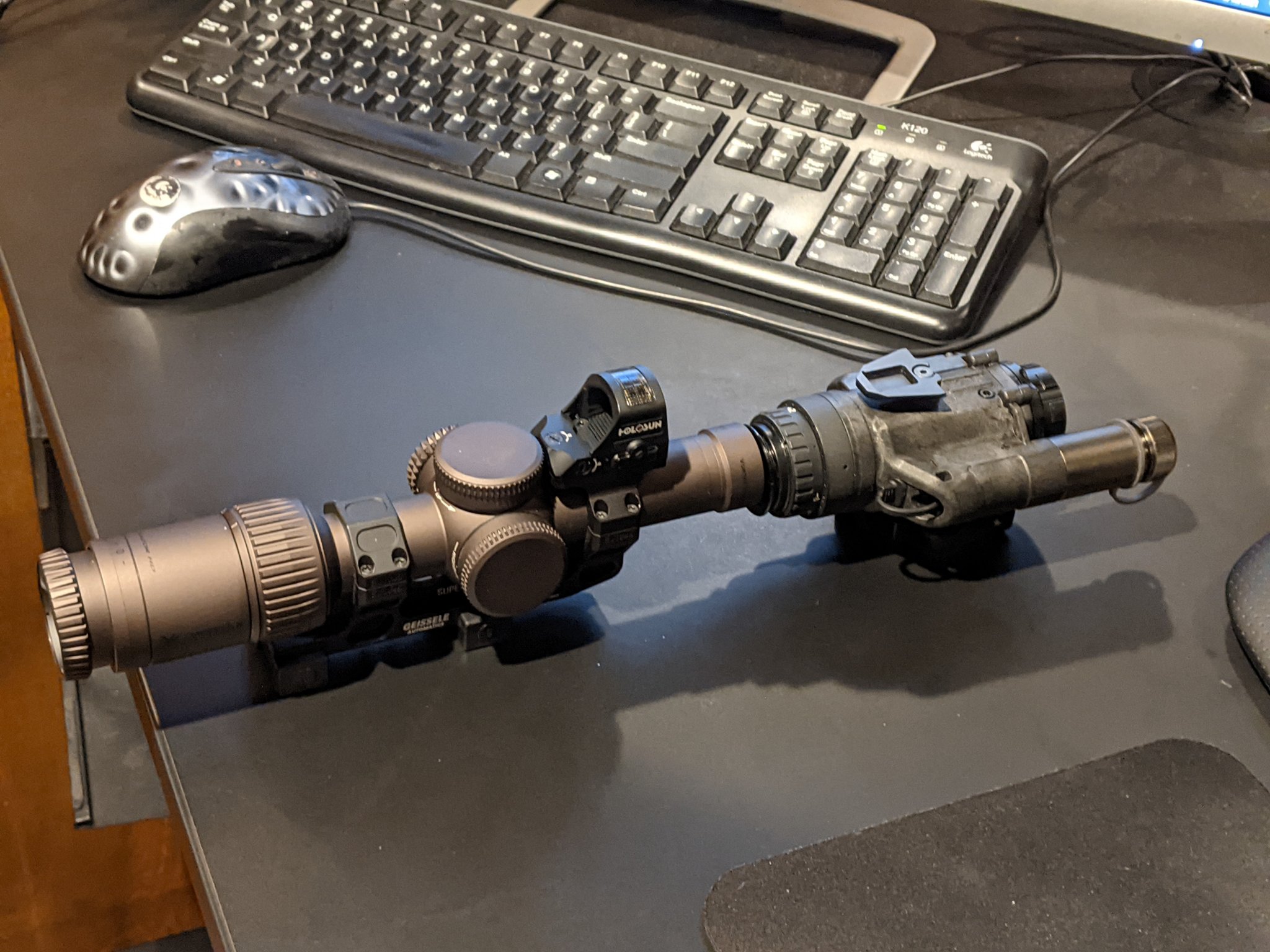

    Seems to be clear up to 3.5x but too bad the POA shifts with and without the nox-18 in front. Maybe I can still use the digital cross hairs on the thermal. Will try and report back tomorrow.
    Had the same results - it was going to make a good clip on for my use.
    Except when I mounted mine on the rail it didn’t even point at the same state as the scope did. The first round out of the thermal/vortex 1-10 setup was 12 foot left and 6 feet low at 25 yards.
    Huh - now that I typed that maybe my unit wouldn’t be usable as a rifle scope. will the reticle zero out 12ft of off center?
    12ft off at what distance? Probably all depends on consistency and rigidity of your rail system. If very solid (like a SCAR or LMT MWS), I imagine return to zero could be pretty decent and you could ignore your scope’s reticle and just use the built in one...
    25 yards. The rail is the factory Radian M1 rail. It’s very stiff.
    My issue is my unit is far off to the left when mounted so it’s a thing. Prevents me from clipping it on. My Q fix rifle did it too. You can even see how far off it is though the optic - the edge of the day optic fov cuts the screen on the right corner something fierce.

    And you haven’t tried zeroing it in it’s standalone capacity? I imagine if it’s still that far off they’d take care of you under warranty pretty quick.

    I believe the reticle on the nox would need to be sighted and used. The scope would turn into a magnifier.

    Guess I’m missing something here. Why not just switch it and keep it mounted as is? Why do you have to mount the dovetail on the other side?
    I believe it is a control issue. Buttons are on the left side when mounted as is. Battery compartment is on the right side and would interfere with the bridge is prob the big one.
    For me it’s a primary eye issue. My Nv compatible weapon sights are on the gun, and I’m a righty.
    Can’t use those with a thermal.
    So I want the unit on the left, and swap it over.
    Ok, thanks.
    if it’s just a control issue I’d almost rather flip the optic up to manipulate the buttons than lose the mount, but the battery structure interfering with the PVS or mount makes sense.
    Ideally I’d like to have the thermal over the left eye, but retain the ability to weapon mount if needed. Doesn’t look like that’ll be the case. Wonder if it would with a different bridge like the Wilcox or Knight? I do like how the Wilcox has an intra-ocular adjustment. I have some time using anvis and the slightest misalignment in the optics drives me crazy.
    Edit: After looking at the photos the buttons are still inboard when mounted on the left side, guess it has to be the battery?
    ... Wonder if it would with a different bridge like the Wilcox or Knight? I do like how the Wilcox has an intra-ocular adjustment...
    Using a different mount is not going to change things. In this case, the distance between eyes is a defining factor. In other words, for comfortable viewing, the distance between optical axis of the NOX and PVS-14 has to be fixed and equal to the distance between centers of your eye pupils. I hope this makes sense.
