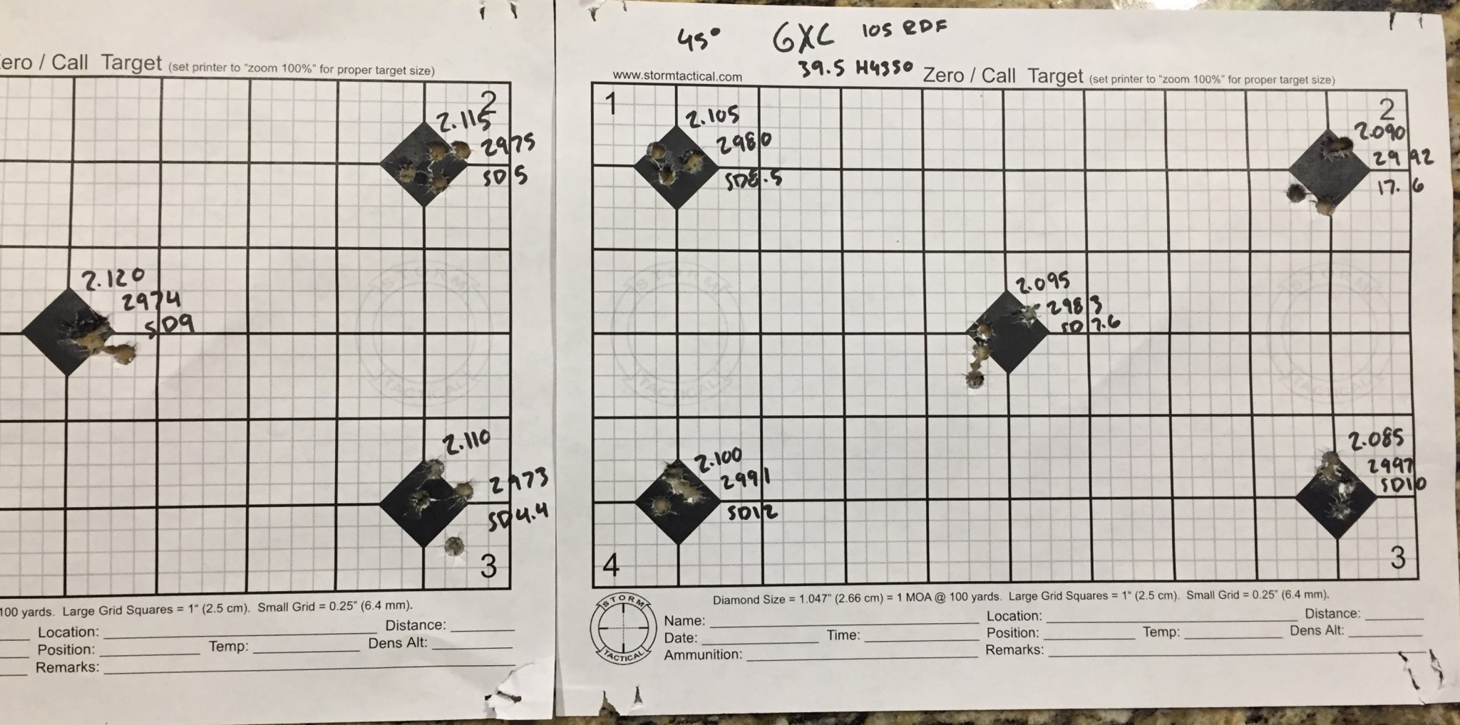

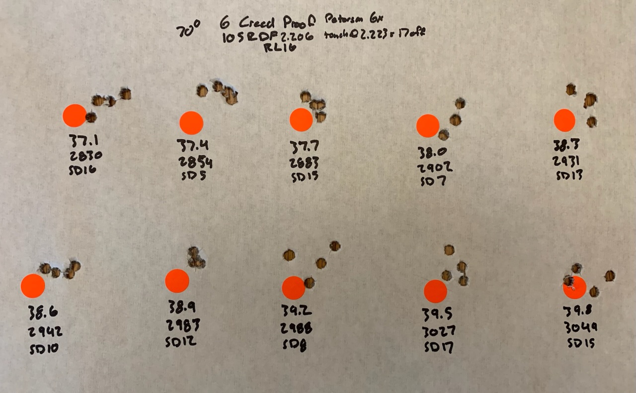

Yeah, my 26” 6xc with Norma and petterson brass and 39.5 gr of rl16 made a 105 rdf go a hair shy of 3k. My 26” 6creed with Peterson brass and 39.4 of rl16 is making a 105 rdf go a hair over 3k.
