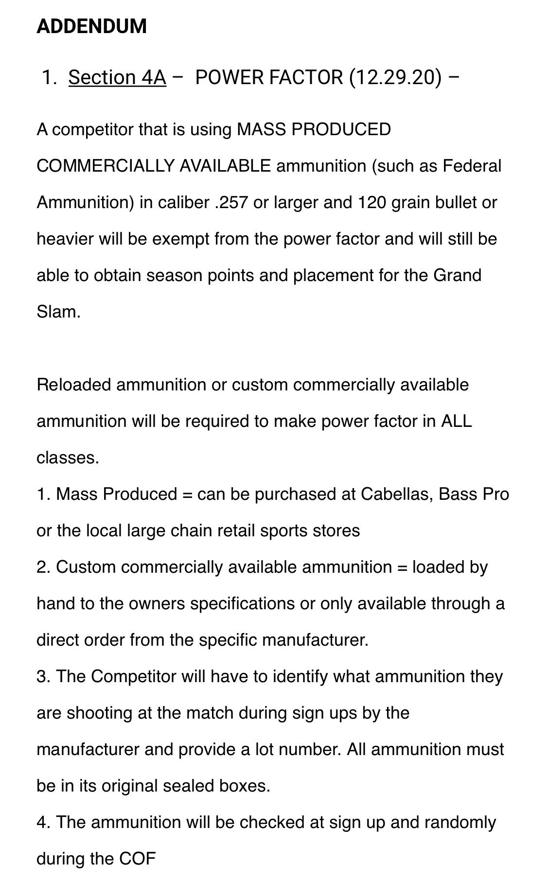

You can get another 50-70 FPS out of a 260 vs a creedmoor from what I’ve read when handloading 🤷🏻‍♂️
If you want 6.5 creed, go that route. You can always shoot factory ammo at a match if you end up not meeting power factor with handloads.
I didn't realize that factory ammo makes it where you don't have to go by the power factor. Good to know.
