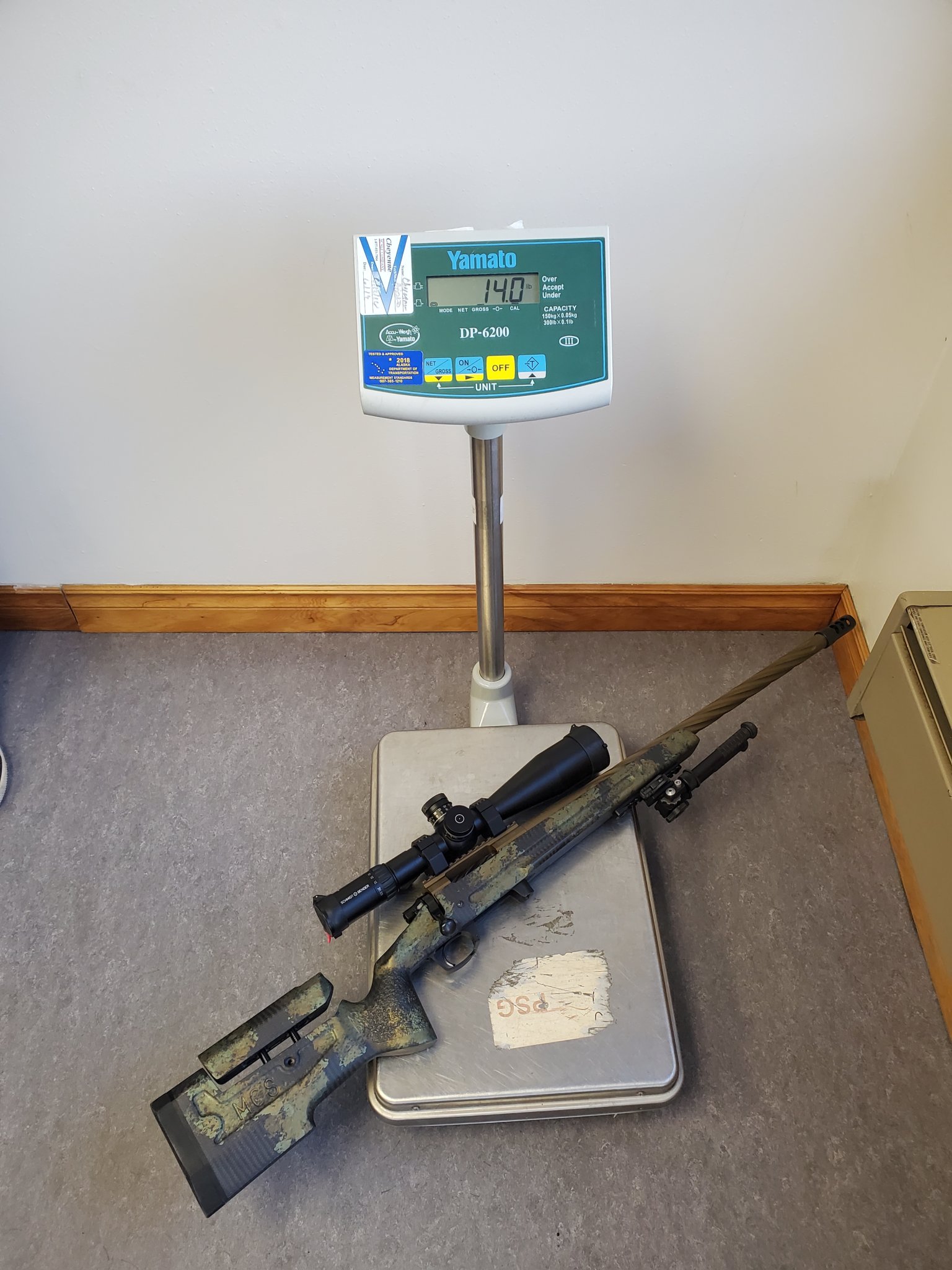

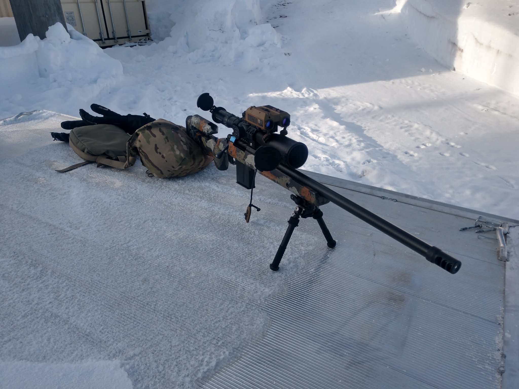

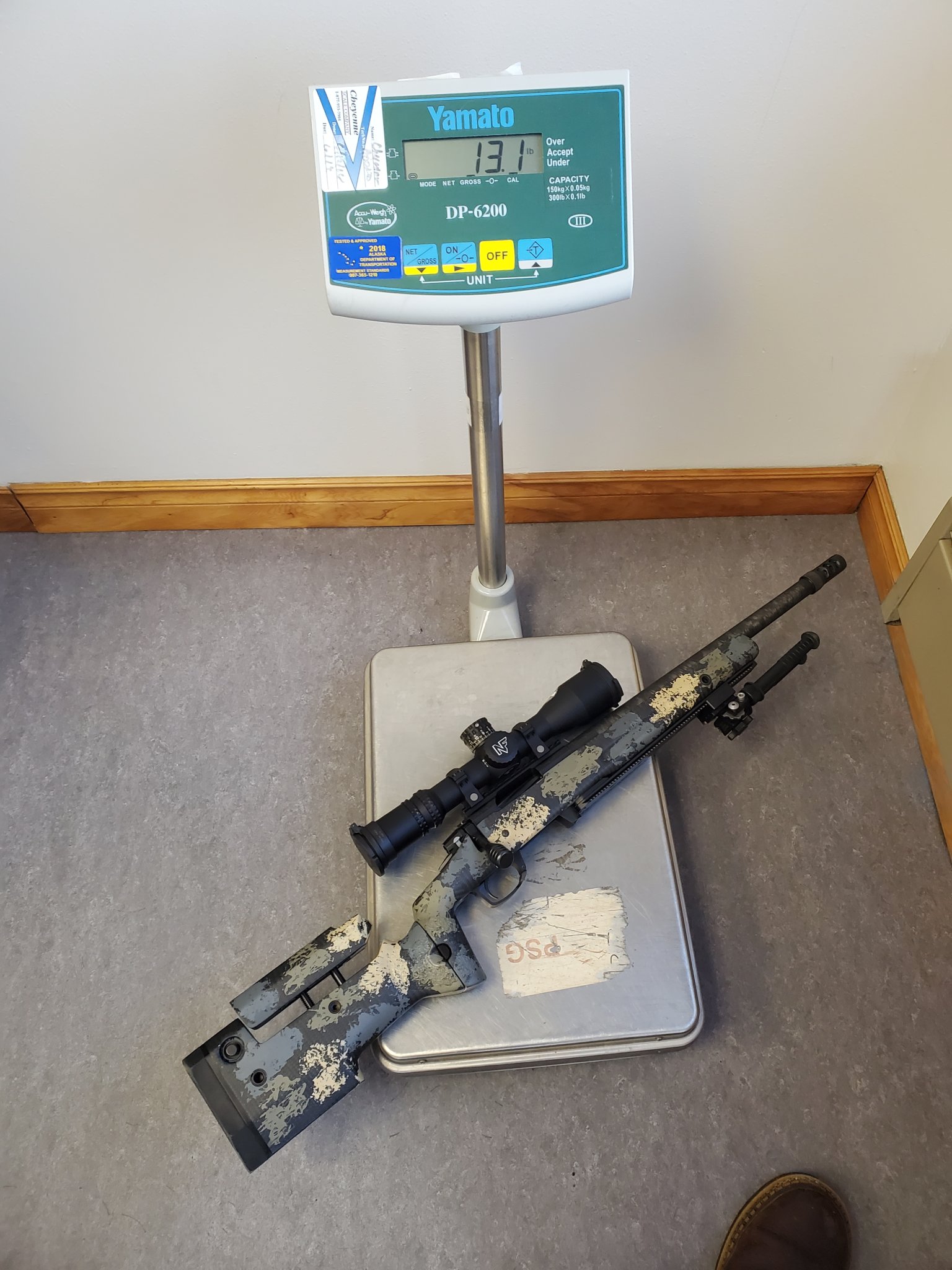

I have 2 rifles set up for NRL Hunter with hopes it actually will get close enough to Texas to make it work with the PRS 2 day matches I already shoot. If not I will just keep shooting fuzzy critters with them.

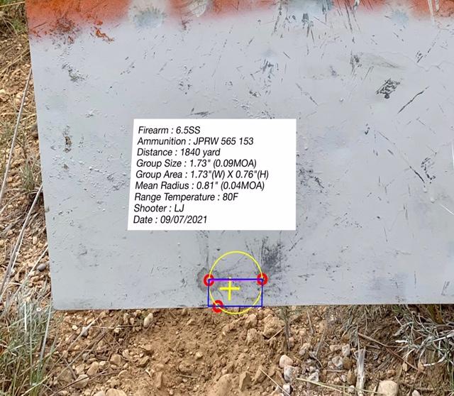

6.5CM running 135 ATIPs at high 2800s with a 23" barrel under 12#s
6.5 SST II running 140 Bergers at high 2900s with a 21" barrel under 16#s

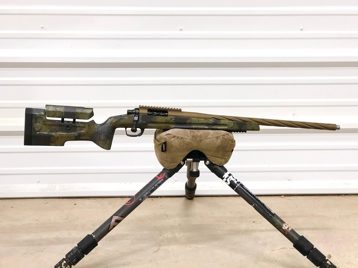

6.5 SST is a Bartlien carbon M24
6.5 CM Is a steel M24 picture below LRI removed a little weight

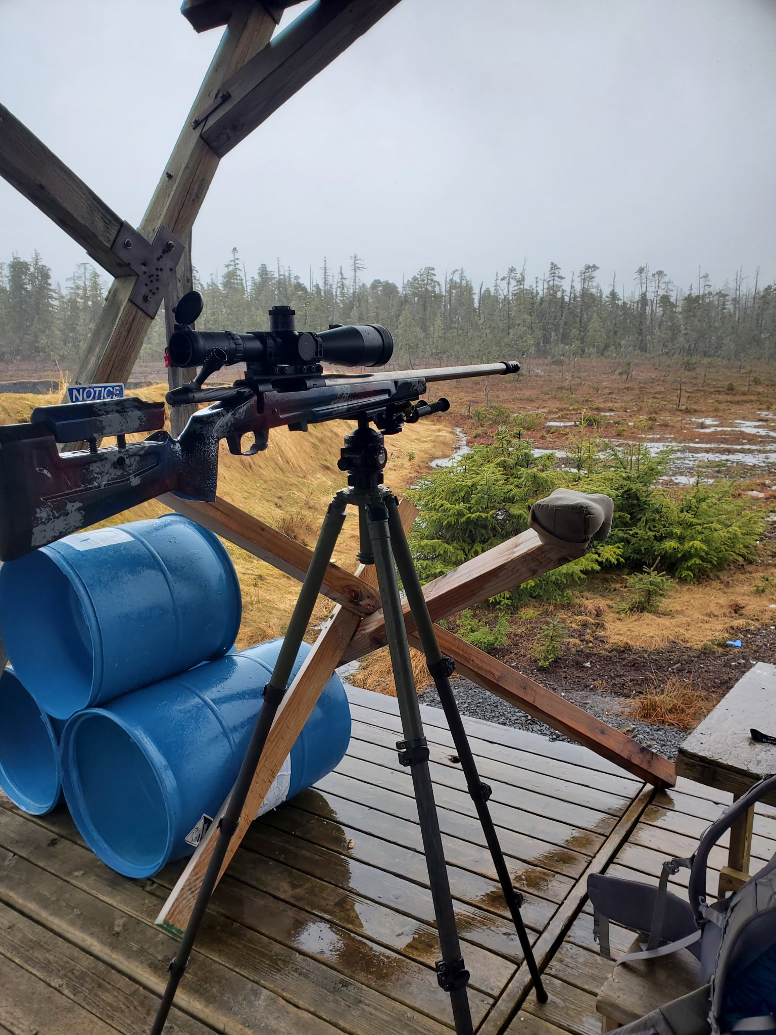

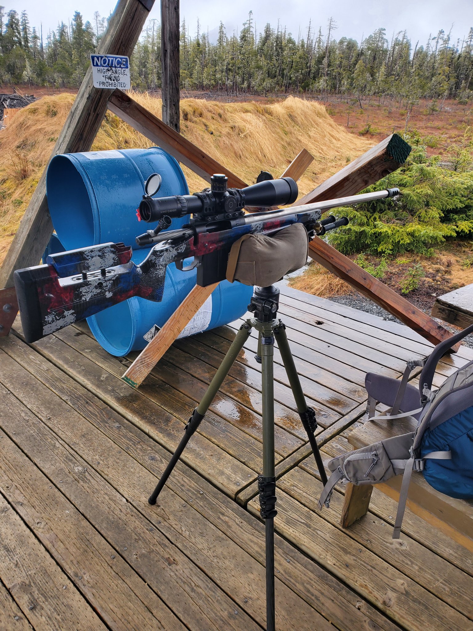

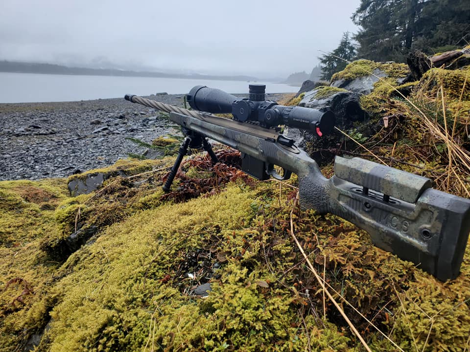

This is the gun I am looking at trying my hand at NRL Hunter with. It is a 6.5 Creedmoor chambered by Alpha Omega. It is a Hawk Hill Heavy Palma with heavy fluting. No idea what it weighs yet, but is fairly light . I need to actually get out and shoot this one, it only has like 60 rounds on it, need to finish breaking it in so I can do load development on it. Guesses on what it weighs??
This is the gun I am looking at trying my hand at NRL Hunter with. It is a 6.5 Creedmoor chambered by Alpha Omega. It is a Hawk Hill Heavy Palma with heavy fluting. No idea what it weighs yet, but is fairly light . I need to actually get out and shoot this one, it only has like 60 rounds on it, need to finish breaking it in so I can do load development on it. Guesses on what it weighs?? View attachment 7733017View attachment 7733016
You wont be under 12#. With that S&B on it I'm going to guess around 17#s. You would need to get it under 16.
BTW Caleb is a good dude. He does the barrel work for my PRS rifles and also did the chambering and muzzle for my gun pictures above. That Altus salt flats camo on the Manners is one of my favorites!
As crazy as it sounds, I think it is lighter then that. Caleb is a great dude... he has built me a few rifles, and let me shoot GAP Grind with him this year.

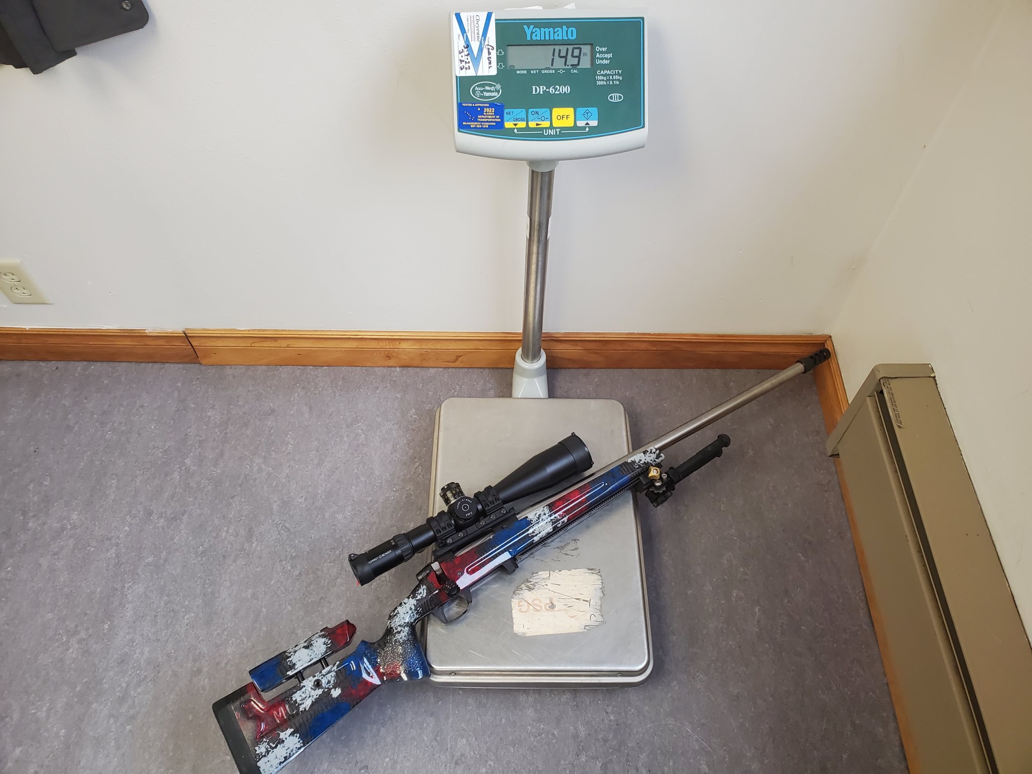

SonI just stood on the scale and weighed myself with and without the rifle and the rifle by itself. And as crazy as itnsounds it is about 14lbs or so. I will weigh it on the scale at the airport tomorrow to get a accurate weight.
I also have another 6.5 Creed he built me that is a shorty so velocity would likely be short of power factor or on the edge.
OK, I know who you are now. I was there as well. I'd surprised if it will fit under 16#s. Remember everything has to be on the gun when weighed... everything.

And I weighed both rifles this morning.
Surprised the shorty was that heavy, but I know folders are heavier.

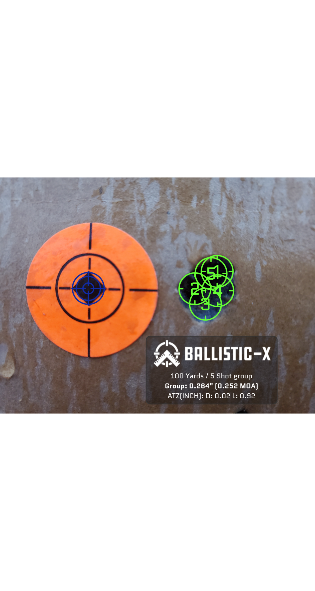

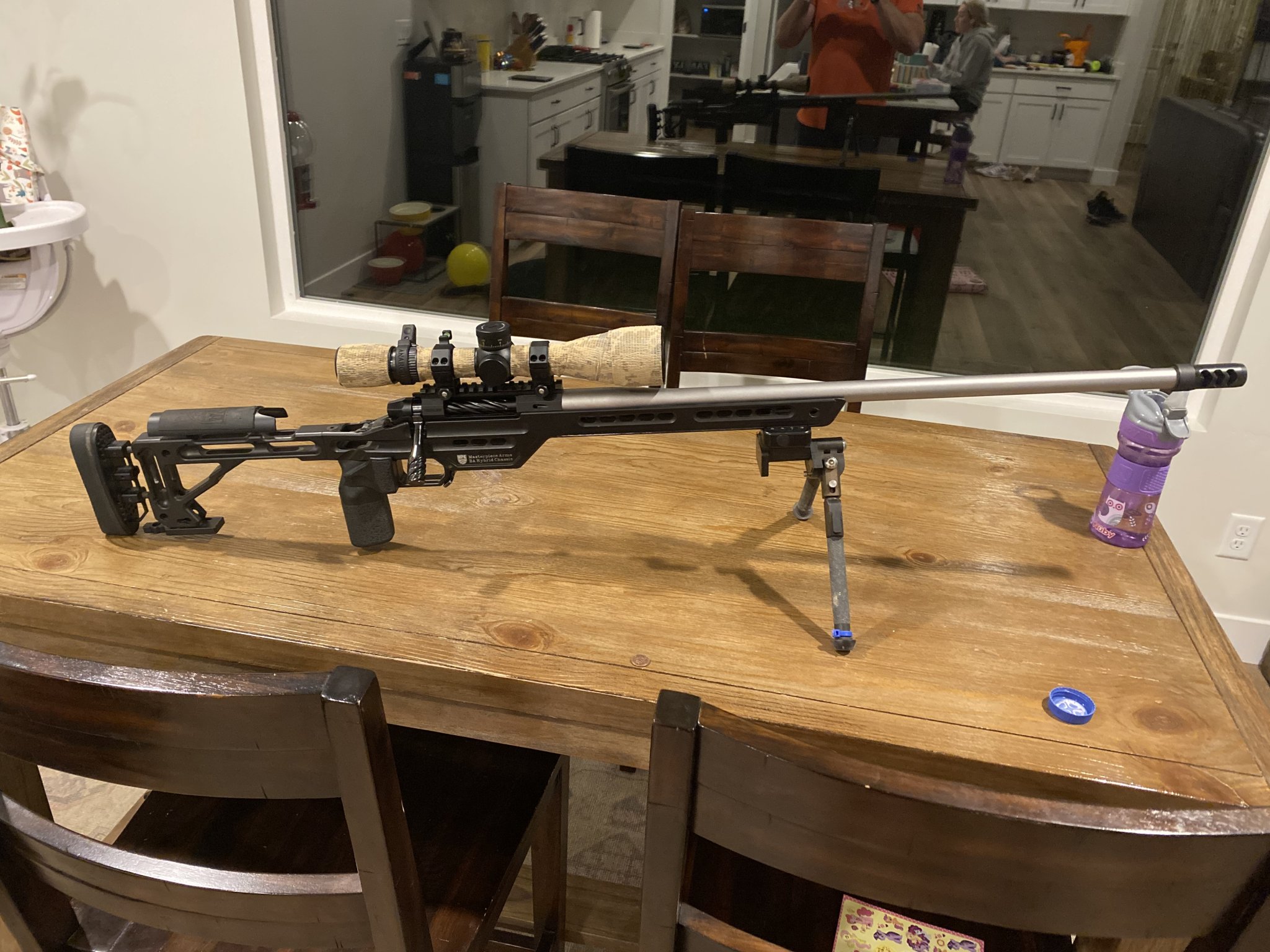

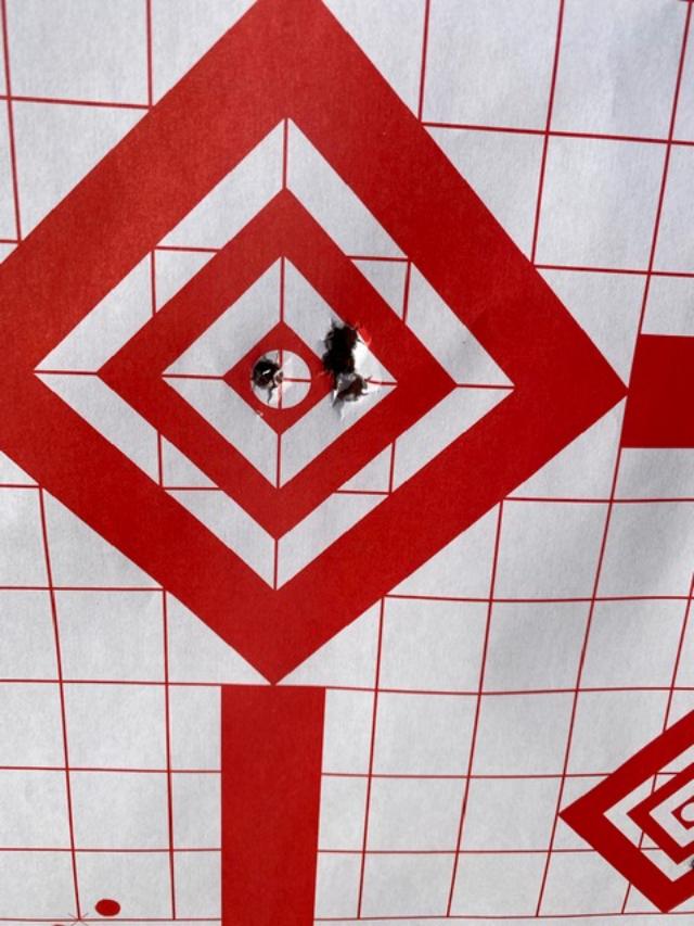

Well after doing some load development for the 24" 14lb gun I am happy with it. I settled on the lower node with a speed of 2750fps with 147 ELDMs in Lapua brass. It has a super low single digit SD and is accurate even seated to the same seating depth of the factory 147gr ELDM.
Ballistic-X-Export-2021-11-16 14:05:25.515160.png
It will work for now, I'm sure it has more accuracy in it, with some seating depth changes. But I am not sure there is point to it.

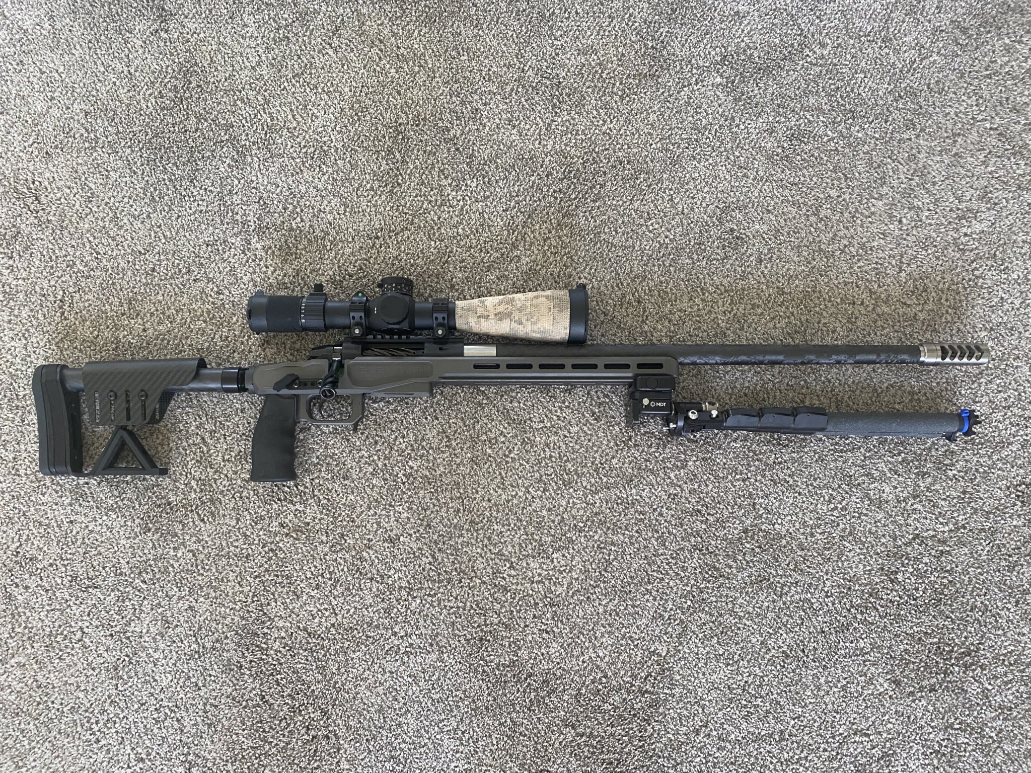

Got everything put together, and on my scale it weights 13.9 lbs but I’ll verify it on another scale just to be sure. Going to take it out this week and see how it shoots. Full build is as follows;
Falkor 7even action
Preferred barrel blanks medium Palma barrel at 26”
Area 419 hellfire brake
MPA hybrid chassis which I plan to add internal weights to get it closer to 15.5 lbs
Triggertech diamond 2 stage
Hawkins ultralite rings
Vortex lht 4.5-22
My coyote setup currently, but I'm going to run a TL3 and proof carbon fiber barrel, HNT26 chassis and the new vortex 4.5-22x (21oz) scope. I should be down around 10.5/11lbs with bipod. I'm aiming for light open class. Once I get the scope I can put it on and get the actual weight

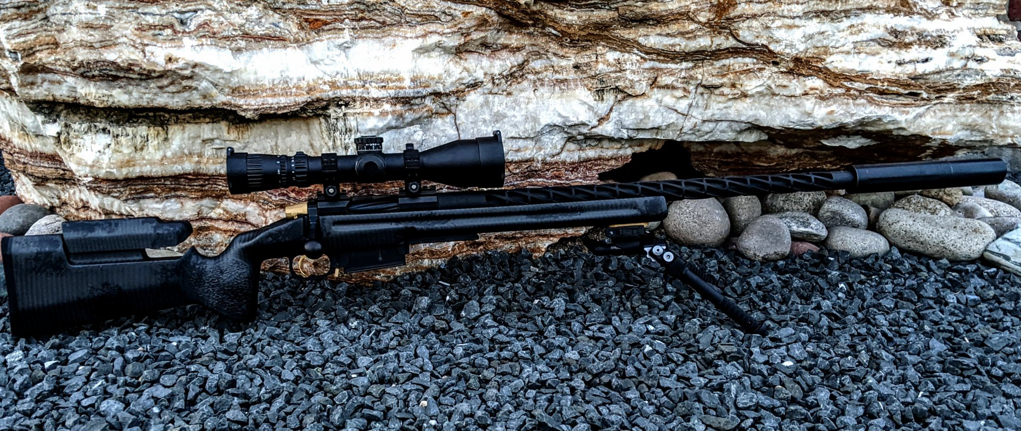

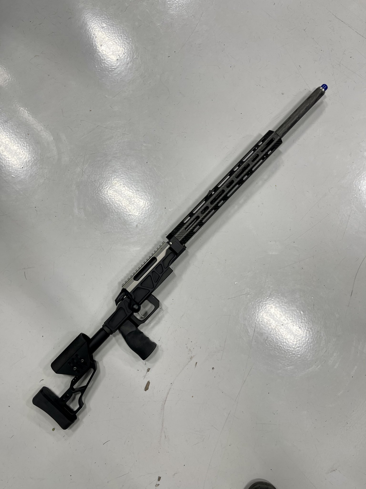

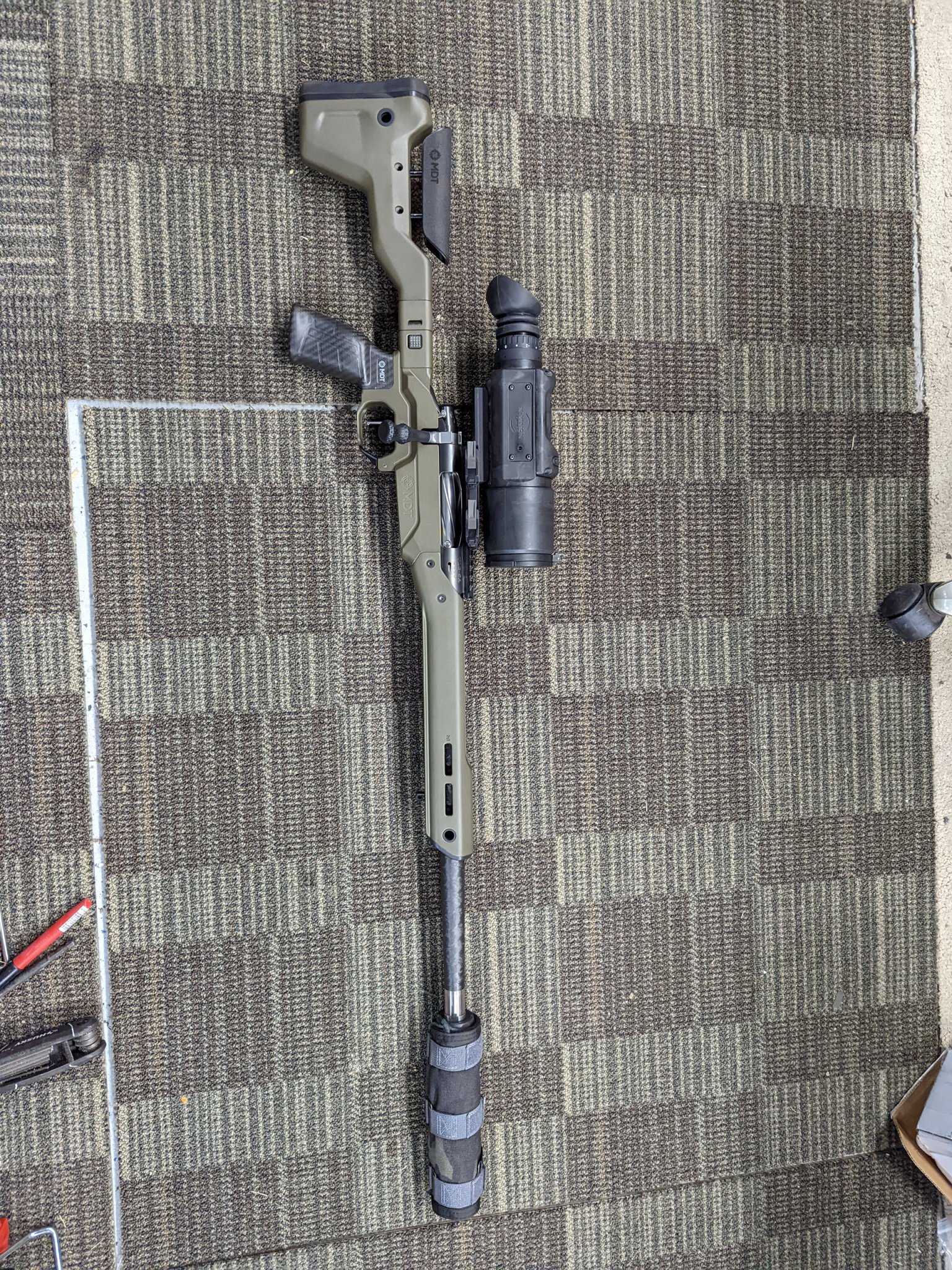

I decided to go old school XLR with this build. Tikka CTR action, carbon chassis, and XCal carbon .25 barrel. Just mocked up here, still waiting on the blank and some other odds and ends.
Weighs in just under 16lbs with TBAC 338, Ckyepod double pull, and FDN17x.
Reactions: Bigrederic
Well I’ll update on mine. I’ve pulled the internal weights, swapped to a triple pull ckye pod and cerakoted the chassis green for stealth reasons. Still running a Burris XTR3 3-18, Falkor 7even action, TT diamond 2 stage and preferred barrel blanks 6.5 creed barrel. Loving this setup and is quickly becoming one of my favorite rifles to shoot
Edit: pic added
