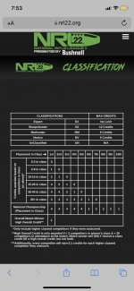

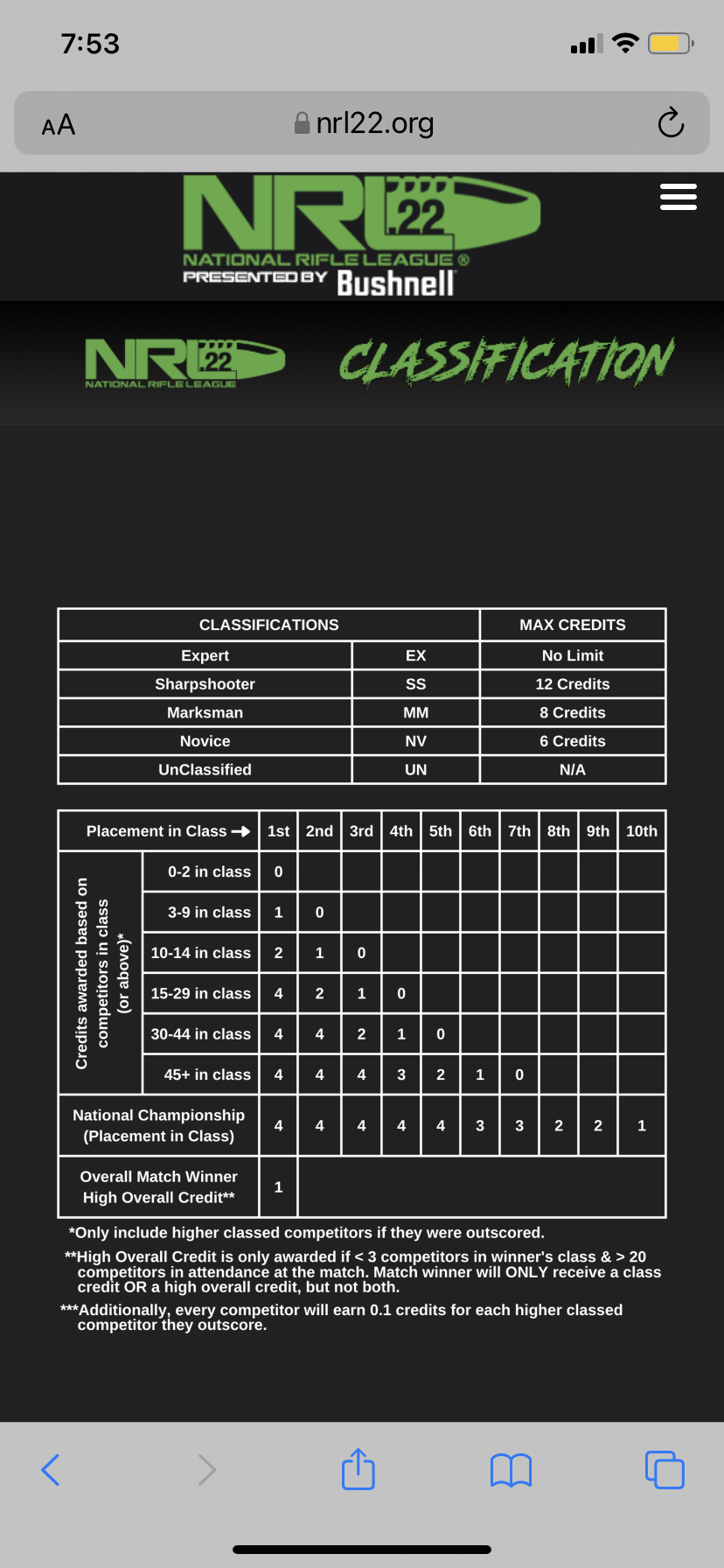

Isn’t there a new classification based on performance instead of gear cost? So you compete against novices if you are new etc….
Classification is separate from Divisions. Base is still capped at $1300 for the 2024 season.
From the 2024 Rulebook:
  1. Any match hosted within the NRL22’s umbrella of events has four classifications – Novice, Marksman, Sharpshooter, and Expert. Classifications are based on experience, participation, and skill. Classifications are intended to allow competitors to grow and track their progress through the sport. All competitors will be classified and classed up based on participation and performance at any match within the NRL22 umbrella of events that is submitted for score. NRL22 will display classification levels for all members.
  2. Classifications will carry over from one season to the next. Throughout the season, competitors will continue to earn credits towards classing up to the next classification level. All competitors and their historical performance at NRL22 events will be assessed to properly classify new members as well as properly award current members for credits earned against non-member competitors. From time to time, skilled competitors with a lack of historical precedence in NRL22 events will be classed lower than expected however, the system is designed to allow these competitors to quickly ascend up into their proper classification.

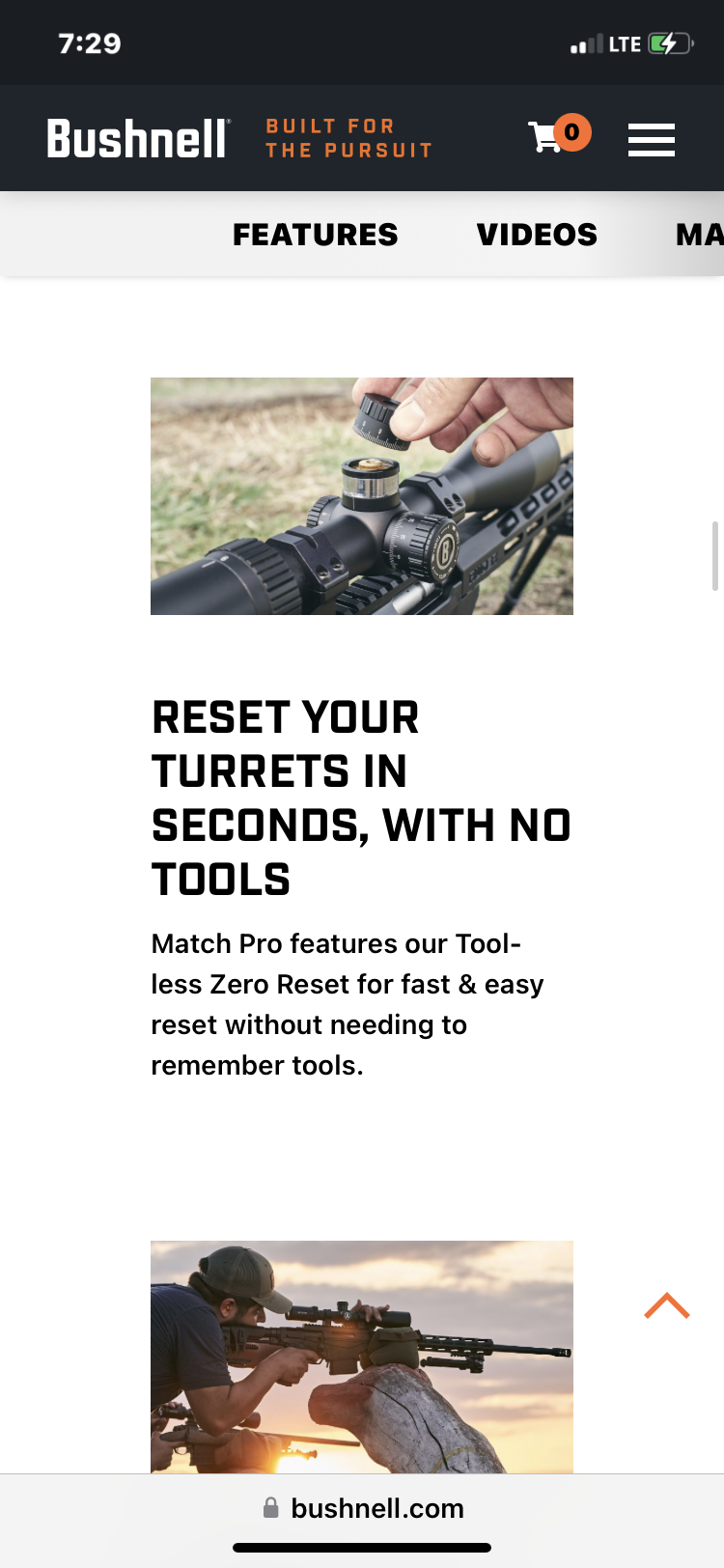

I was super confused about Bushnell because half reviews say it doesn’t have zero stop and the other half say it does. So, I called Bushnell to ask and they confirmed that the Match Pro DOES have zero stop. Which is making me seriously consider it.
My only hesitation is it retails at $399 and with a budget like $681, I don’t want to under buy…
Any advice for another person in the same damn situation is VERY appreciated!!!
A guy in a match this weekend was shooting a stock Tikka T1X and a Vortex Diamond Back Tactical (MOA). He put an Area 419 Arca rail on the stock and had a cheek pad on it. He hit 94 of 109 possible (7th of 32)
His son was shooting a Tikka T1X in a chassis (not sure of optic) and hit 105 of 109 (1st overall)
They both regularly finish in the top 5 of the monthly NRL matches which usually have 50+ shooters.
They both lot tested Eley ammo, found some that works and bought a bunch.
You don't need a Vudoo to win or do well.
So, I posted earlier that a rep from Bushnell told me that the original Match Pro has zero stop, but he was wrong. I called to order one today and another rep told me that it does not. She said it has Zero Reset. I’m not sure what the difference is and not sure if she did either do any of you guys know?
The turrets have changed if you look at new and old pictures, the current model does not have a zero stop. The old model has a shorter turret and is not tool-less
