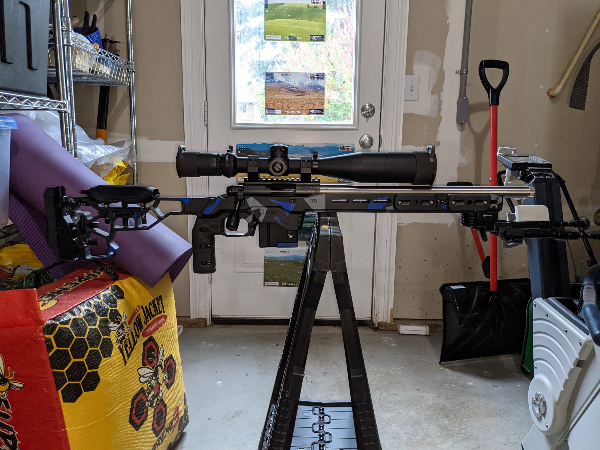

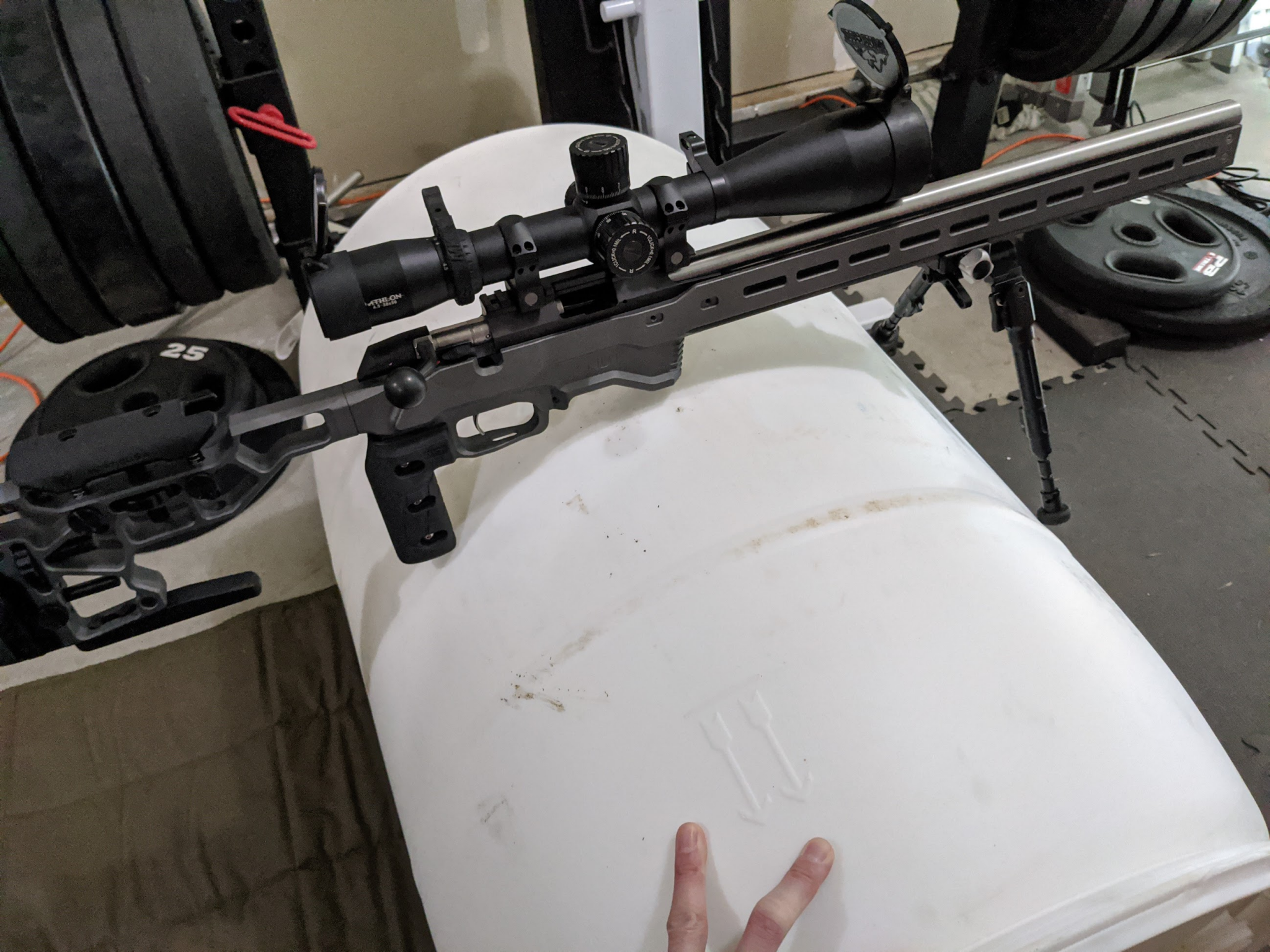

Distance is just testing dope. You do it "once" as in buy a ton of the same ammo, figure out the dope. Don't change anything.
Practice can be done via dry firing.
See all those little pictures in the background? I dry fire at those from 12 feet away. Looking at my stability, off the sawhorse, barrel, ladder, etc.
Another practice I was doing -
Really nice setup and practice setup. Gives me some ideas. THank you for sharing this.
specs? Dam this is a gorgeous setup!
