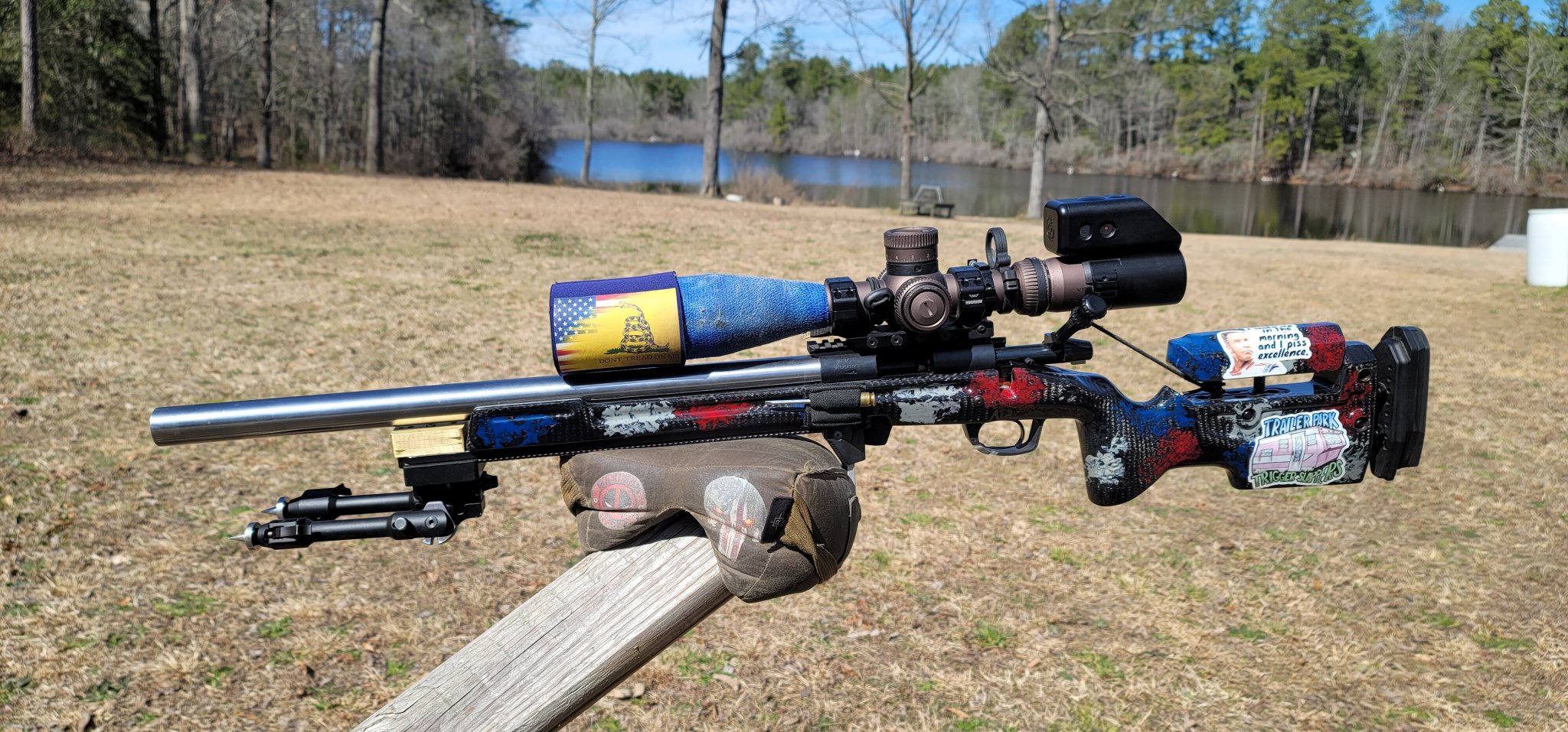

The thing I didn't like about the b14r in the acc chassis was the barrel didn't clear the forend. Out of those you listed, I prefer the MPA for that gun.
I liked mine when I ran it in a manners PRS1, but attempting to balance it was a little tricky since there aren’t any provisions to attach weight to the front end. It now lives in a KRG Bravo and it’s a bit better with a decently heavy tuner hanging off the nose.
Feeding wise, I really like my ARC Xylo, it has been flawless. I can apply pressure directly to the mag and run it all the way into a bag and it still feeds great. With a lighter contour barrel it takes a decent amount of weight to get it to balance however.
Personally I’d recommend Bergara’s own BMP chassis is you can find one. Perfect enough fit that it cycles fired cases for dryfire practice, tool-less adjustment, and M-Lock for adding accessories.

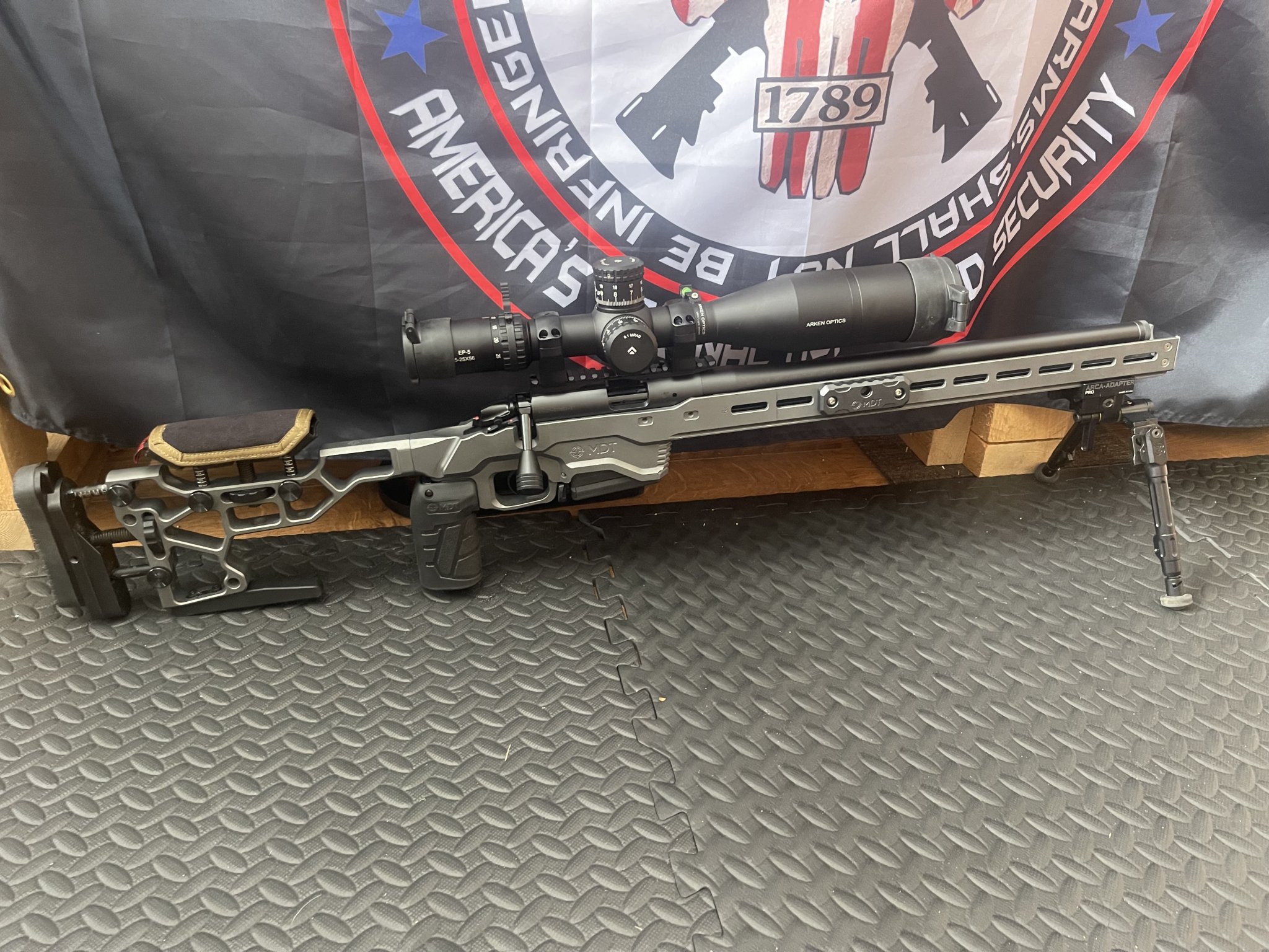

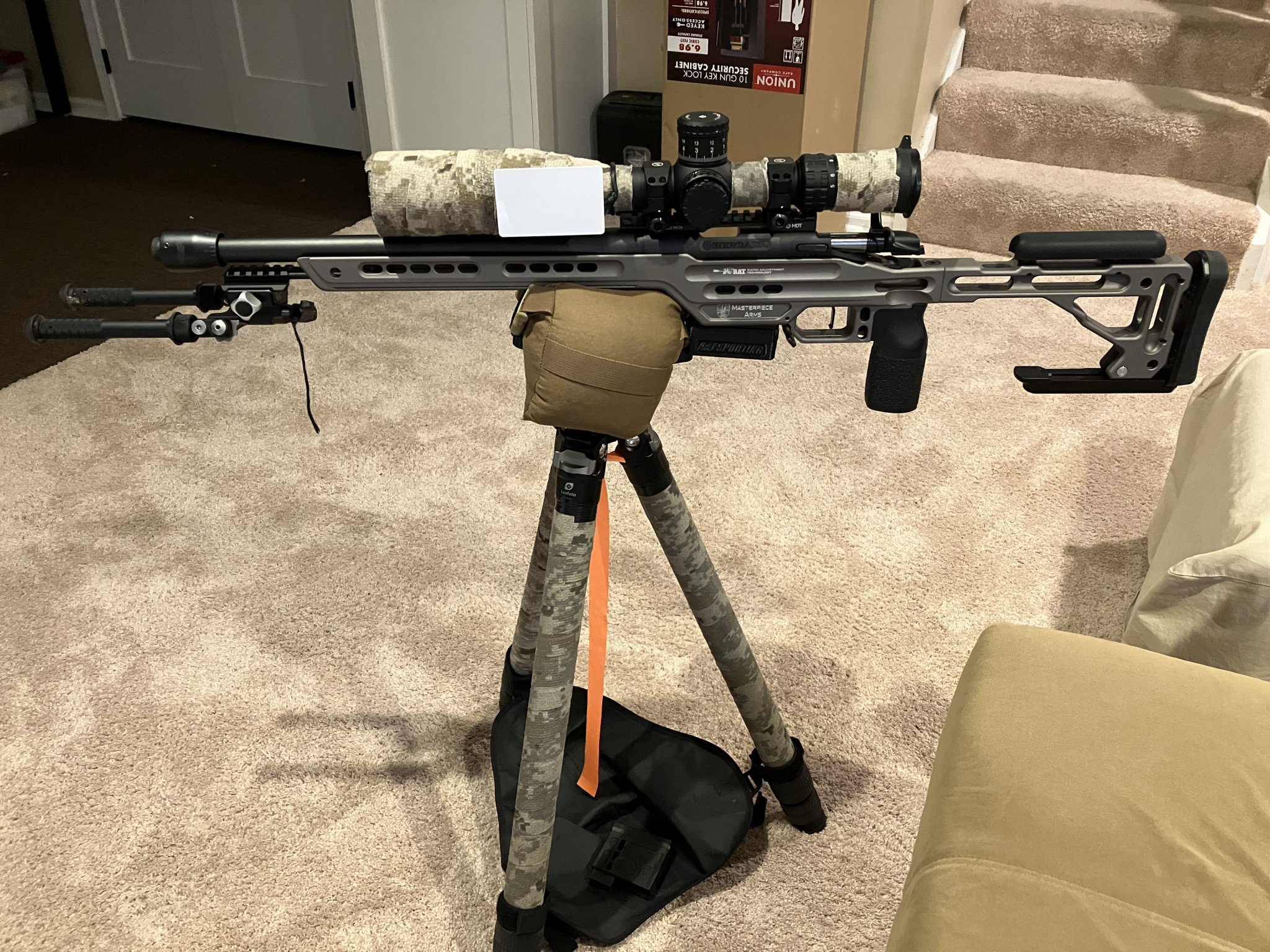

After sleeping on it, I decided to go with the MPA Hybrid for the following reasons:
1. In my budget
2. Available now
3. Lots of weight and balance adjustability
4. Comes with everything you need
5. Adjustable mag latch
6. The MPA BA22 rifles, Desert Precision Gunworks, and other reputable 22LR specialty smiths have offered their rifles with the MPA Hybrid
7. Lightish @ 3.5 lbs. It'll be easy to swap chassis to shoot NRL Hunter Light Open division with a Proof CF barrel and a hunter/target hybrid scope
8. Gunmetal gray tickles my fancy

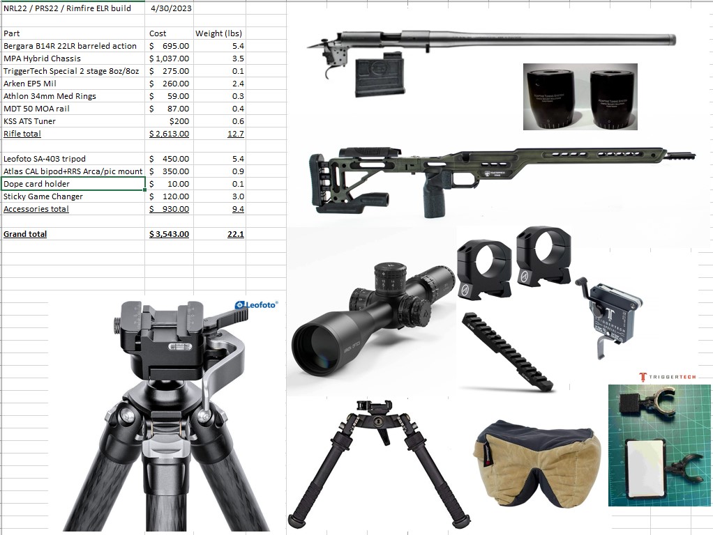

My shopping list and build lay out as of 4/30/2023.
Thank you, I'll keep you updated on the results and how it shoots.
Reactions: Travis224
1. In my budget
2. Available now
You are spending a total of $930 on accessories and $3283 minus the optic and you are only allowing for a $260 scope on this build?
Half off cert helped cut the cost for the Arken EP5. With my Cz 457 and 50 MOA rail, it let me dial up 28.4 mils.
Last week, was able to see and hit 1/4” KYL at 100 yards, so it should be good for the NRL22 distances. Most PRS22 targets are placed further away but larger targets.
I might put the Tract Toric on it, but so far for seeing 22lr bullet holes and seeing shot out 1/4” steel at 100, it seems to work just fine.
Acquired a used Tactacam, I’ll post vid results once phase 1 of the build is complete. Phase 2: possible barrel and scope upgrade (depending how she shoots… I suspect if I foray into the ELR side more, both upgrades may need to happen)
YMMV and Happy shooting

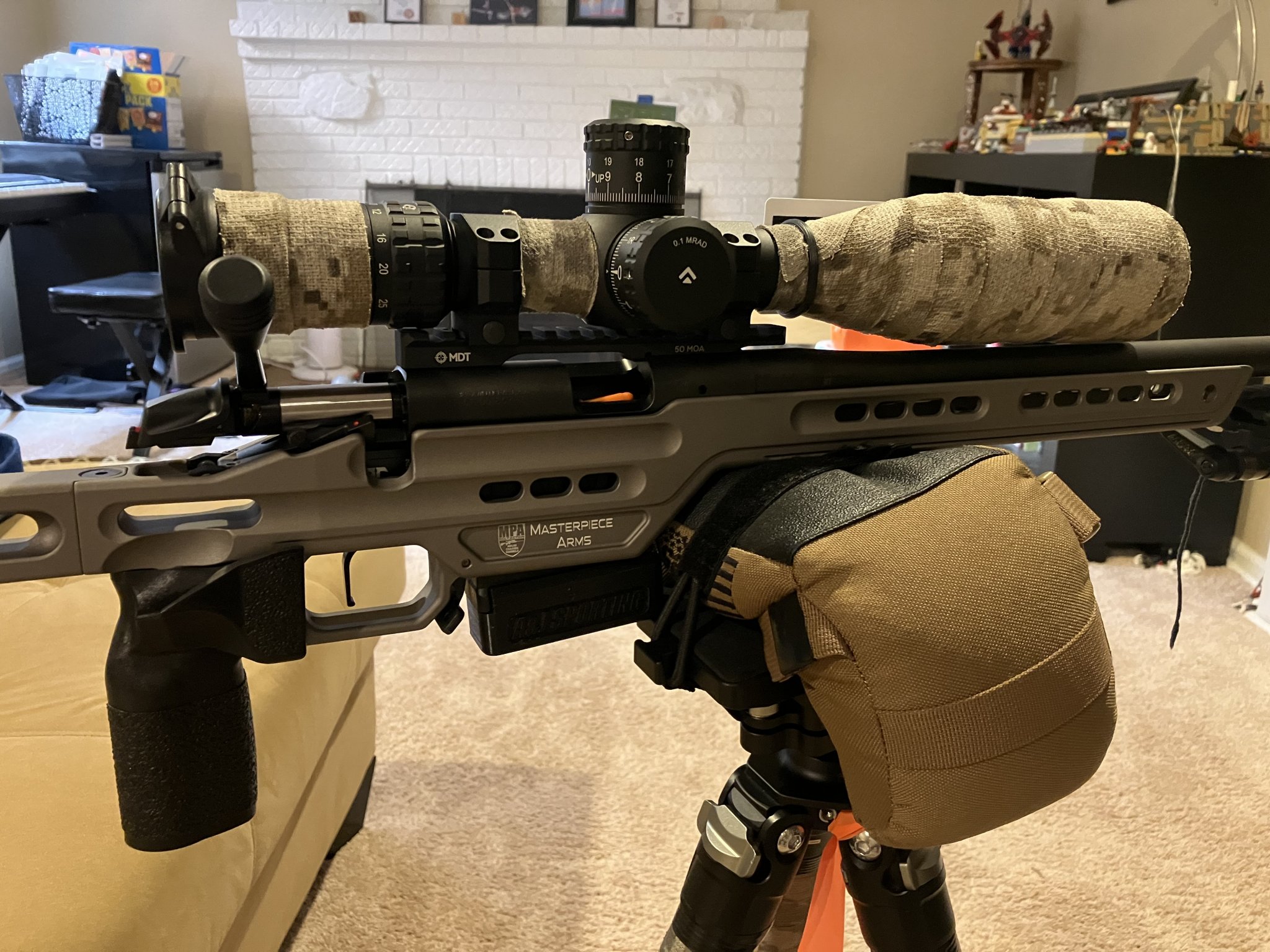

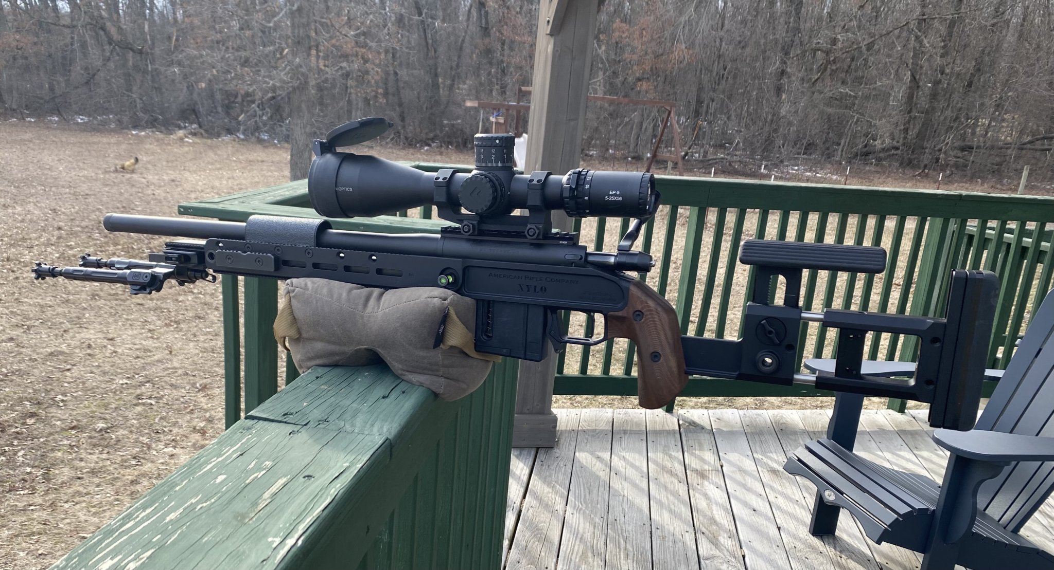

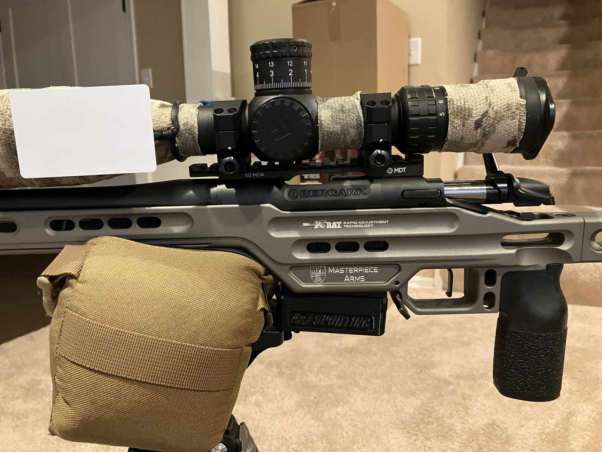

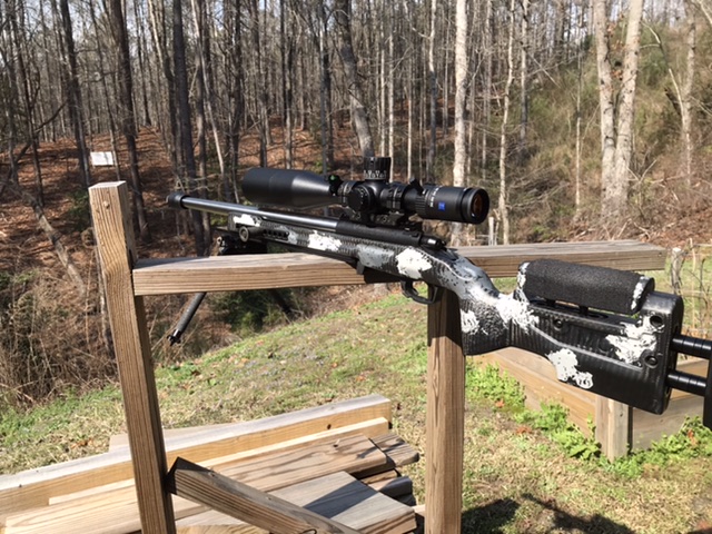

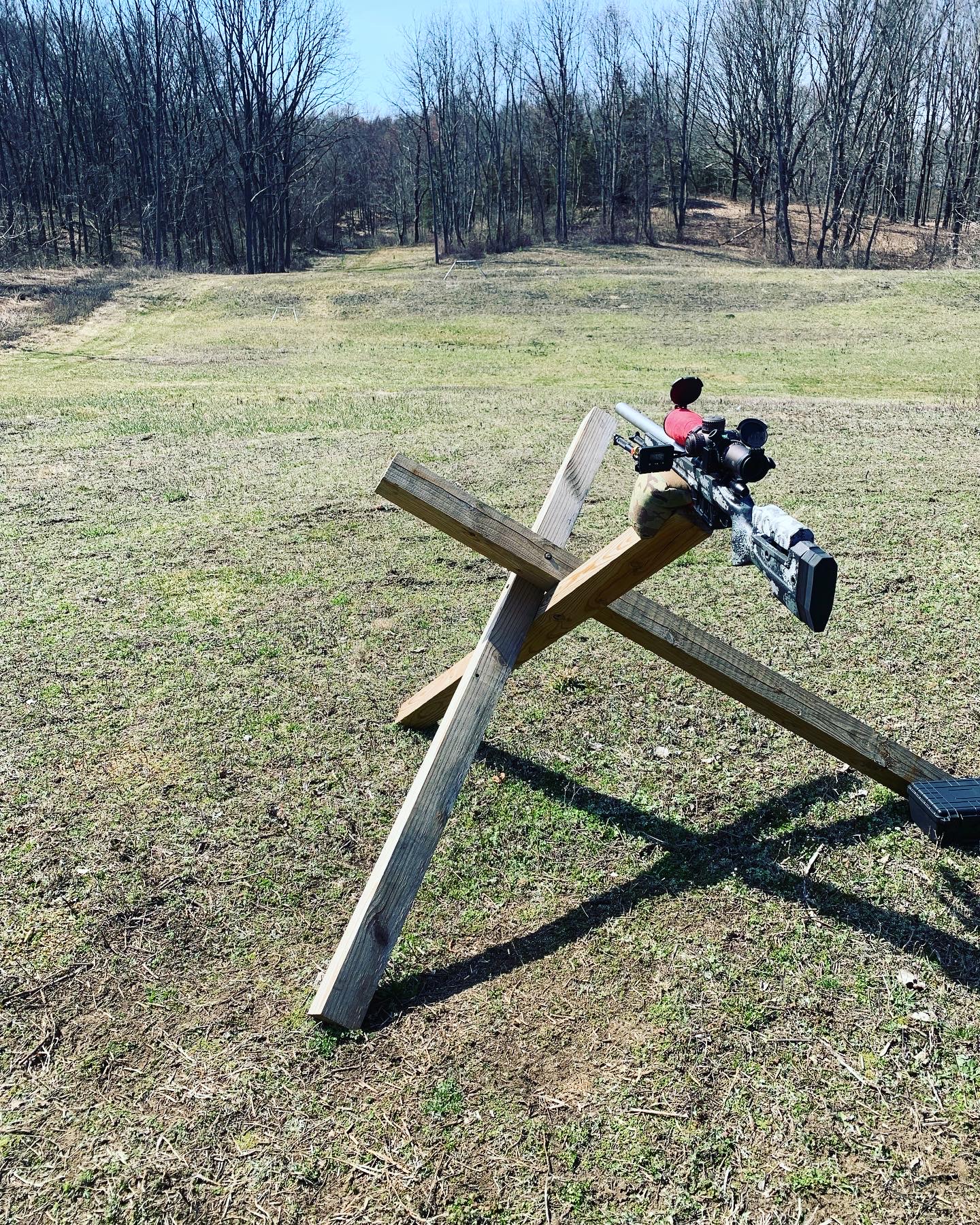

I have mine in an MPA, balances and feeds just fine. The factory stock wasn't bad either, just added an Arca rail to it. I just got a good deal on the MPA and it matches my centerfire rifle.

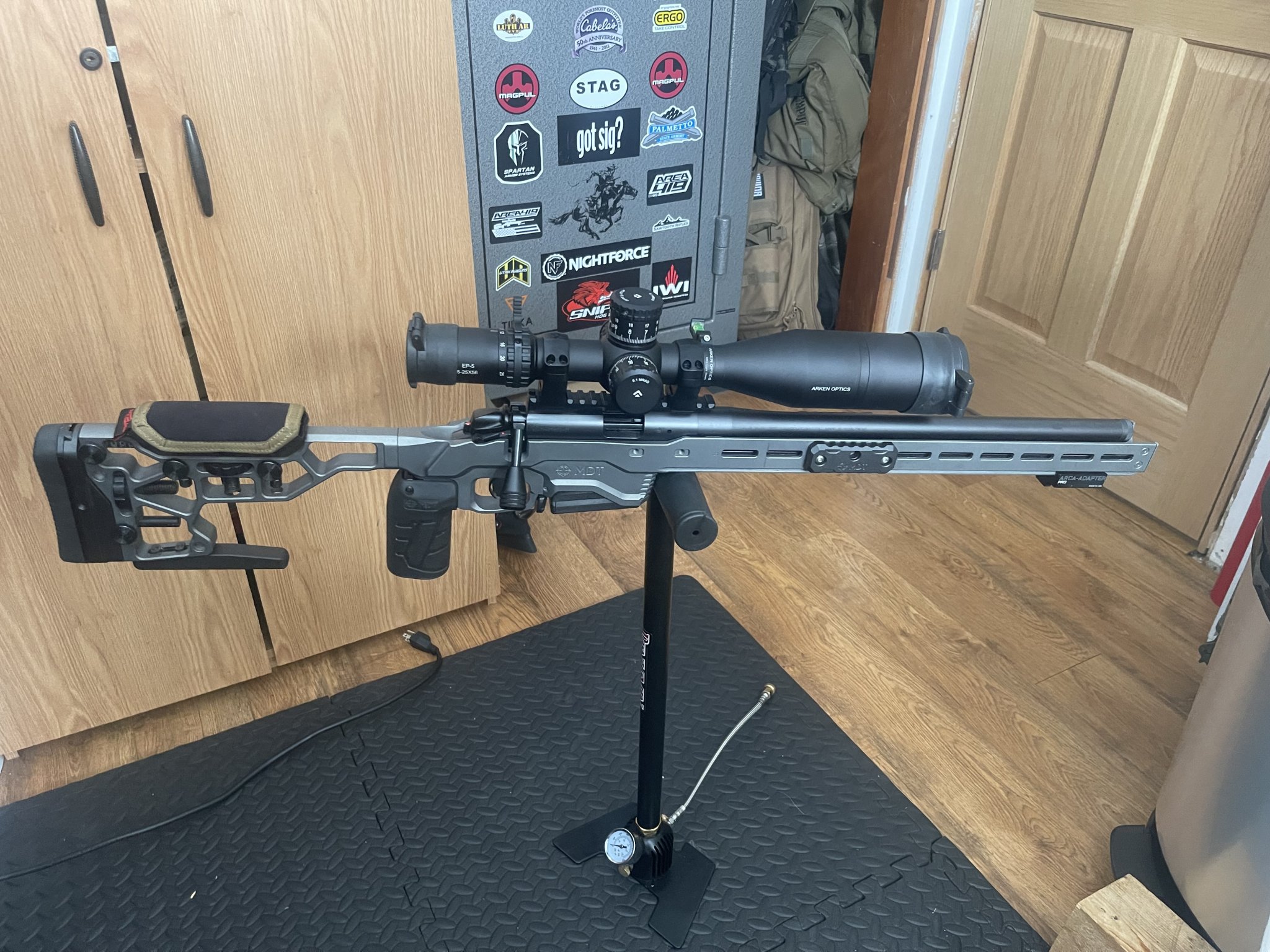

Just put mine in a MDT ACC. Forend obviously is longer but not an issue as others have done the same here (wouldn’t probably do it with a center fire). Waiting on 2 cans for this and another T1X build
B14R Barreled action
MDT ACC chassis
Arken EP5
Full internal forend weights
2 external forend weights
Weighs exactly 17 lbs
Fed/ejected spent casings (I recently staked the ejector)
Ran full 10 round mag for function test (unfired) and ran flawlessly
Balancing on my handle of my Benjamin air pump
Reactions: cuz and obx22

That's a very nice set-up, but I still can't get over the aesthetics of the the fore end overhang (for no good reason).
How does your rifle shoot? Any limitations from your rifle on targets out to 200 yds?

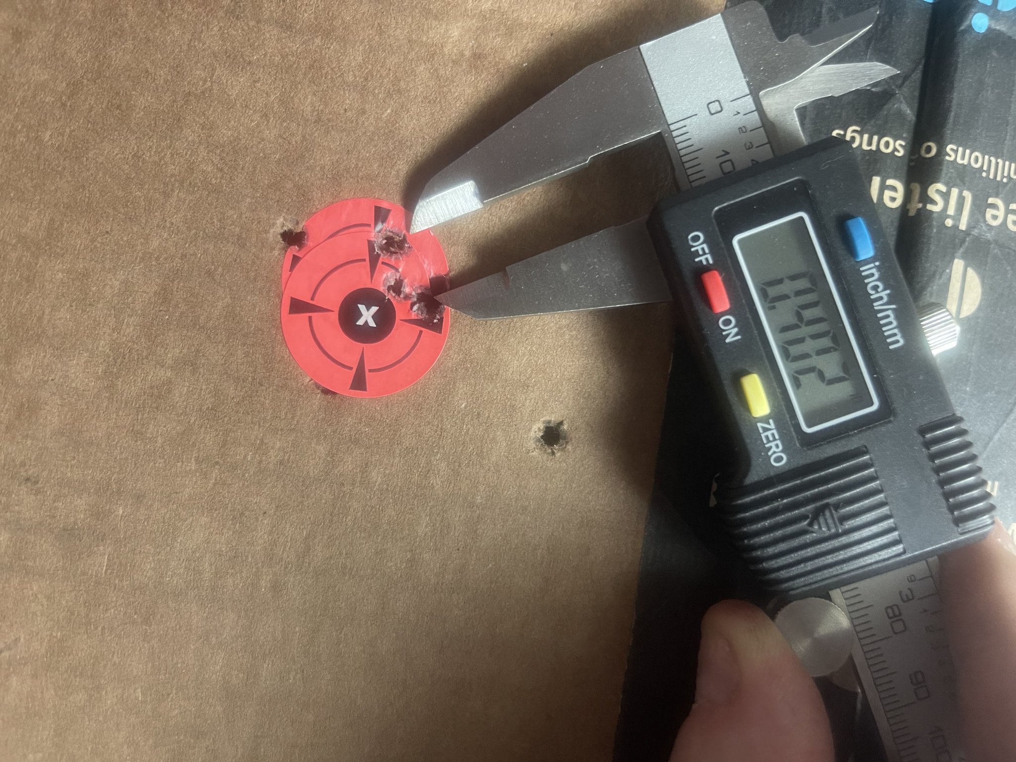

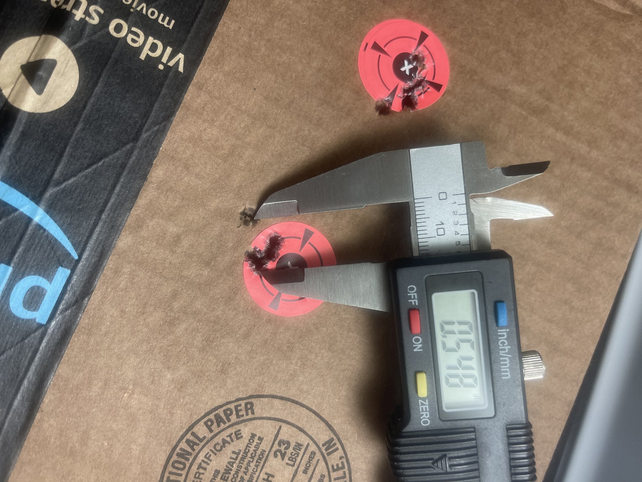

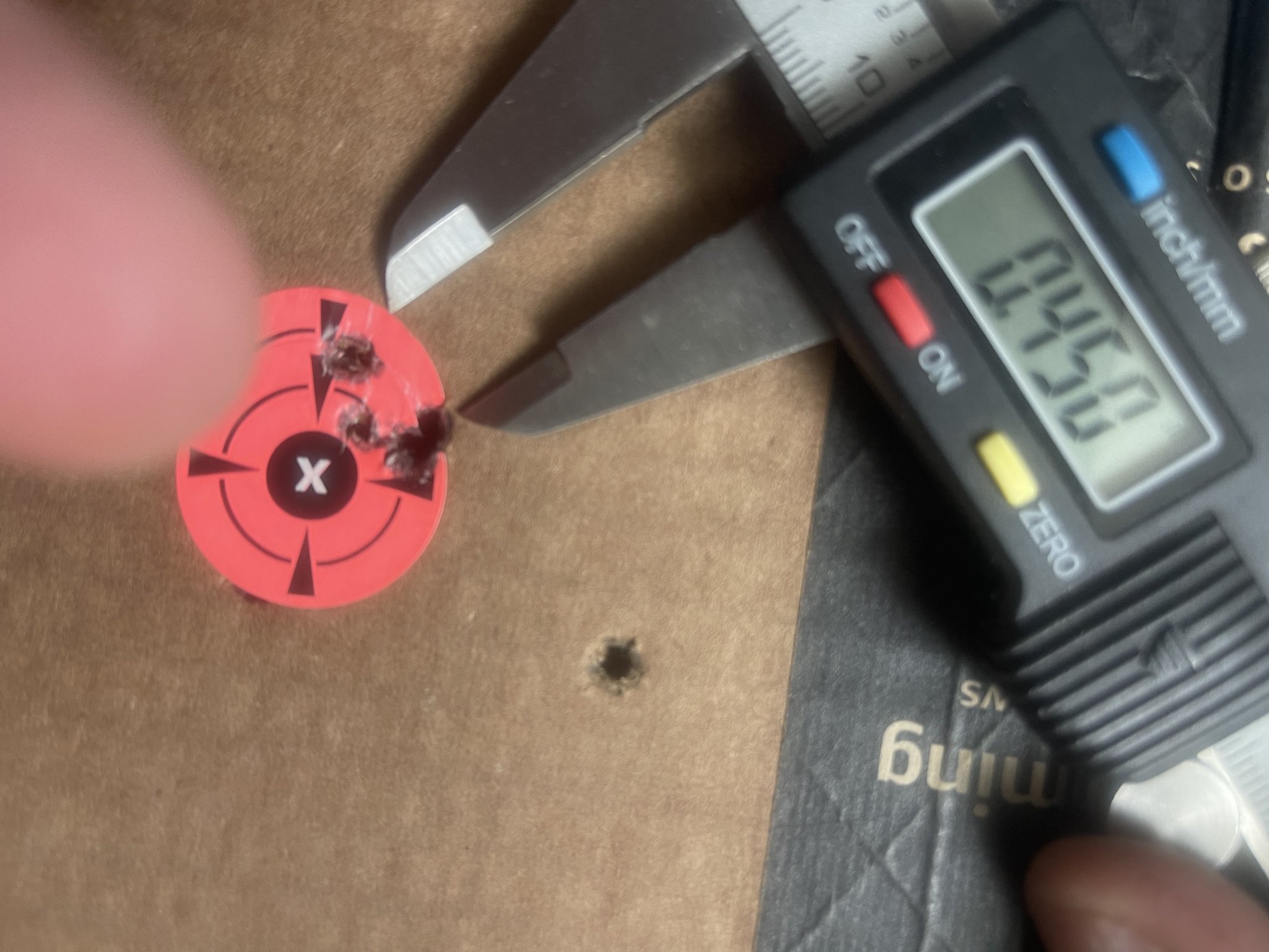

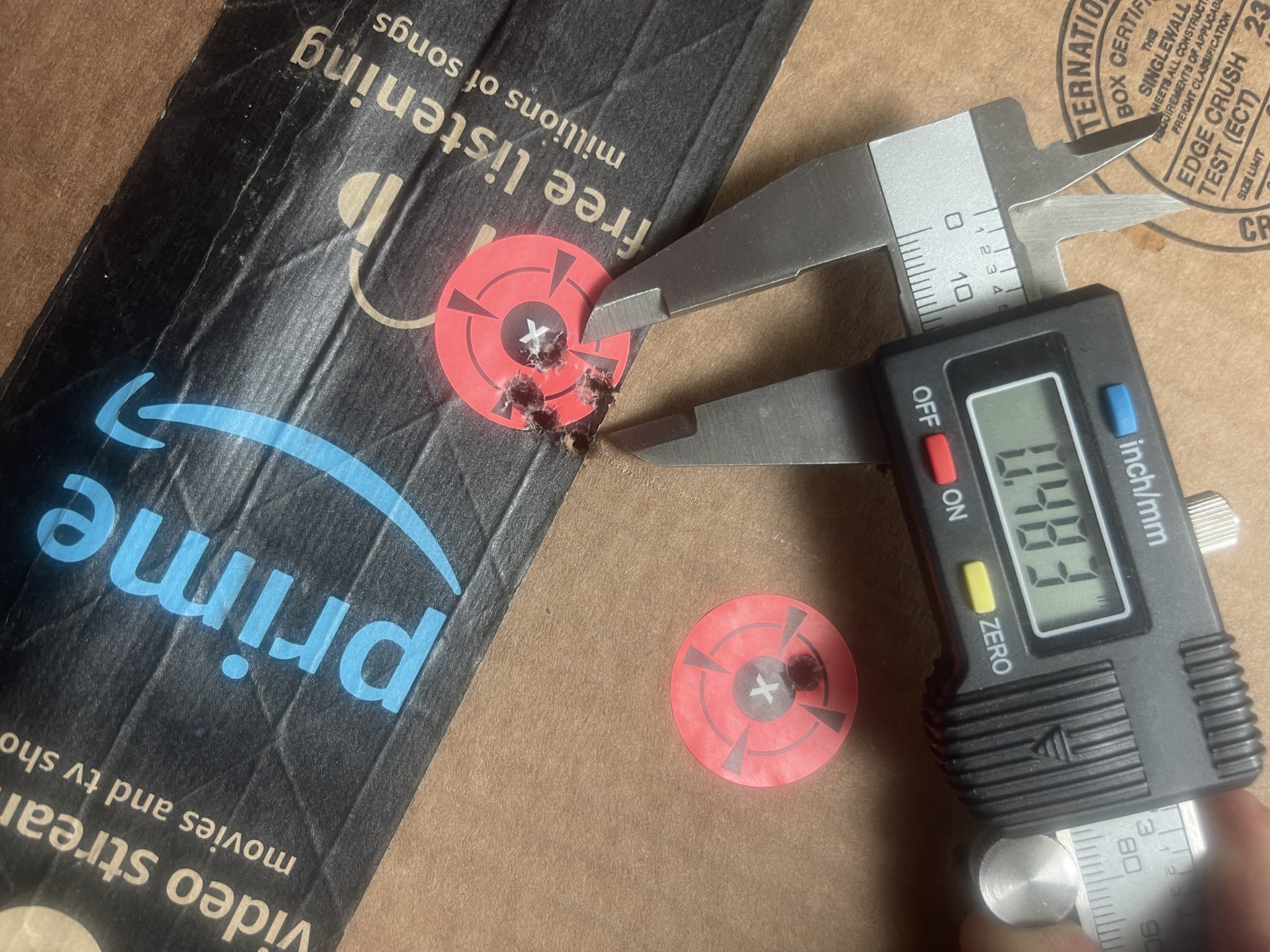

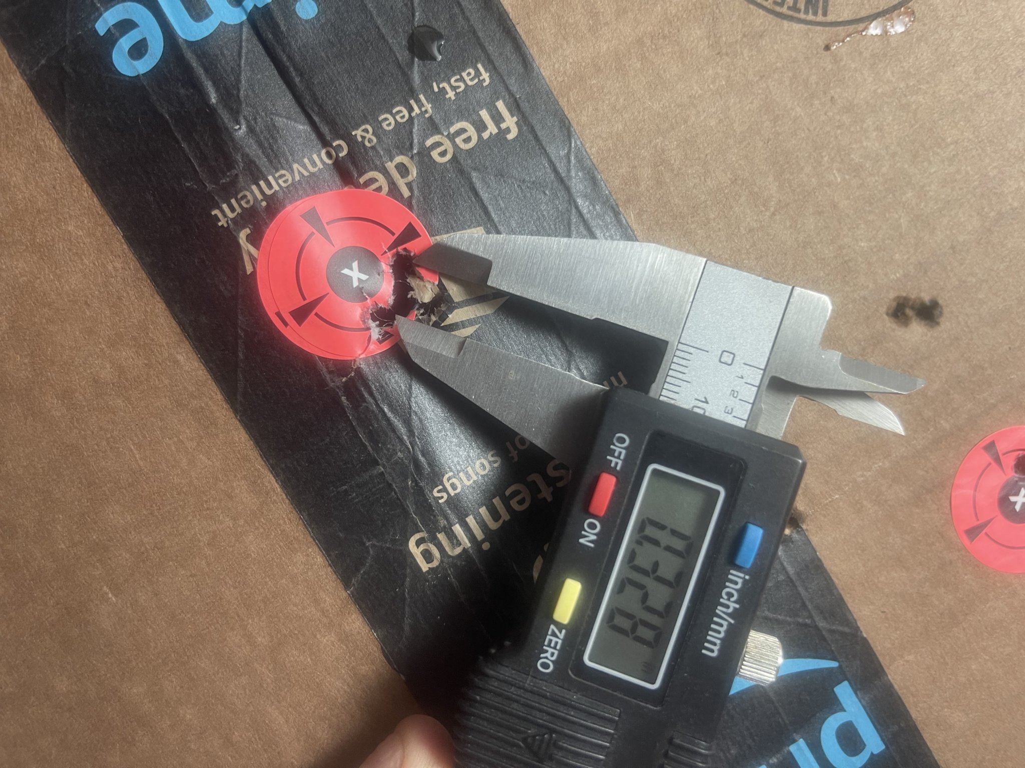

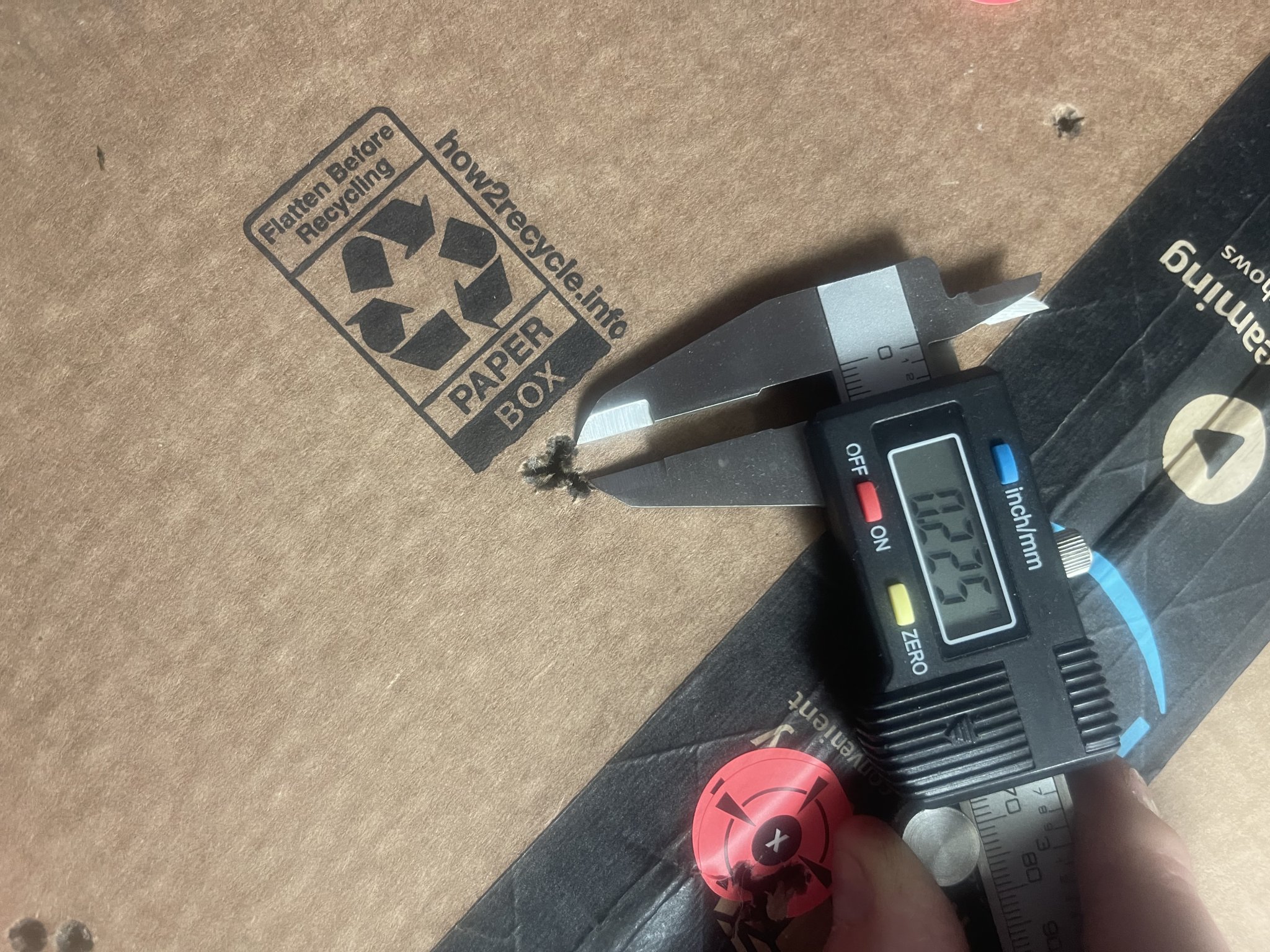

Not really known at this point. I shot 1 box of SK LR ammo and a few cheaper brands just breaking it in. But the scope I had was a larger reticle than I preferred at the time. It did show promise though. The trigger really sucked from the factory. Even adjusted lowest setting was about 3-4 lbs and had a shitty creep when starting the pull. Put a TT 2 stage in since
I’ll post some groups from the SK at 50 yards below. This was factory setup though. I just finished this up today in the pics above. Last group shot was .2 at 50 for 5 shots. I’m assuming it will be a shooter with some lot/ammo testing. This is the 1 and only box I fired through this gun other than some CCI HV and Federal bulk crap which it surprisingly shot about 3/4” at 50 with that
All measured groups are 5 shots. Some have other shots near them from sighting in or targets next to them etc
Mine will be suppressed when I get my forms approved. I have a TBAC and griffin on the way so that will protrude out the forend
Reactions: Mr. Wolf and obx22

My b14r balances great in the bravo. Added an aluminum ARCA rail and the minimalist spigot.
I had a Bergara b14 ridge in the bravo, and dropped the b14r in and it worked flawlessly. There's a little tweaking you can do with how the plastics fit, I put the action in, mag in, and then torqued all the screws.

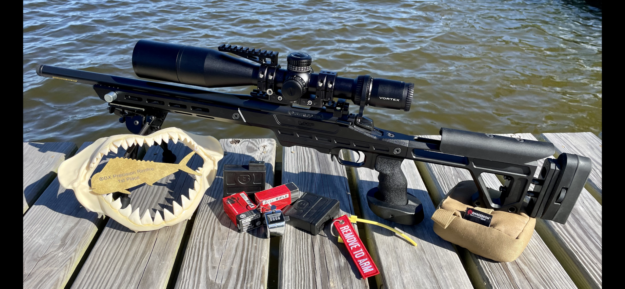

The build parts came in and I finished out the build today. No opportunity to shoot yet, maybe this weekend.
Initial impressions of the MPA Hybrid is awesome. Excellent tooling and the Sniper’s Grey Cerakote is the cats’ meow.
It came with the action screws so for those who are building up a barreled action, worry not. It also came with the spigot mount and the grip with the thumb shelf fits like a glove. (I may have to change out the grip in my other non MPA chassis). Minimal up and down movement with the Bergara mag, I may be adding painter’s tape to the mags to fix the forward/aft rocking.
I went with the MPA Hybrid chassis because the buttstock is lighter than the MPA Comp BA and have read (and now experienced) that it is easier to balance. The balance point on my bag is about 1.5” in front of the mag well when I have the Atlas bipod and ATS tuner on without any added weights. A weighted rail gamer bag instead of the bipod balances similarly.
Range report coming soon.
YMMV and happy shooting
