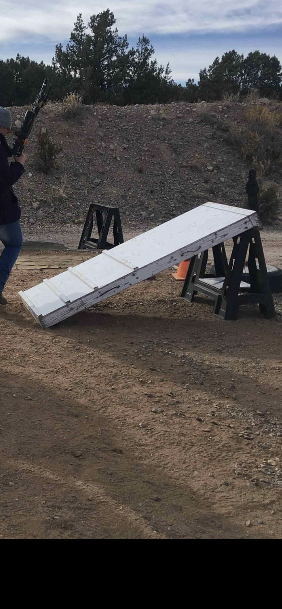

My club is having this same arguement, I like the banquet table idea that you open one set of legs fully and lock in place, other you open at 30°-45° tho not sure that has any structural purpose. Other I saw (and snapped a screen shot) is basically a wooden box I would assume supported underneath with cross framing on a strong/sturdy sawhouse (some at Home Depot rated 700lbs)
I’m gonna build the pictured and get a few friends to stand on it with me (no guns) to test,
this looks like a great option, utilizing the saw horse and being simple, compact and cheap to make.
