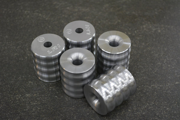

If you know some with a lathe make something like this.
so much nicer to use than the washer.
Reactions: hereinaz
Indeed. For a few bucks, LRI makes a nice one.
The included washer works, but if you slip you can easily launch the castle nut and washer to the darkest corners of your garage where the missing AR takedown detent pins live.
The LRI tool or similar gives you a lot more control and makes the job a lot easier.
I believe ARC makes one now as well.
