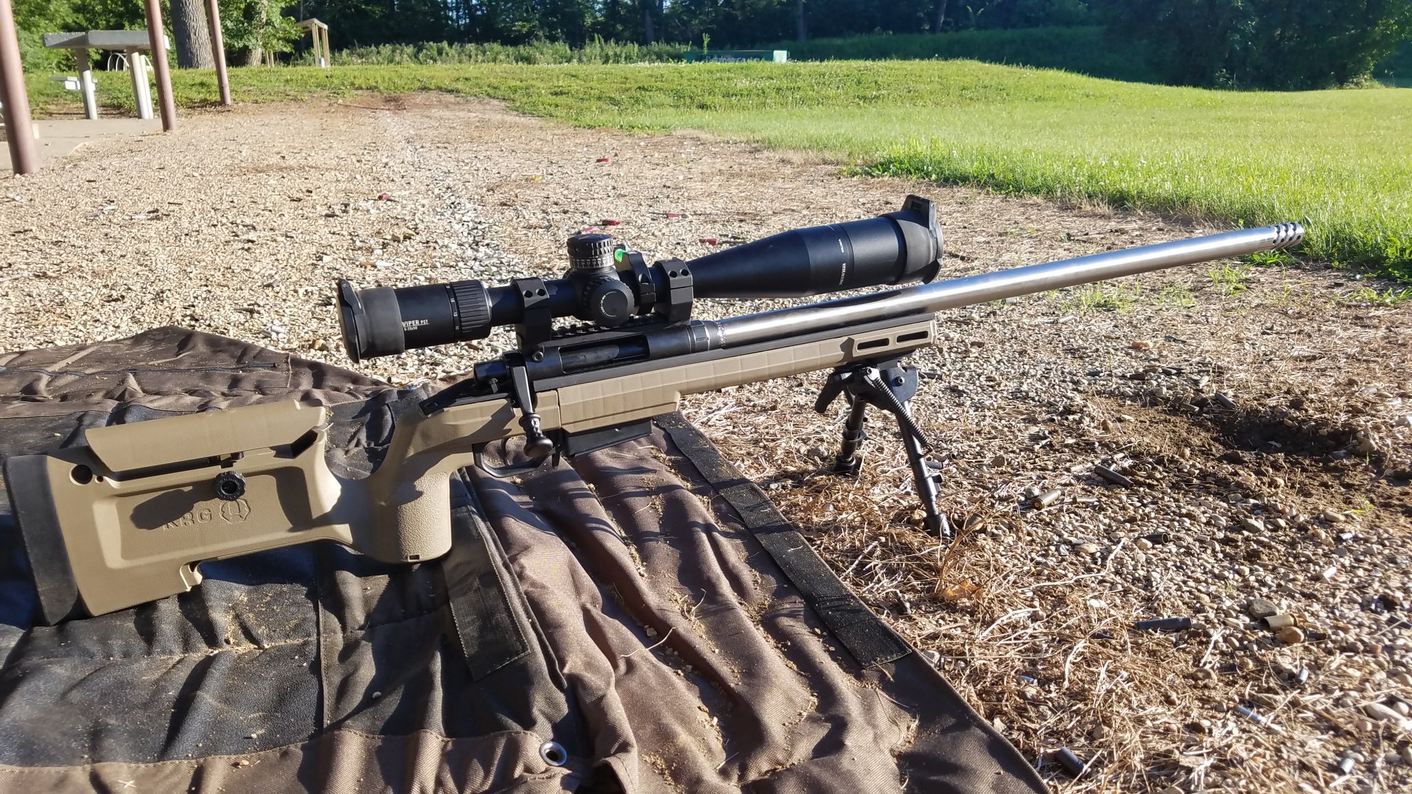

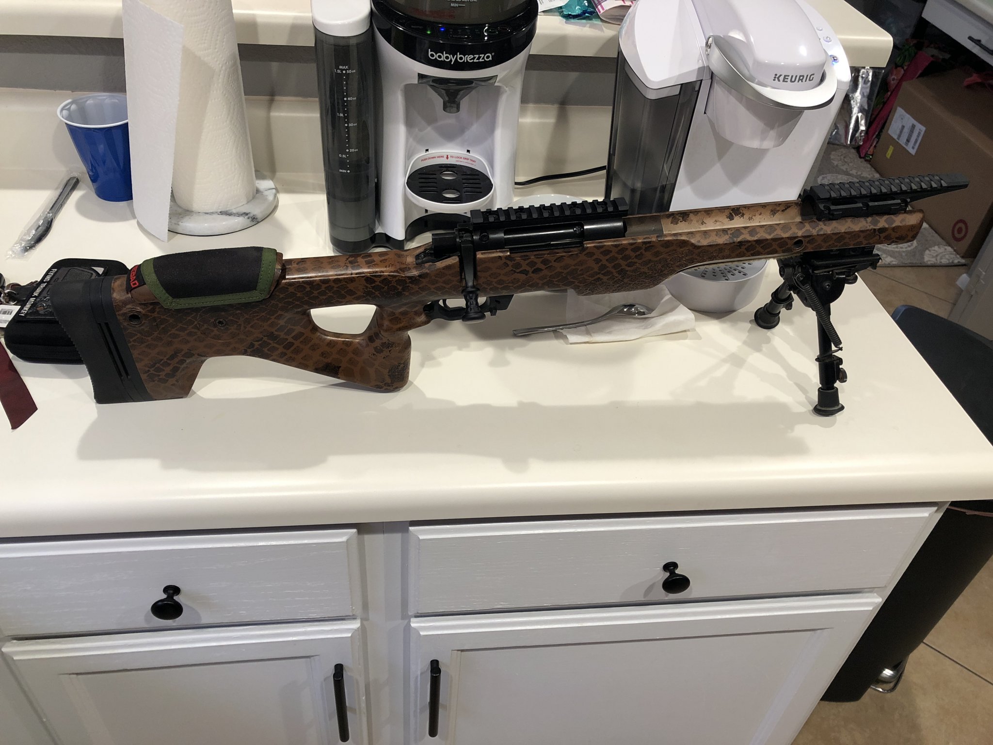

    My new freedom machine, #6 off the line
    -Nucleus
    -PVA 6.5C prefit barrel (krylon flat black)
    -Hellfire Brake
    -Timney Calvin Elite 2-stage
    -KRG Bravo stock/arca rail
    -SWFA 5-20 HD
    Any issues with the CE? Someone in the other mentioned some issues regarding the overtravel screw I believe

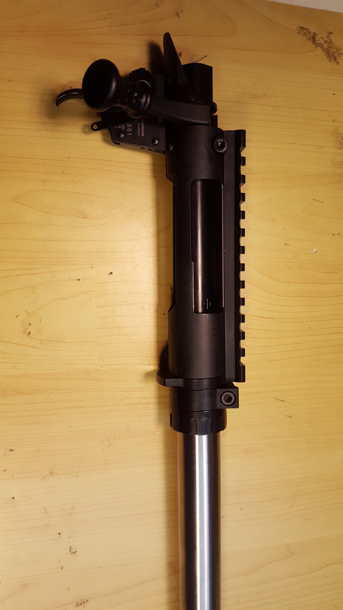

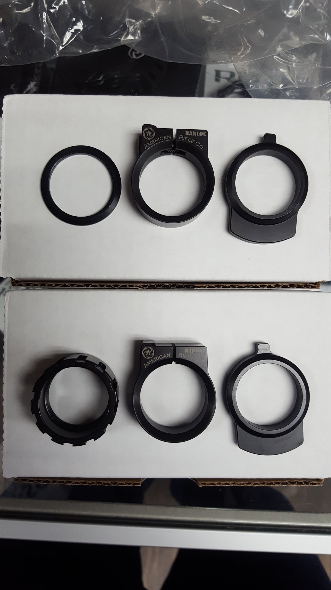

    A mock up w/ Barloc, 16.5" NSS Criterion Varmint contour barrel, TriggerTech primary trigger, PTG BDL, and Griffin minimalist muzzle brake in McMillan HTG stock.
    Barloc doesn't clear barrel channel so screws are not fully tighten.

    Bolt handle clearance is fine, Barloc needs more.
    I put a Barloc on my Savage action and dropped it in an HS Precision for a varmint contour. I had to open the channel up for the Barloc as well. I think that will be a fairly common theme for Barloc in a stock, unless you have a straight barrel contour. It wasn't much though, maybe 1/16th or so free floated it in my stock. I also had it skim bedded, so that lifted it up a little bit.

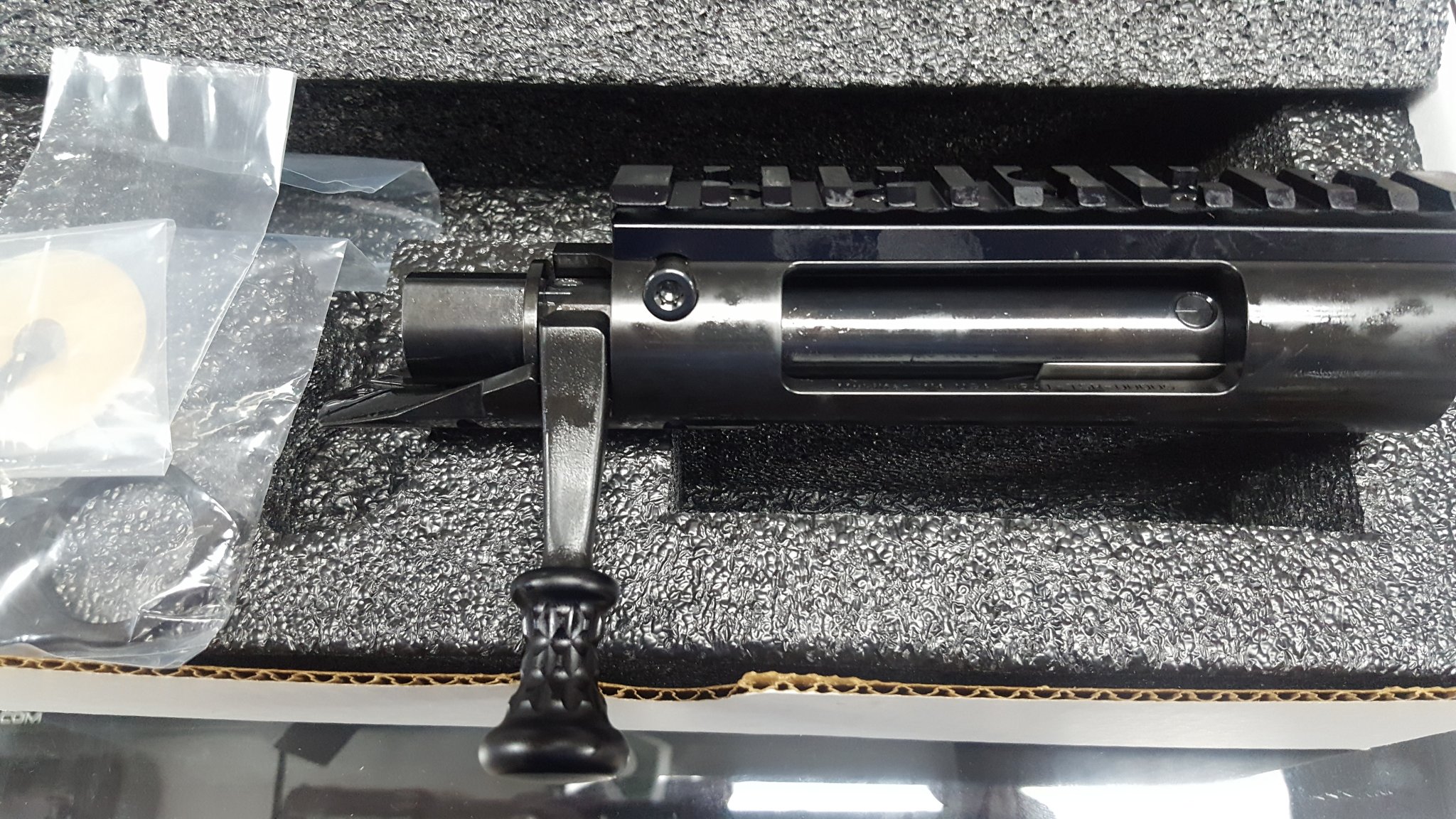

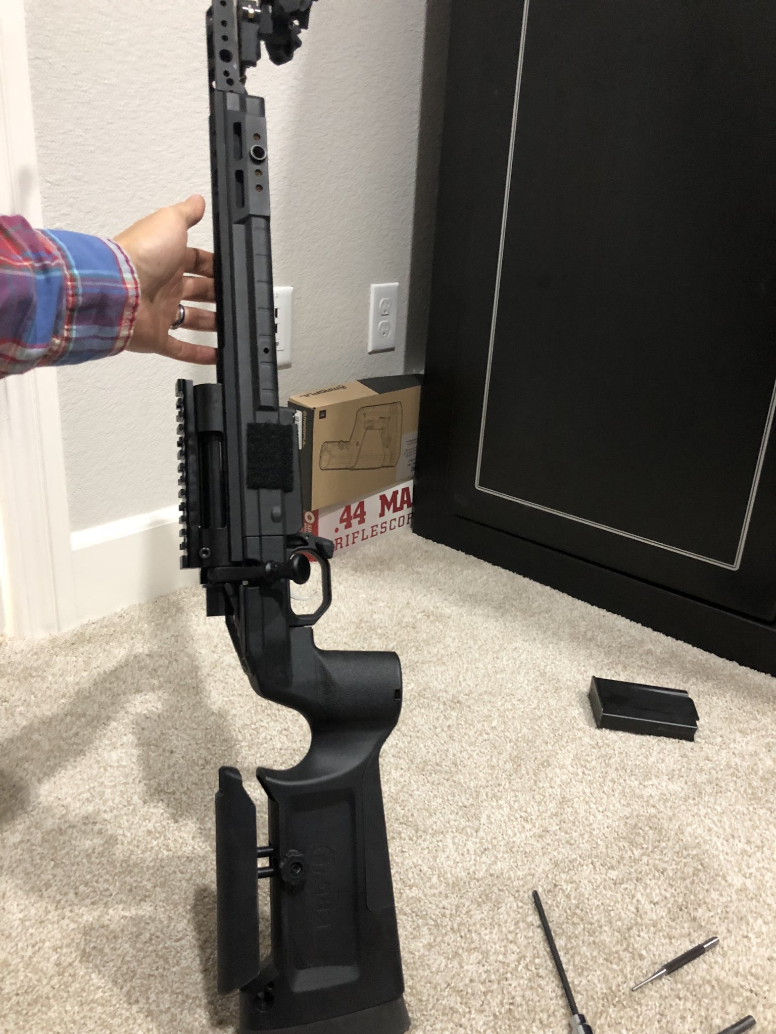

    Picked up my Nuke yesterday. Waiting on a barrel. I've thrown it in a KRG W3 Gen 4. The front action screw is too long and will not allow the bolt to rotate. Just an fyi. The Huber two stage feels amazing.
    How many spacers are you using with the screw?
    You don't want to try and make a screw a full .5" shorter by stacking washers until it works. You're going to want to trim the screw down.
    You can use a dremel, or you can use the bolt cutters that are built into many "industrial" style wire cutters. Here's an example of what I'm talking about. You can pick them up online or in a Home Depot/Lowes for about $15 and they'll strip or crimp wires and cut screws for you. Thread the screw into both sides of the screw cutter portion, then squeeze and it snaps right off. If you're really worried about the threads you can just touch them up with a bit of sandpaper if you don't have a dremel, but I've never had a screw that had problems requiring chamfering the threads using screw cutters like these.
    You've misunderstood. The length of the SHCS is only 1/2 inch long, which was the shortest that I could find. And I don't think you're going to cut a 1/4-28 cap screw with a wire strippers.
    If you're cutting a screw use a high tension hand saw and a wire wheel or similar dremel bit

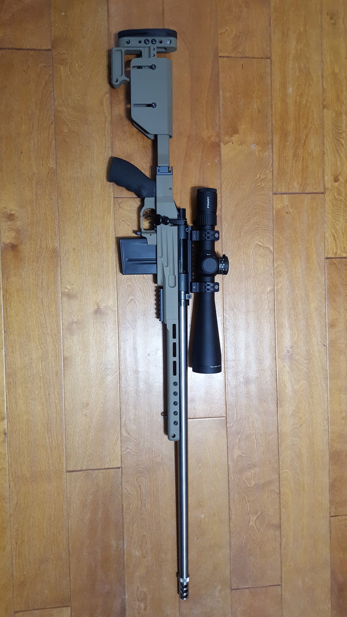

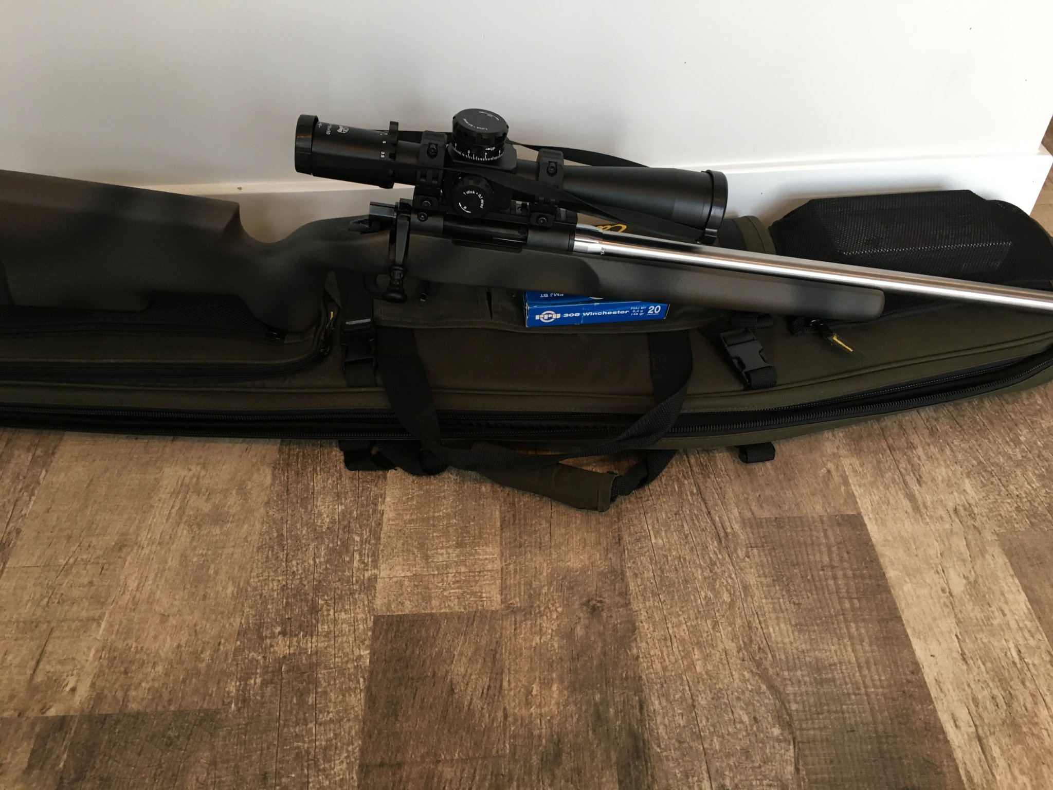

    Going shooting next week and couldn’t wait my Barloc so I put it together with a savage barrel nut.
    Nucleus RH short action
    25 inch X-caliber medium Palma 1:10 308 barrel
    No name 3 port muzzle brake
    Greyboe Renegade stock
    TriggerTech special trigger
    IOR Valdada 3.5-18x50
    Really happy with how it’s turned out and can’t wait to shoot it.

    Do you mean with the front action screw? If so, then none as of yet. I'm going to try it with one. If that doesn't work, I'll shave the screw down.
    I have Gen 5 W3 chassis and the manual says "For Remington stocks, two washers are used on the front action screw." I ended up using only one with Mausingfield as two washer gives me to little thread contact, but using none will make the screw go in too much blocking the bolt.
    Thanks Derek. I'll try that and see what happens. I bought the chassis used and have no instructions for it.
    They have Gen6 instructions on their website. For R700 you need one washer in the back and 2 in the front, like I said with my Mausingfield I use one back and one front. I'm sure they can send you a few washer if you don't have it if you give them a call. Good luck.
    If you buy wire strippers with the threading for 1/4"-28 you absolutely can cut them. The trick would be finding a pair with that specific threading instead of the more common 1/4-20. I most frequently use mine to cut down 1/4-20 socket head cap screws.
    Regardless, not using washers will be preferable since it's more repeatable (in terms of zero and maintaining constant screw torque) if you ever remove the action and re-install it later. Washers usually compress when you tighten down on them which does some wonky things with your screw torque. Don't use washers, cut the bolt down in whatever way you see fit.
    One washer was enough to make some clearance between the boot and the screw. Thanks for the tip!
    On my KRG Gen 5 W3, I use two washers up front and one on the back for my TL3 as stated in the instruction. With the ARC Nucleus as the others have mentioned only one washer was needed for the front action screw solid thread engagement and one on the rear.
    Reactions: shooter777
    A socket head cap screw in fine thread is almost guaranteed to be grade 8 and probably hard enough to wreck wire cutters.
    The proper way to shorten a bolt (short of lathe turning) is to make a stack of one nut and as many washers as you need for your desired length and tighten that on the bolt. Next use a hack saw, band saw, abrasive saw or grinder to cut off the excess length. Use a file to smooth the cut and square it up somewhat, then remove the nut which will push any remaining burrs out of the bolt thread. Finally put about a 45° chamfer on the end to blend with the thread profile. I usually use a sanding disk, belt sander or bench grinder for the last step but a file can work too.
    An alternative on longer bolts is to double nut instead of creating a washer stack.
    In a stock/chassis, you're bolting against aluminum, fiberglass or wood, so use a washer.

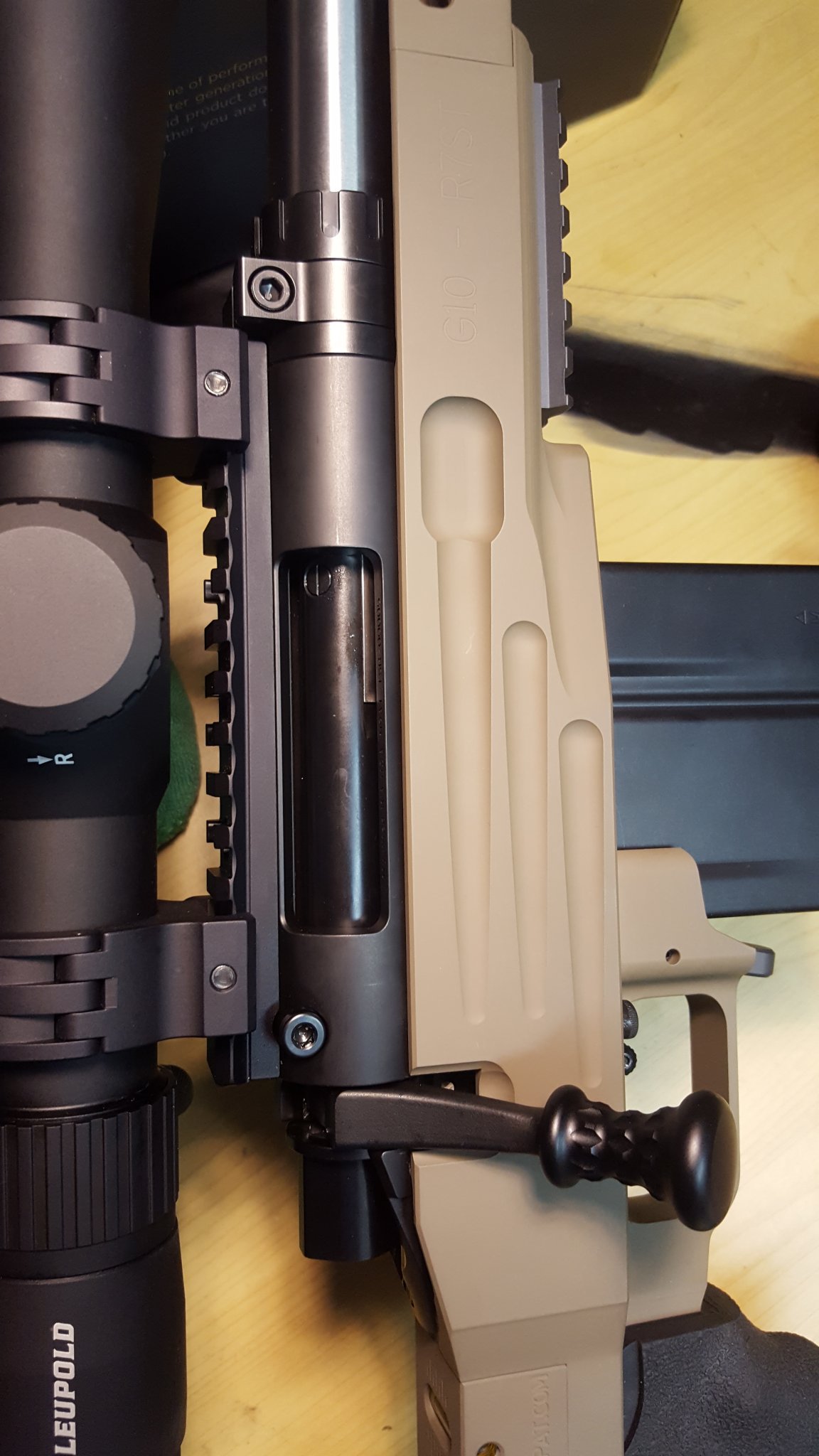

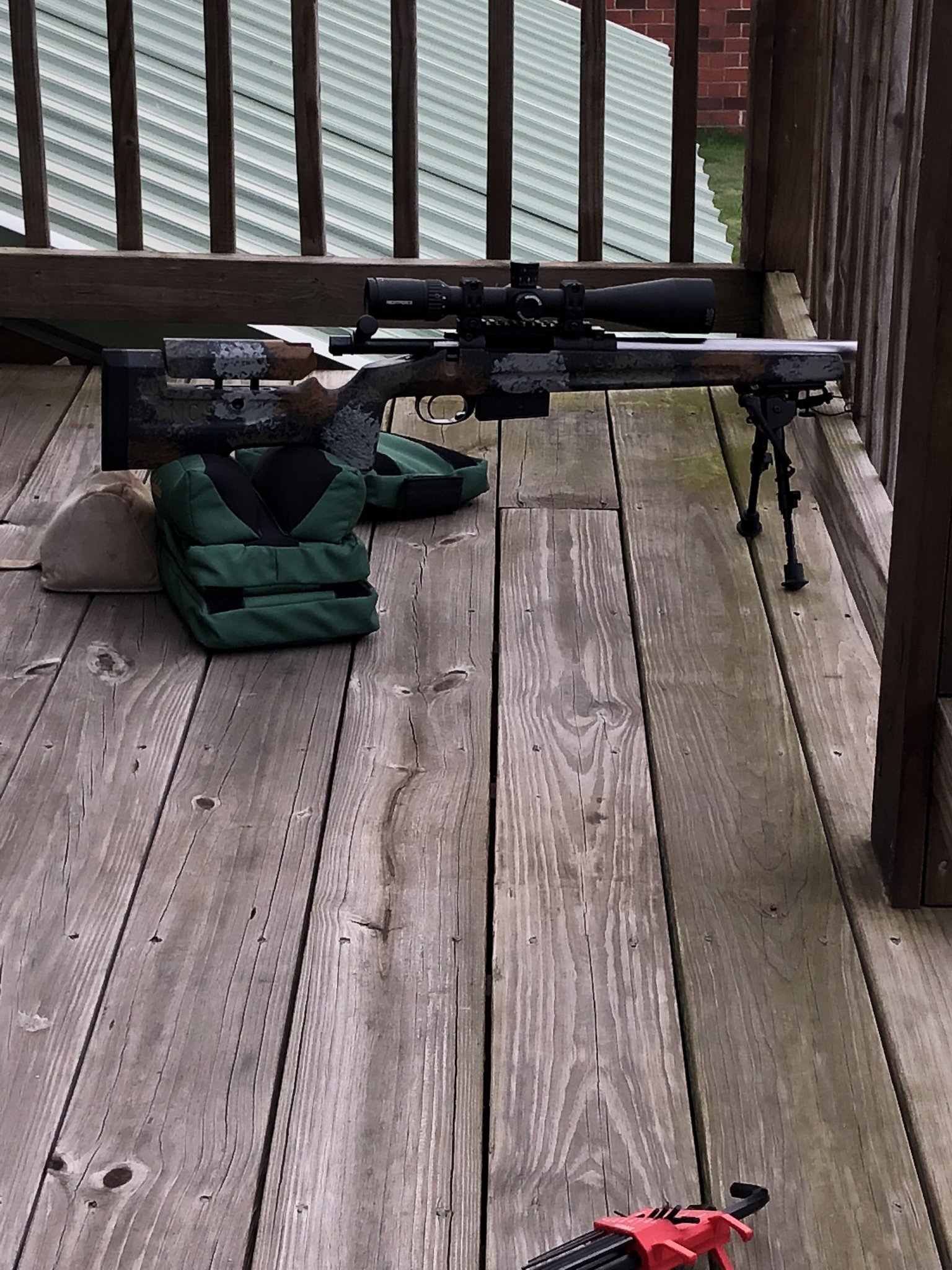

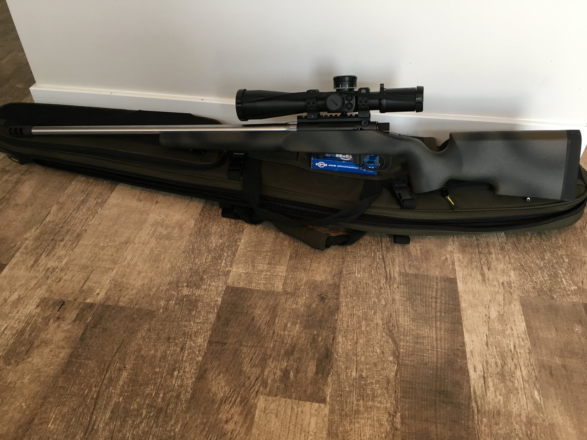

    Nucleus, Barloc, Manners PRS, ptg bottom metal, Hawk Hill 6.5x47 Savage Prefit. No pics of groups but it flat hammers with factory Lapua 139gr. SHV F1 for now that I’ll likely upgrade. I have a PVA 6.5 creedmoor barrel and another Hawk Hill in 6 creed. This one shoots so good I doubt I’ll swap it any time soon.
    How'd the Barloc fit in the Manners barrel channel?
    It didn’t. VERY careful dremel work. Tom Manners in another thread said they can Inlet for the Barloc. This was a CORE heavy Palma inlet and it only required an inch or so to be enlarged.

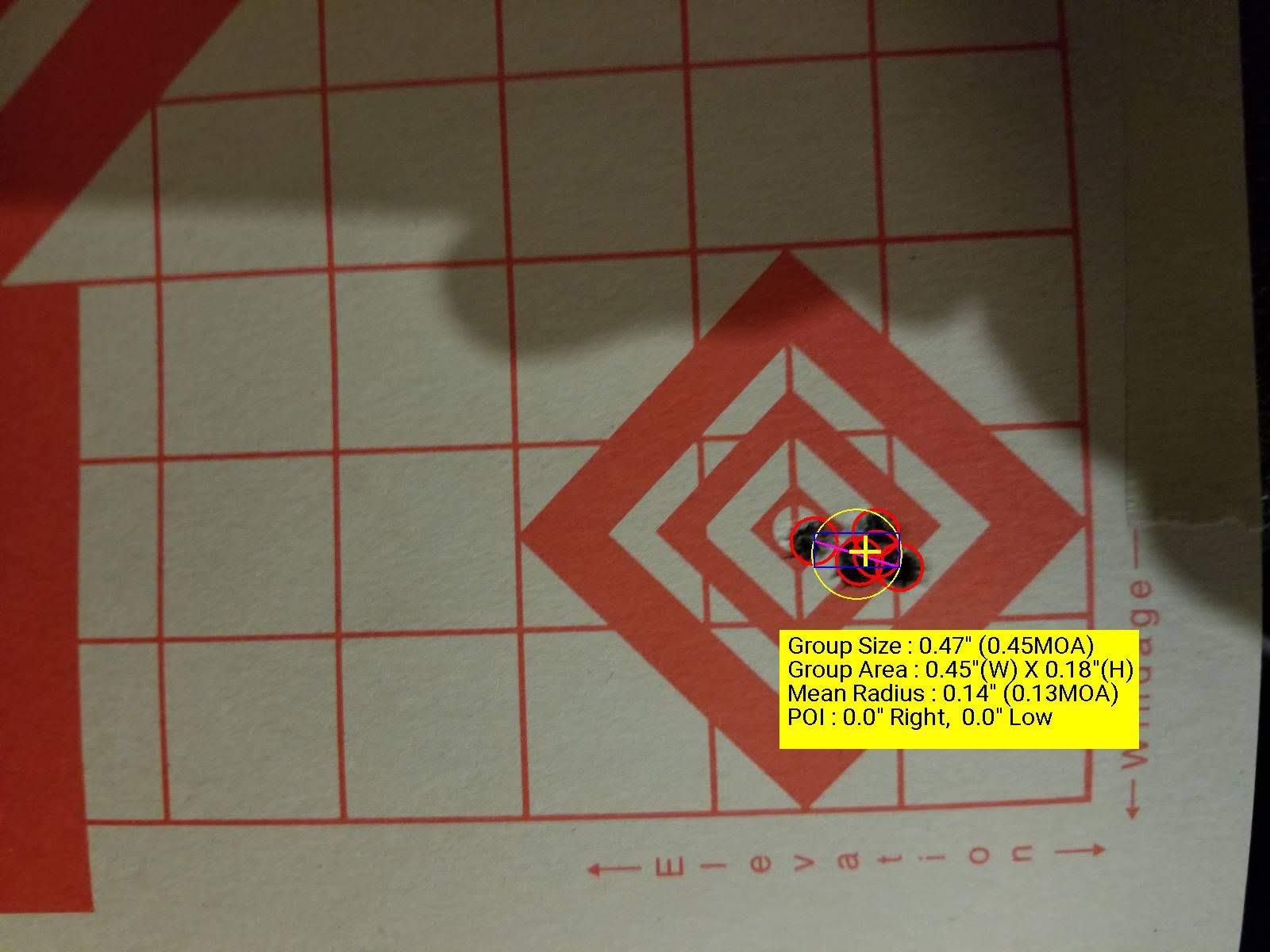

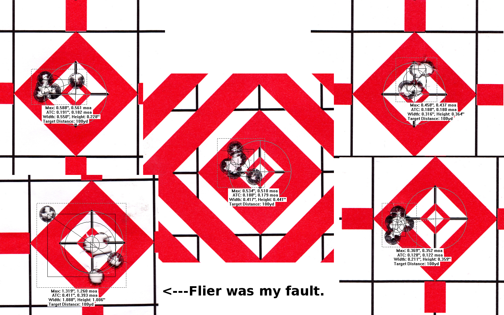

    I was able to finally get the Nucleus build completed this weekend. It's sitting in an XLR Envy chassis with their heavy fill options (both front rail and a solid buffer tube) and attached to a 28" Criterion 6BR bull contour pre-fit with a Thunder Beast Ultra 7 on the end. Glass on top is a TT525P. I wasn't sure how I'd feel about a polished stainless barrel when everything else was a nice black, but I'm digging the contrast after seeing it all together.
    I headspaced it off of my virgin Lapua brass and threw together a quick set of test loads using 105 Hybrids seated .020" off the lands with charges from 29 to 31 grains of Varget in half grain increments. The winner of this very coarse test was 30.5 grains, but the worst group of the day was still under .5 MOA with one flyer. I didn't take as much care as I should have loading these since I was excited to test out the rifle, and I know there were 3 or 4 cases that I ended up priming after dropping powder and seating bullets so I'll need to do some proper load development when I get the chance to find what the true best is.
    Order of the photos is the rifle, best group (30.5gr), and worst group (29gr).

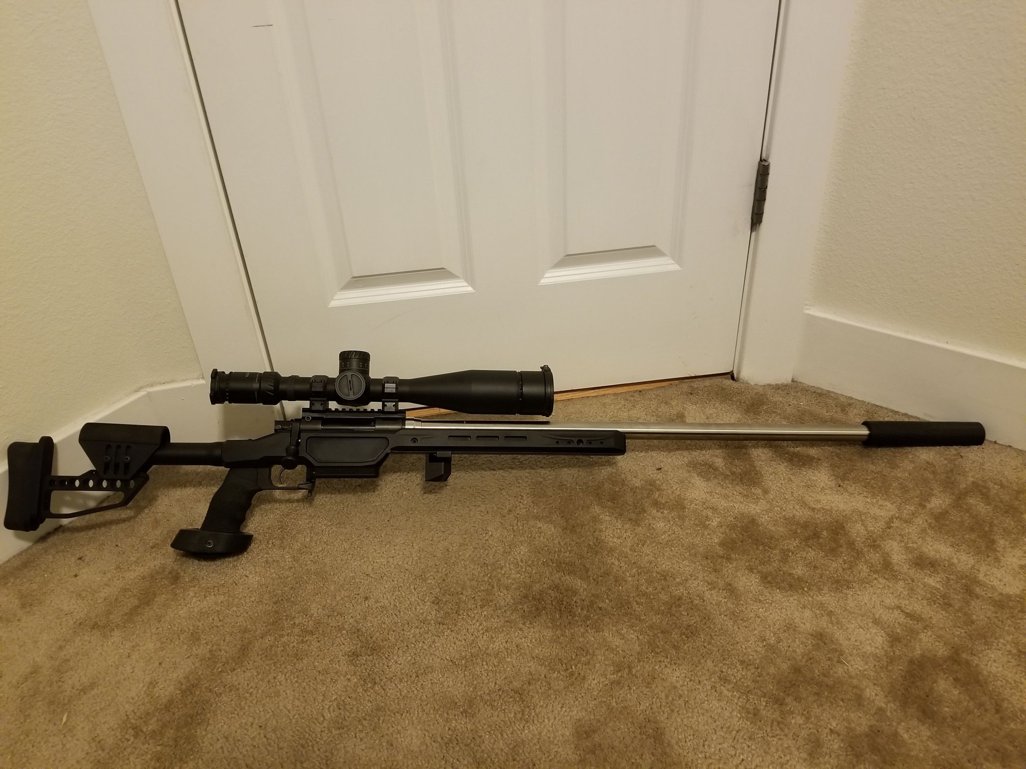

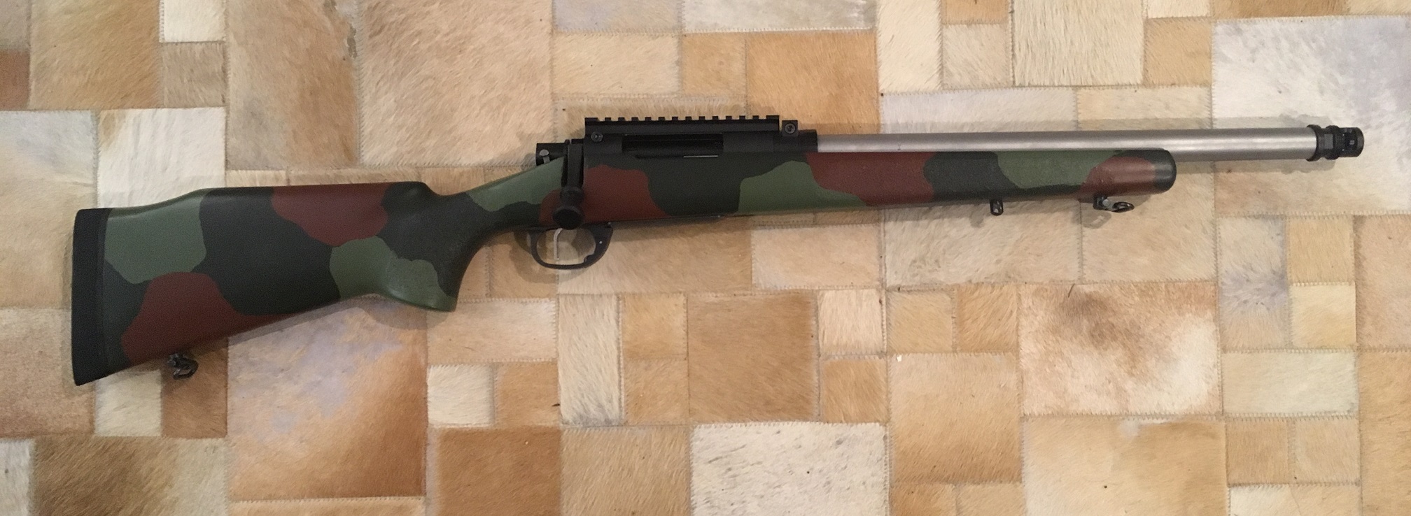

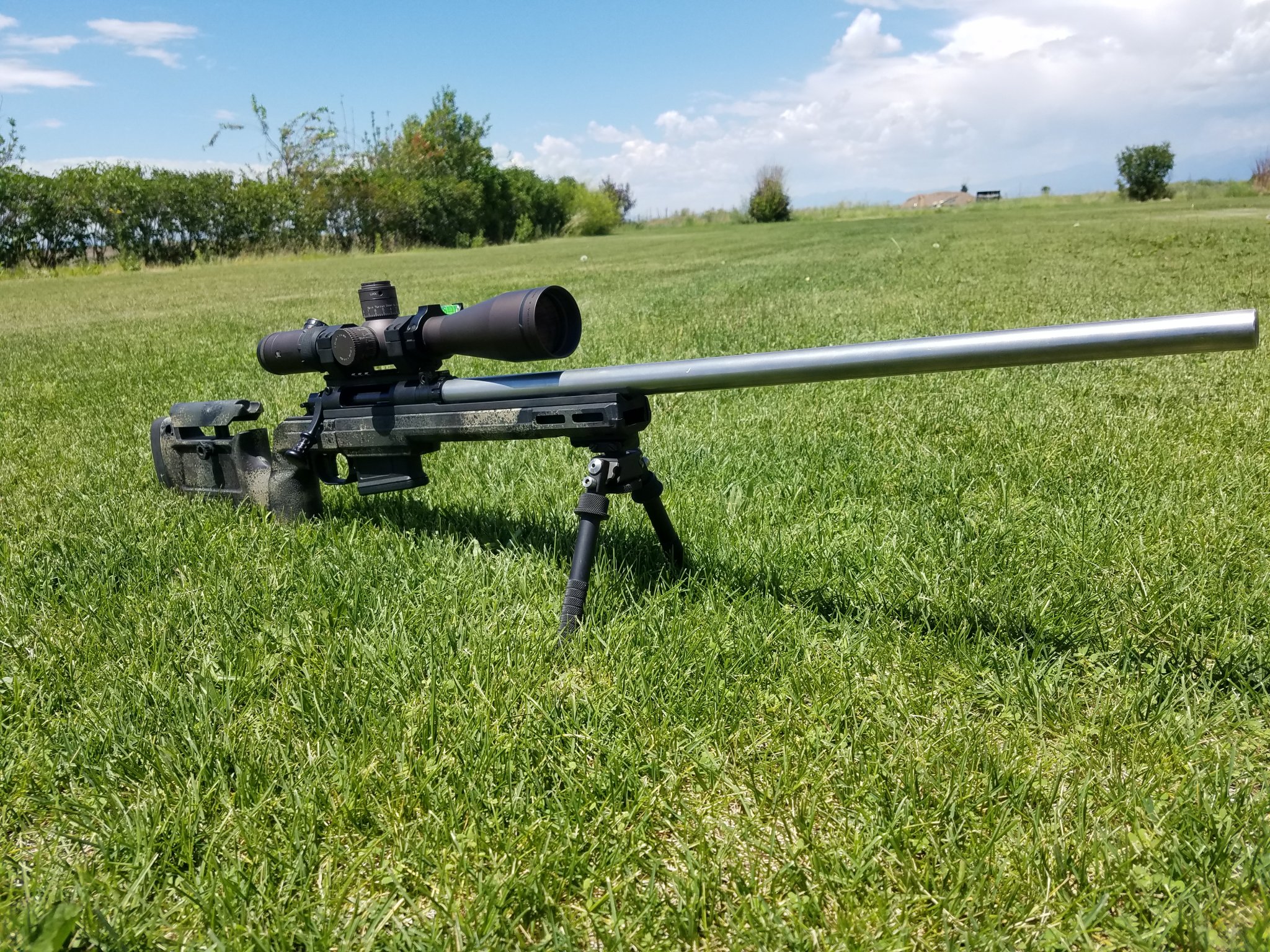

    Here’s mine in a kmw sentinel with the mini chassis and nvg rail. Currently has a Jewell trigger on it just to try out probably will switch it back to my 2 stage Calvin elite and get rid of the Jewell if I don’t like it. Just waiting on a barrel now.

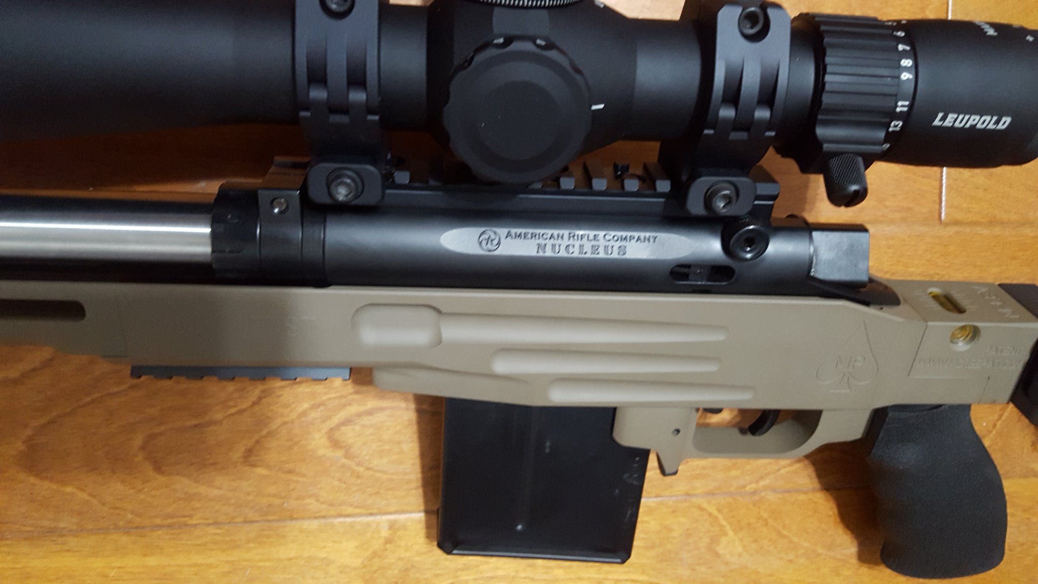

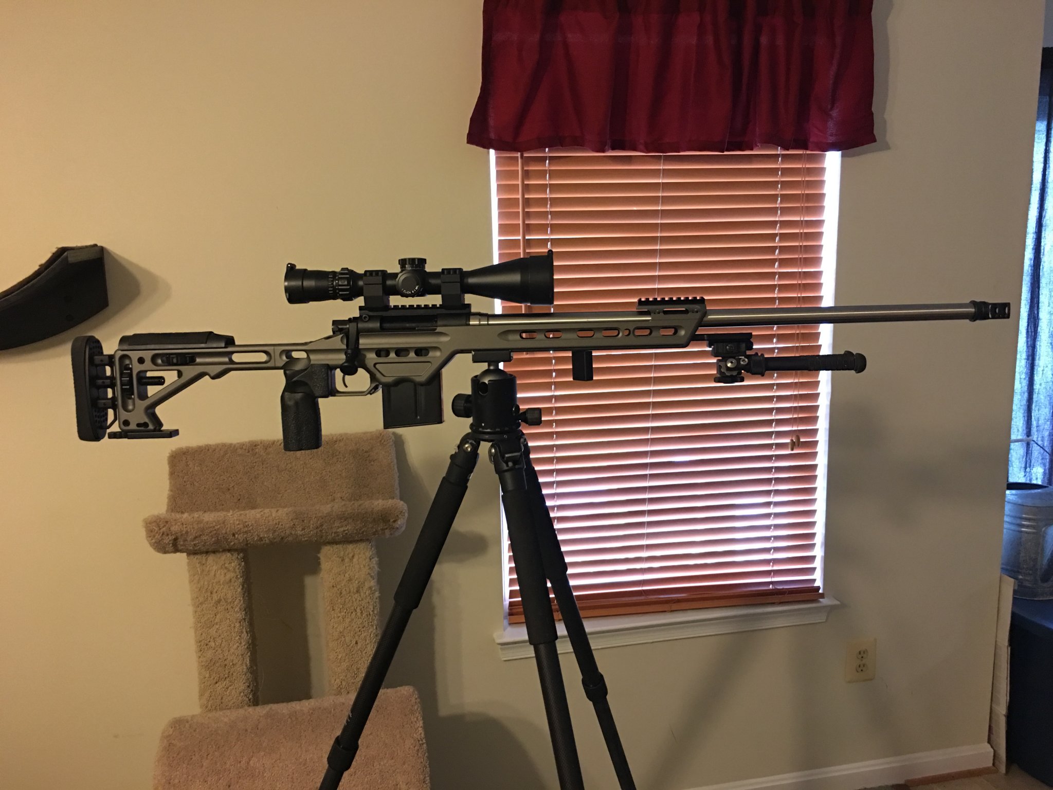

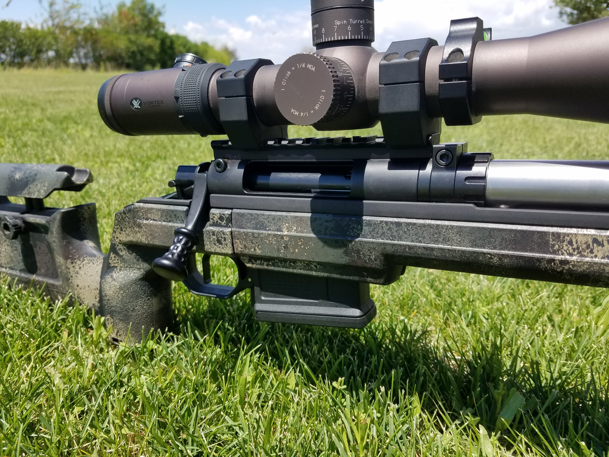

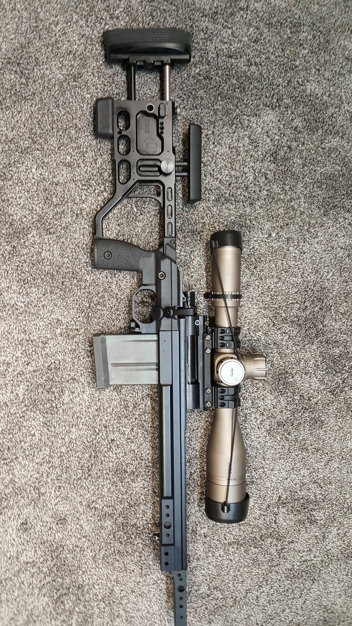

    ARC Nucleus, right hand short action, 0.475 bolt face, 20moa rail
    KRG Bravo
    X-Caliber 26" Savage bull contour 6.5 Creedmoor
    TriggerTech Diamond
    Vortex PST Gen II 5-25x50 EBR-2C MOA
    Waiting on a BarLoc
    Using a load worked up for my Savage 10 factory rifle:
