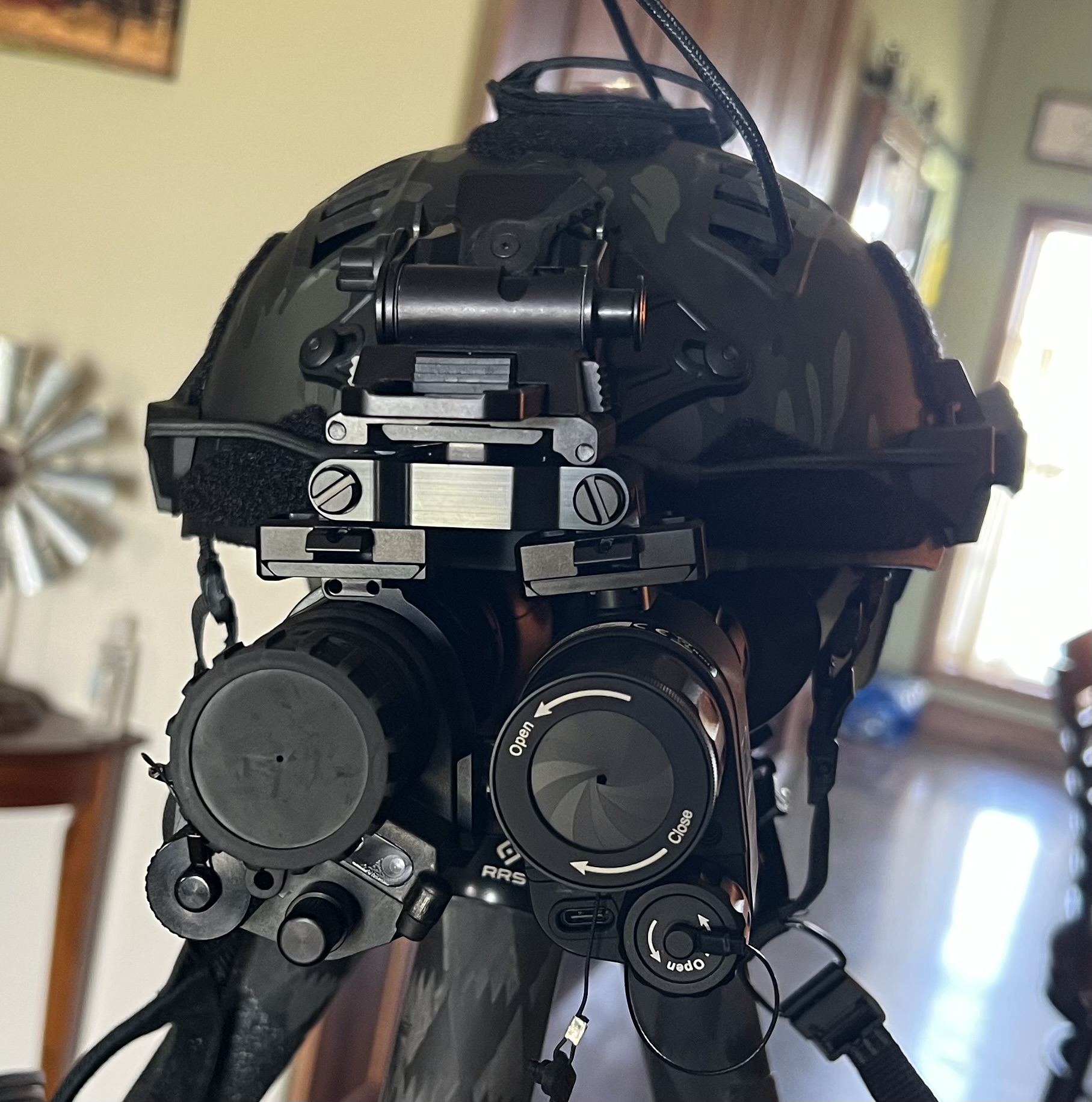

    I'm running a 14 on the right side and a IRay MH25 on the left. Then have dedicated thermal on rifle. I run both at the same time, both eyes open. Some can do it, some can't. There are nights where my brain will only see the dominate eye (NV) until I close it and then the non-dominate eye (Thermal) will then overlay on top of the NV. This bridge will let me move both independently and I've done that from time to time depending on the situation.
