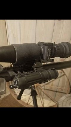

i have the pvs30 in front of a 3-12 Schmidt with a SPIR By Steiner. Its first class for taking the shot. You can go as low as 3X on the pvs30 and dont be tempted to do a 5X on your scope. You really need the FOV on the NV. I didnt find it easy acquring the target on 5x. Than again, i get opportunity at the short game and you need that FOV. One day, i will get the 3.5 -27 by SB to finish my system.
