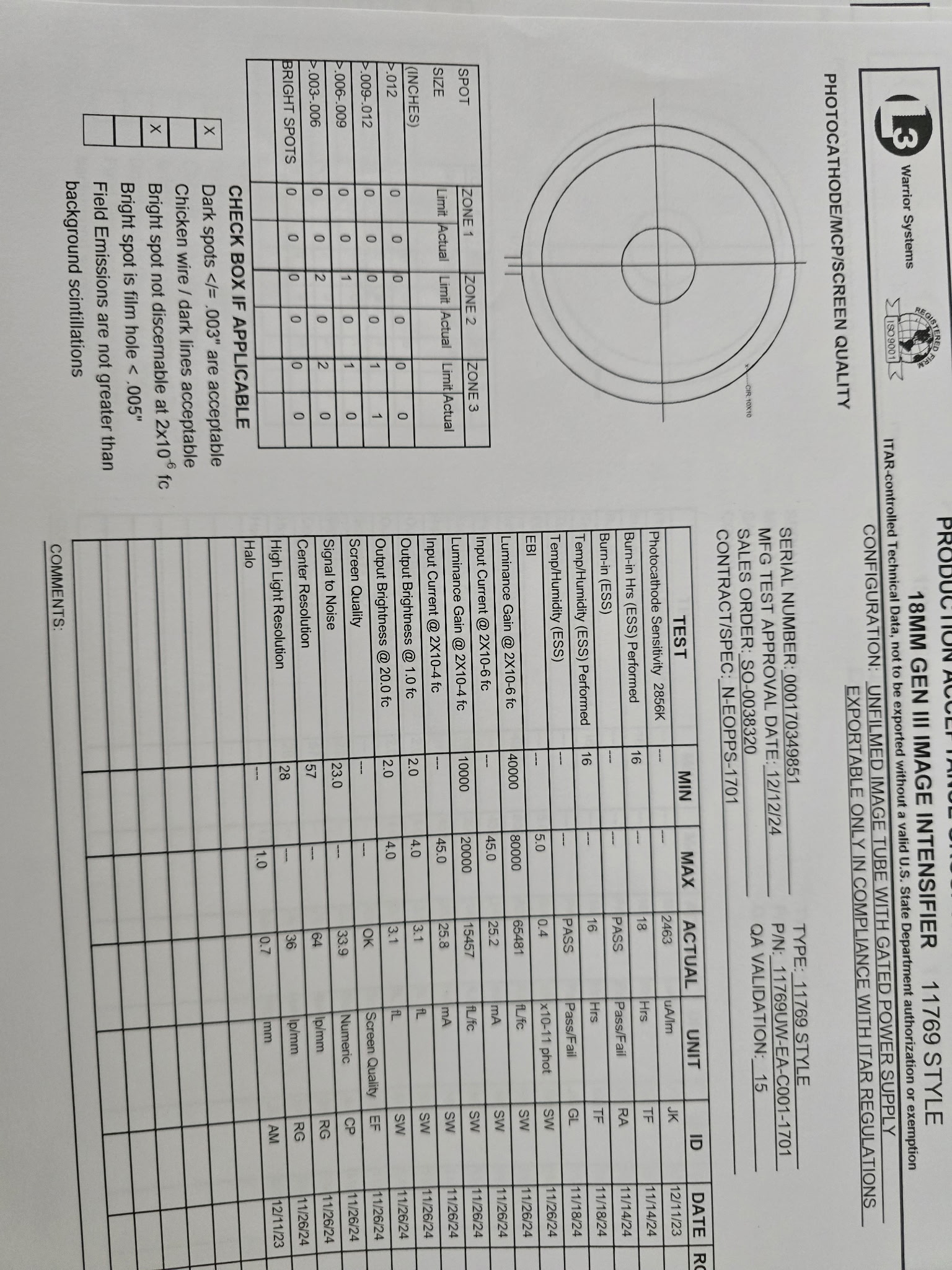

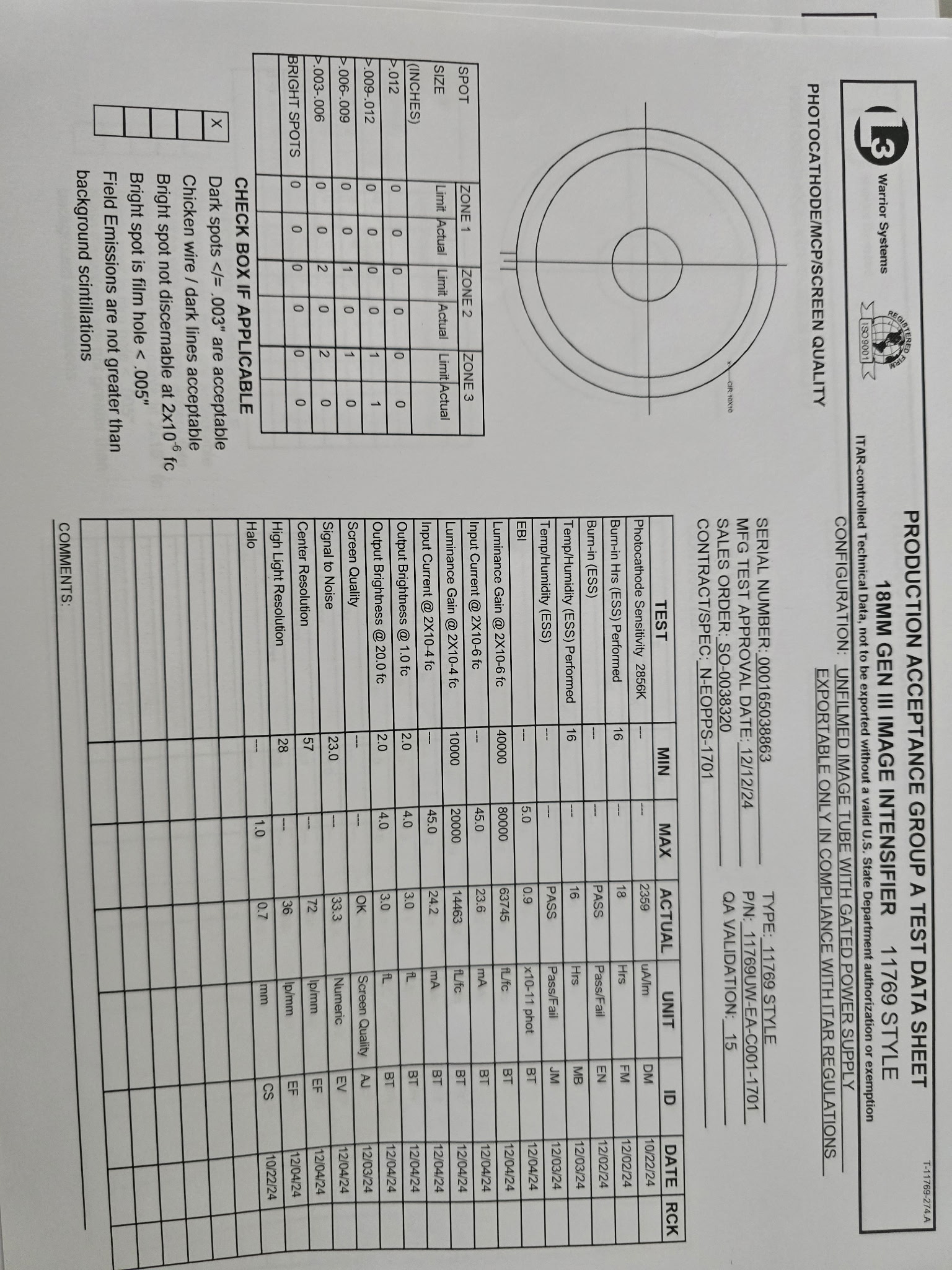

Got a dealer wanting to trade me a new pair of these for a higher dollar rifle I have . What is market value for a set like this?
signal to noise is 33.9 and center res. 64 sensitivity is 2400 . Didn’t have FOM listed.
NVG alpha housing, carson glass.
Thanks in advance.

FOM is just SNR multiplied by resolution, so in your case 2397/2169. Personally I wouldn't want mismatched resolution binos unless both tubes were above 72, however if you don't have good vision you may or may not notice the difference with a 64/72. I have 20/20 and I can easily tell the difference between a 72 and a 64, but some people claim to not be able to see the difference. Everything else looks fine.
