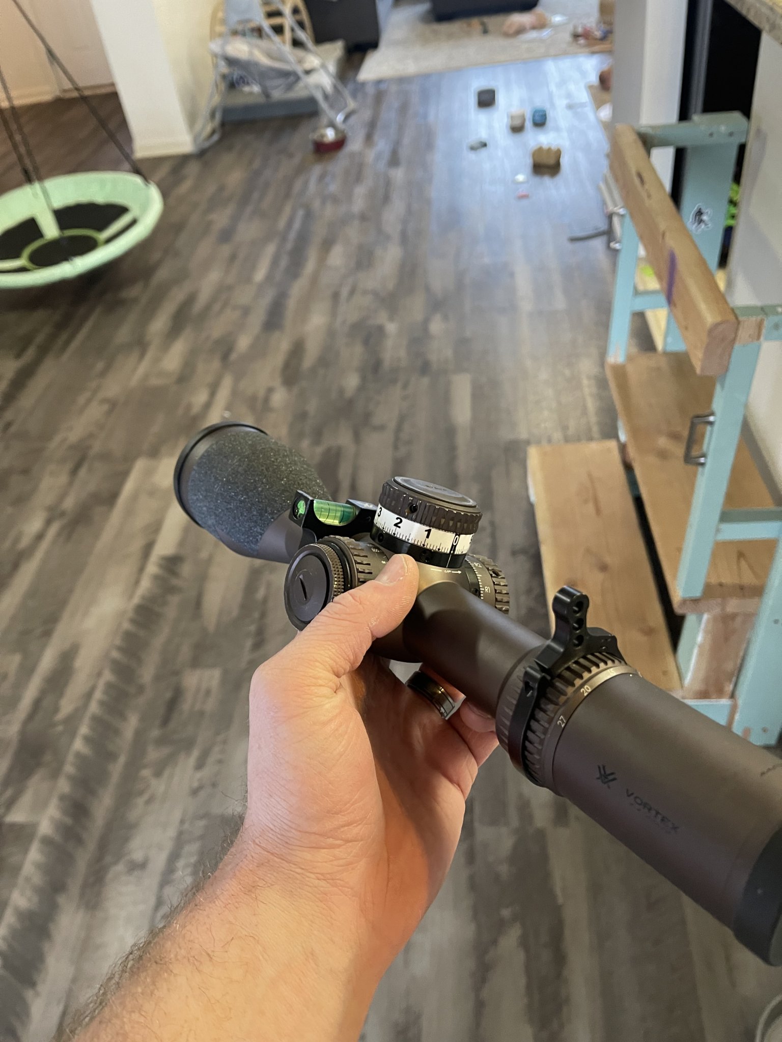

Currently I have a vortex viper pst gen 2 5-25 and I have an Arken EP 7-35 gen 2.
Personally the glass in the 2 above optics to my eye are just fine.

Ended up snagging a razor instead
