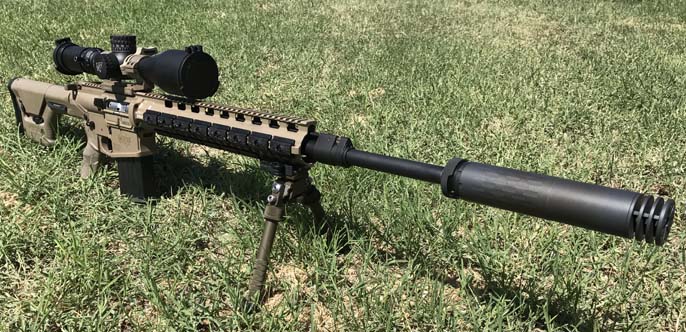

This is what in referring to:
Yep. That’s it. ASR mount/brake on the barrel and brake on the can. Love that setup on everything else and they are a bargain for prices listed at the moment. The OBR just doesn’t like the back pressure from the Omega 300. The filth after a couple mags was surprising too. One mag was so dirty I had to bust it apart and clean it bc the follower would stick after 20 rounds.

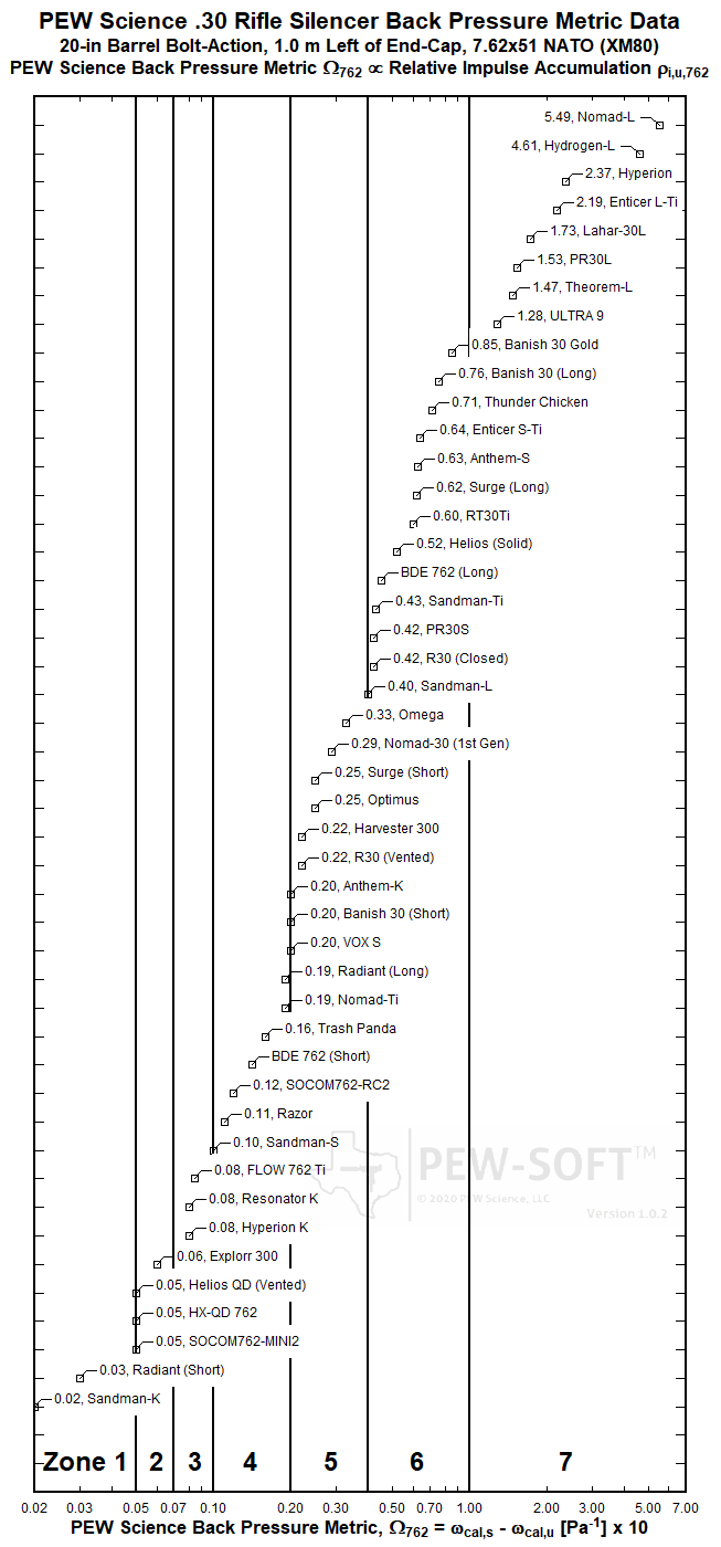

I can't imagine it has more back pressure than a tbac Dominus? Isn't there a backpressure chart some place.
The ultra 9 has more back pressure than the Omega, so I am betting the spring and buffer, using the LaRue suppressed setting should be fine.

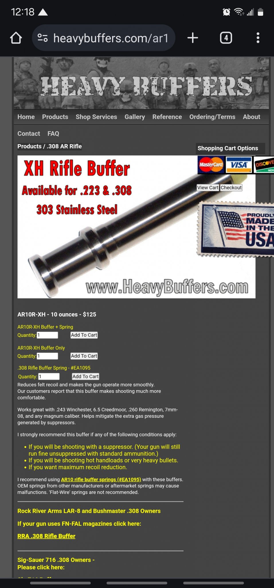

Wanted to have a solid range report on the heavybuffers 10oz today. Put it together at the range and the bolt bottomed short of cycling a round which only means one thing... I missed a carbine spacer in the tube. I had to get home and under some shop lights to see the spacer despite looking in in the rifle buffer as it came from Larue - with an a2 stock on the rifle. I’ll give them credit for manufacturing tolerances. The spacer has an o ring and is crazy tight to the tube. Took a bit to get it all out, get the heavy buffer in, and not booger anything up. A little hurt pride but tomorrow’s another day.
What spring are you using?
Just a heads up. You can not use the spring in the gun with the heavy buffer.
Is this the buffer you purchased? Did you purchase the spring listed with the buffer? If not you will have additional issues.
Yep. I got the new spring with the buffer in the screenshot

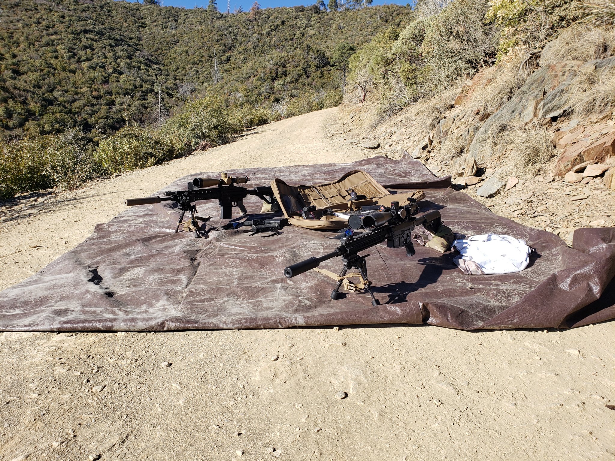

View attachment 8346663Stopped at a shop yesterday just to check out a bunch of different cans. The commonality between the sure fire and Larue cans seems that they create much less back pressure than most other suppressors. Also noticeable that cans specifically made for duty use have some type of front venting ability.

The Mini shows pretty low on that list as far as back pressure, I think its the only reason it was functioning(stock spring and buffer).

It's been a long time since I used the Omega. It is gassy on any rifle. Less back pressure with the Larue can for sure. My rifle seems to build up carbon on the muzzle device pretty bad with the Larue can. Can't remember if it was the same with the Omega or not but I suspect it was. Maybe something to do with my loads? Don't much care as it doesn't cause issues and it shoots well.

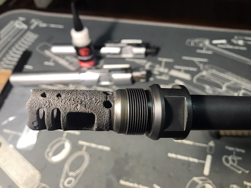

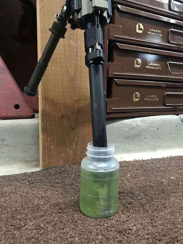

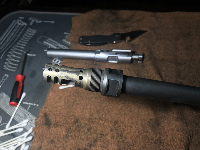

I soak the muzzle device in CLR and it nearly wipes clean. Just had to take the PST apart as it was nearly plugged solid with carbon and was causing cycling issues. That was a 1st for me.
Attached photo's were taken in 2018. I just cleaned it again a couple weeks ago along with the PST.
