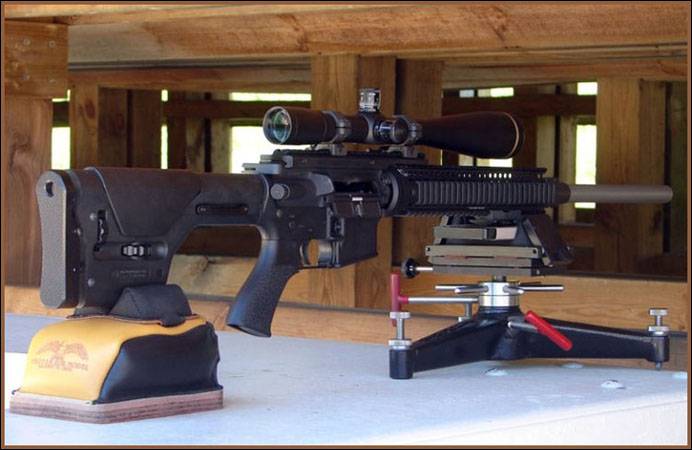

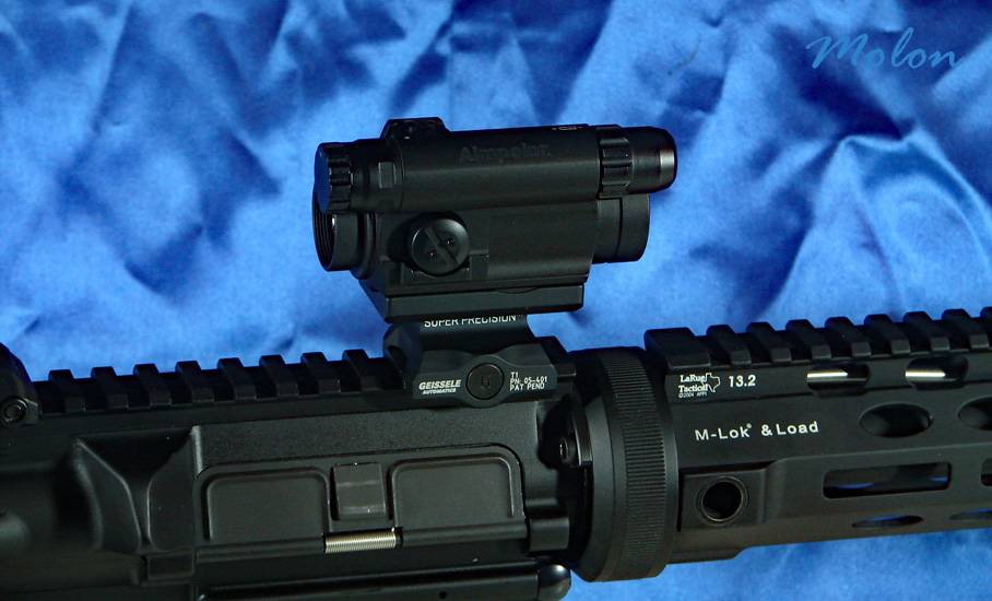

All shooting for this exercise was conducted from my bench-rest set-up using one of my precision AR-15s. This AR-15 has a 20” Lothar Walther barrel with a 223 Wylde chamber and 1:8” twist and it routinely produces 0.75 MOA 10-shot groups at 100 yards (with a high magnification scope). The ammunition used for this exercise was one of my match-grade hand-loads topped with the Sierra 52 grain MatchKing. Wind conditions on the range were monitored using a Wind Probe. The set-up was very similar to that pictured below.

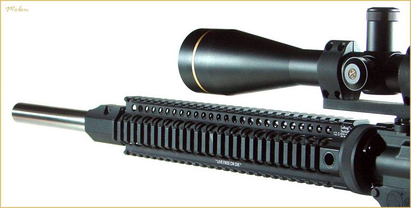

The barrel . . .

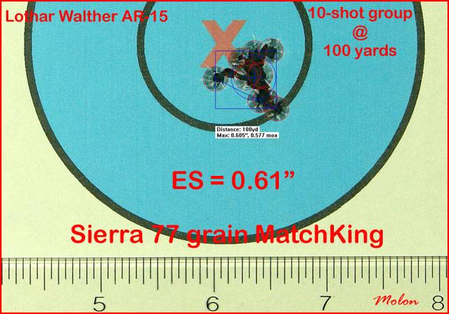

10-shot group at 100 yards . . .

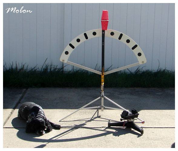

The Wind Probe . . .

Shooting from the bench-rest set-up with the Aimpoint Comp M5 atop the precision AR-15 at the initial distance of 7 yards, an 8-shot control group was fired with the red-dot centered in the sight window. Next, an 8-shot parallax test-group was fired in the following manner:

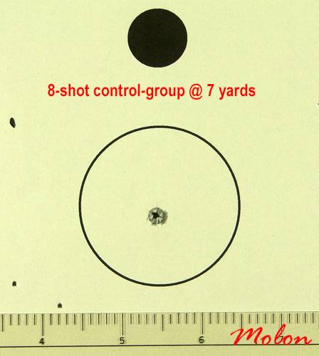

The 8-shot control group at 7 yards . . .

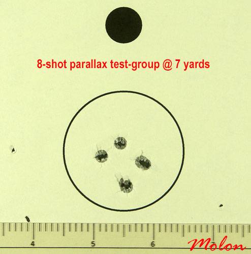

The 8-shot parallax test-group at 7 yards . . .

The 8-shot control group fired at 7 yards had an extreme spread of 0.039”, which at 7 yards is 0.53 MOA. The extreme spreads of the parallax test-groups are shown in the table below.

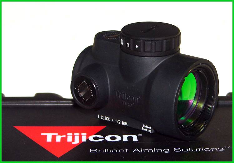

I repeated the ballistic exercise described above using a 2nd-generation Trijicon MRO with a 2 MOA red-dot. The results are shown in the table below.
I also conducted the 50 yard portion of the parallax test using another 2nd-generation Trijicon MRO with a 2 MOA red-dot. The results were nearly identical to that of the first MRO. The extreme spread of the 8-shot parallax test-group was 7.46”, which at 50 yards is 14.3 MOA.

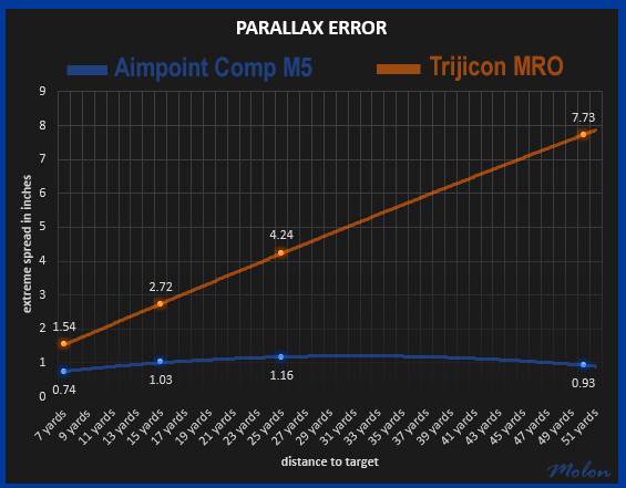

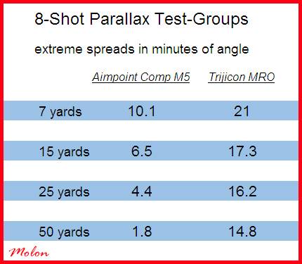

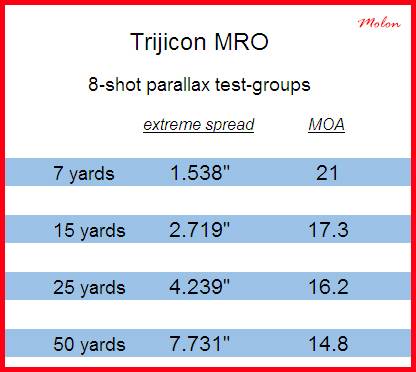

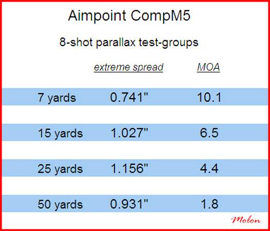

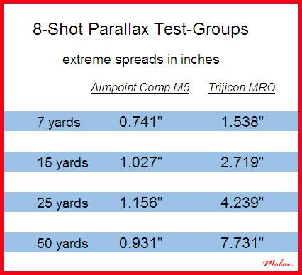

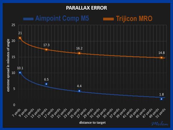

The tables and graphs below show the results from both the Aimpoint Comp M5 and the Trijicon MRO, side-by-side, for comparison.
Results in minutes of angle . . .
Results in inches . . .

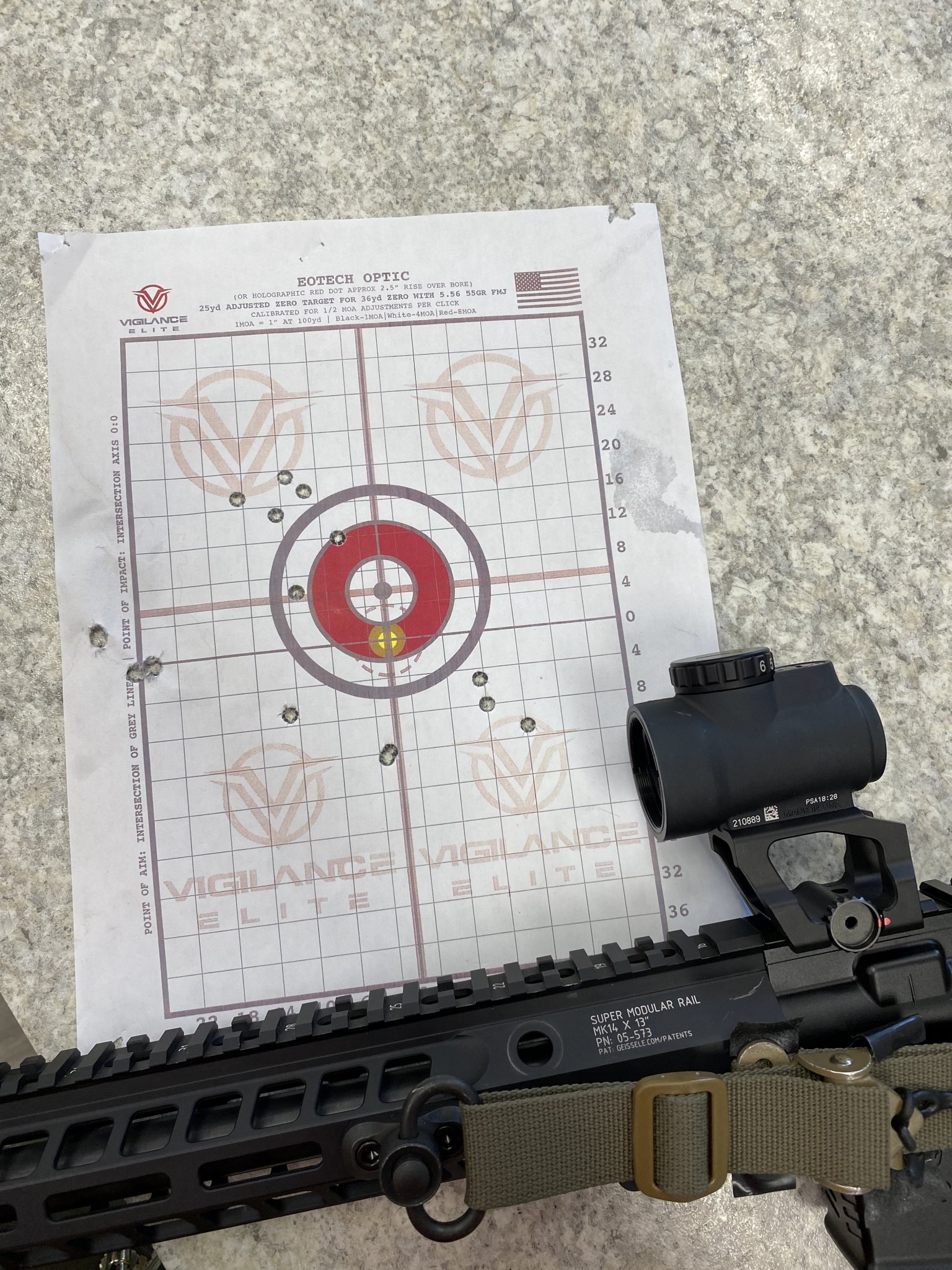

This thread is extremely intriguing to me. I went from an LPVO to the MRO with very high hopes. I went with the regular version, post 200k serial number. Scalarworks 1.93” mount. Went to zero it today with some range ammo and I could not get it to be consistent whatsoever like I’ve been able to with any other dot I’ve shot with (Eotech, Vortex, Sig, Holosun). I was shooting at 25 yards on a 36/300 simulated target. Rifle was bench rested, dot dead center, trigger squeeze was smooth, and the shots felt very good. I am very disappointed to say the least. I only made one adjustment at a time in between groups, like windage only or elevation only. First group is far left. Second is low right quadrant. Third upper left. 4th is low left. 5th is back up in upper left.
  • Wow
Reactions: Naaman
This thread is extremely intriguing to me. I went from an LPVO to the MRO with very high hopes. I went with the regular version, post 200k serial number. Scalarworks 1.93” mount. Went to zero it today with some range ammo and I could not get it to be consistent whatsoever like I’ve been able to with any other dot I’ve shot with (Eotech, Vortex, Sig, Holosun). I was shooting at 25 yards on a 36/300 simulated target. Rifle was bench rested, dot dead center, trigger squeeze was smooth, and the shots felt very good. I am very disappointedView attachment 7641733 to say the least.
This is from 25 yards?
How much adjustment did you dial in? Were you having trouble with the adjustments or is this all on the same setting?
My first inclination is to check the mount-to-optic and mount-to-rifle fit. My first time out zeroing a red dot (not saying it's your first time), I hadn't torqued down the mount all the way to the rifle and it was bobbing around during recoil. Didn't even realize it till I got home and had to go back out and re-zero it.
All from 25 yards. I checked the mount and optic to mount, no movement at all. When everything was initially mounted, very was torqued to manufactures spec. Came home and rechecked torque and nothing changed.
Adjustments were per the target, but I only made adjustments to the elevation or the windage each time. Never both the elevation and windage in one adjustment. That’s why I’m so lost as to why each group was off in both directions.
That's really a bummer.
I have zeroed a total of 4 MROs in my shooting life. Ranging in serial number from the low 80k range up to 155k, plus an MRO HD. I have not seen anything like this.
At this point, if it were me, I'd ask a buddy to try it out just to rule out some mistake I might be making. Other than that, I'd contact Trijicon and ask them to help me troubleshoot it short of sending it back to them for evaluation.
Reactions: drewthebrave
Update on my situation in case anyone was curious.
I had a coworker try and zero it. Very similar results. Shot 3 round groups. Adjusted one thing at a time. Same inconsistency. I returned the optic.
