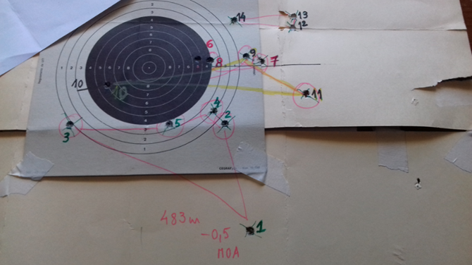

Distance to target 528 yards
7076998
7077000
7077001

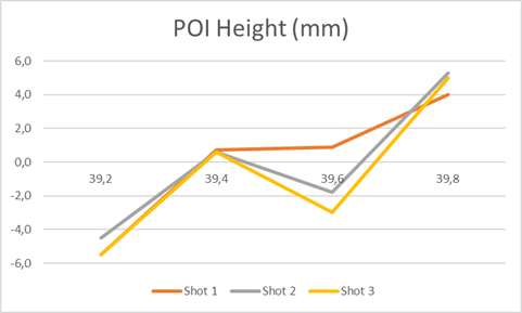

first shots #1 to 5 with 39.2 grain
shots #6, 7 & 8 with 39.4 grain
Shots # 9, 10, & 11 with 39.6 grain
shots # 12, 13 & 14 with 39.8 grain

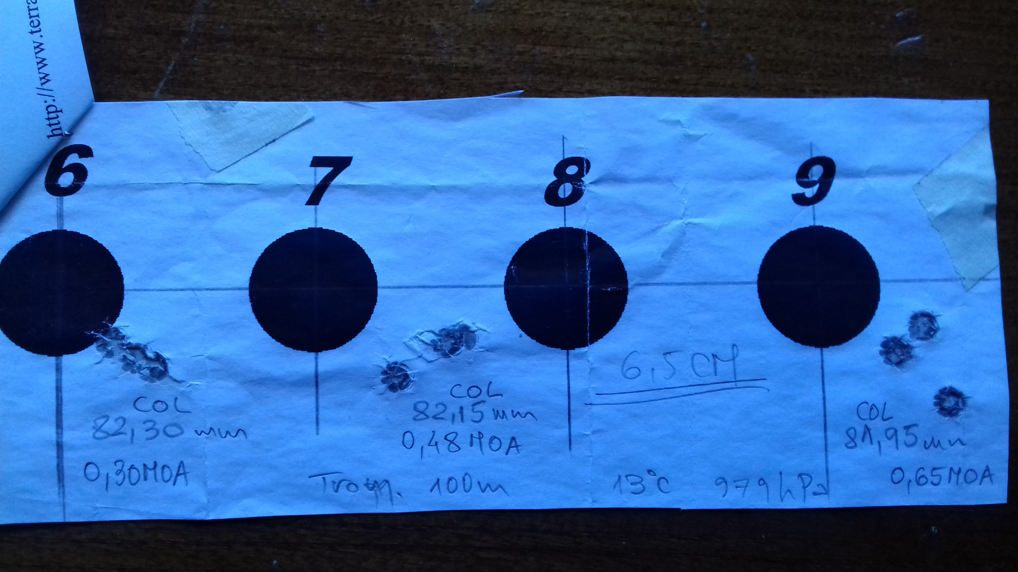

After this tested for COL
Charge of 39.4 grain
3 shots each COL: Maximum for magazine / .010" less / .020" less
Distance to target 109 yards
7077005
Any comments are appreciated.
What made you choose such a narrow window at such a low charge weight in the first place?
To get reliable data from an ocw you need a wider spectrum of data points. Right now with this info you’re trying to navigate with a hood pulled over your eyes.
Reactions: CarlM and Paqueo
Trying to develop the load at 500yds is not going to be reliable. Too many variables come into play. Also your charge weights should span at more than 3% as nodes tend to be ~3% apart. Do your load development and seating depth at 109yds. Once you have that tight then verify by taking it out further.
Also, it appears to me that your moa is incorrect on 109 yd targets.
Reactions: Paqueo
You are right. This wasn't the only test I did. Just posted this last one but will publish more info I got from previous tests
MOA is correct. Image is zoomed. Will post previous test. Thanks

The guy near the target to take note of impacts got a bit confused and we had a few doubts. Anyway, below a photo of target with the groups signed with different colors.
When I did this test @ 400 meter hadn't studied properly the all data of the first test, as I did above, and probably just searched for higher velocity instead of searching in the best window.

I’d explore 39.0-39.5
Thanks!
